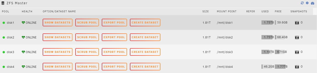

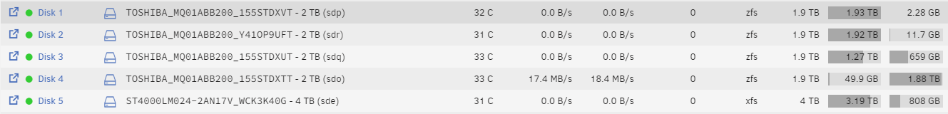

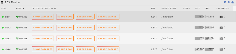

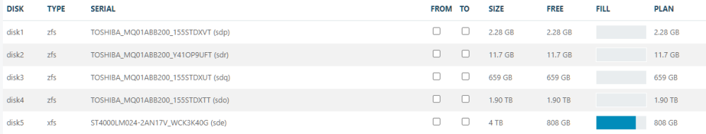

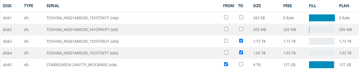

unBALANCE is unable to read the size of a zfs-formated disk correctly. As soon as there is some data filled onto the zfs formated disk, it just shows the remaining free space as "size":
what is actual free space on these disks (i understand you're referring to disk 1 and 2 ) ?
Free Space calculation is fine as far as i can see. It's just the total size that's wrong.
Updated screenshots, unRAID and ZFS-Master as comparison:
Edited by madejackson

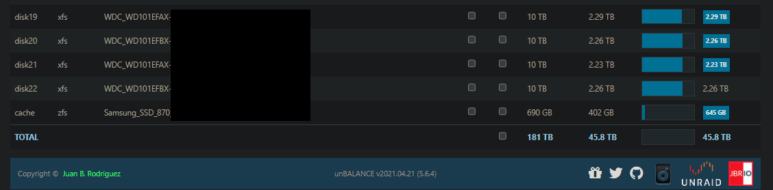

Hello @jbrodriguez
love the unbalance plugin however I am seeing one issue
one of my cache pools is now showing up
I have 2 party, 22 array  disks, 1 ZFS pool with two 1TB SSD's and the pool not showing is a second ZFS pool with two 4TB spinners in ZFS it is also reading the size of the ZFS SSD's incorrectly as 690GB in size
the pool is called download-cache so not sure if there is a character limit for it to display or what the issues is and wondering if you could take a look
Edited by Can0n

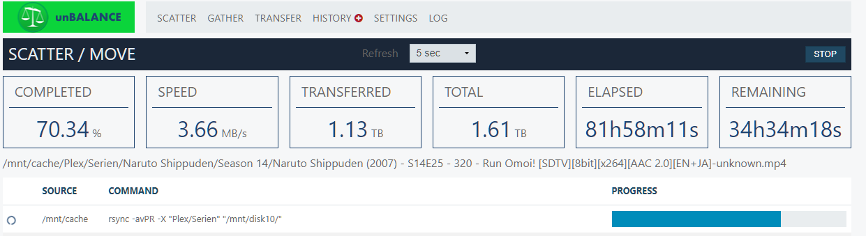

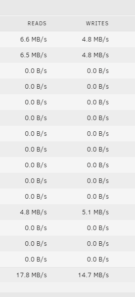

I'm on 6.12.2 now and suddenly have some very slow speeds (<4MB/s), when trying to copy from btrfs pool to my newly zfs formatted array disk. I am 100% sure that nothing else is accessing my disks (fresh reboot, docker+VM stopped). Any Idea what this could be?
In the last couple of transfers on 6.12.1 from xfs disk to zfs disk I usually got 20-30MB/s.
Speed Fluctuate a bit. Sometimes it goes up to 25MB/s for a short time only for then to fall back down to 3MB/s, grinding to a complete halt and then speed up again. The Files are regular sized MP4's and maybe some .srt subtitels. There are no errors in the logs. Diskspeed lists the speed of this particular WD disk at about 90-150MB/s
unbalance.log
