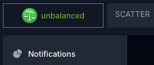

    ✭ unBALANCE is now unbalanced !! ✭     NOTE: To install it, look for "unbalanced" in Community Apps (the old unbalance plugin will be deprecated by Squid)   i had the op

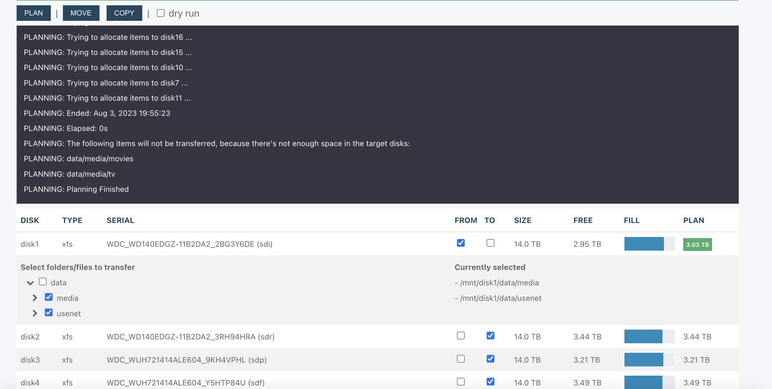

6 hours ago, MAM59 said:
Nono, you got me wrong.
The setting I have in mind forbids the spreading up to a certain level of subfolders. You have to turn it off allowing the plugin to spread any level below data.
The default is to keep folders together.
Oh, I see Where is this setting? I don't see anything in the plugin itself. Every directory it says is too big
Edited by FlyingTexan
Ok so I managed to get it to pass the PLAN phase without having any errors. I had to go down several directories. /data wouldn't work but /data/media/movies would.  My guess is because of how it structures it. It could then take the file sizes of each movie and put it in the appropriate directories (I'm hoping).  This seems a bit of an oversight but glad it's at least something that can still work.
I just installed it again (could not look for the setting before). It seems I was wrong, there is no actual setting, seems to be a builtin feature.
But you already found the "full control manual" solution, select only a subfolder that is acceptable for plan, do move and then create a new plan with different subfolders and different target drives.
Those days I thought it was a bug that unbalance has split the folders among several targets (I had only selected ONE drive but the plan filled up TWO).
I've ended up thinking the file list (actually the folder list) became too long for the script to be handled, so I copied fewer folders in several sessions.
Question on data moving, I am in the process of converting to ifs so I was hoping to use unbalance as my method. However, whenever I try moving data from Drive A to Drive B-H (for example) it complains I do not have enough space to do it.
Drive A is 14TB and I have for example 15.5TB free on my server (started with around 20TB). I get the following "error" (yes its not an error):
PLANNING: Planning started
PLANNING: Scanning data/media on /mnt/disk5
PLANNING: Checking issues ...
PLANNING: Getting items ...
PLANNING: Found /mnt/disk5/data/media/tv (1.57 TB)
PLANNING: Found /mnt/disk5/data/media/movies (5.77 TB)
PLANNING: Found /mnt/disk5/data/media/movies-4k (6.00 B)
PLANNING: Found /mnt/disk5/data/media/tv-kids (32.12 GB)
PLANNING: Found /mnt/disk5/data/media/music (6.00 B)
PLANNING: Trying to allocate items to disk12 ...
PLANNING: Trying to allocate items to disk11 ...
PLANNING: Trying to allocate items to disk2 ...
PLANNING: Trying to allocate items to disk8 ...
PLANNING: Trying to allocate items to disk3 ...
PLANNING: Trying to allocate items to disk6 ...
PLANNING: Trying to allocate items to disk4 ...
PLANNING: Trying to allocate items to disk7 ...
PLANNING: Trying to allocate items to disk14 ...
PLANNING: Trying to allocate items to disk10 ...
PLANNING: Trying to allocate items to disk9 ...
PLANNING: Trying to allocate items to disk13 ...
PLANNING: Trying to allocate items to disk1 ...
PLANNING: Ended: Aug 14, 2023 11:51:22
PLANNING: Elapsed: 0s
PLANNING: The following items will not be transferred, because there's not enough space in the target disks:
PLANNING: data/media/movies
PLANNING: data/media/tv
PLANNING: Planning Finished
Do I have something in my share or drive settings causing it not to allow my current drives to accept files, like a threshold of sorts? I did try adjusting the share minimum free space to no avail. Each drive has between 400GB and 2TB free. Also, the unbalance app limit is set to 512MB.

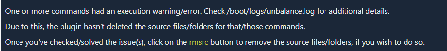

Hello,
I was using Gather to move stuff from an older 3TB (disk 4) drive onto my new 14TB (disk 1) drive. I did the dry run and had green checkmarks for all the files and folders. Once I did the actual run, I had yellow checkmarks for some items. When the run completed, I got this:
So I went to go look at the files in "/mnt/disk 4" they aren't there anymore
Where did the files go and what can I do to prevent this from happening again?

19 hours ago, LanceM26 said:
Hello,
yes, that's strange, when you get that warning unbalance specifically didn't remove source files/folder.
did you run back to back operations ?
do the logs show anything unusual ?
