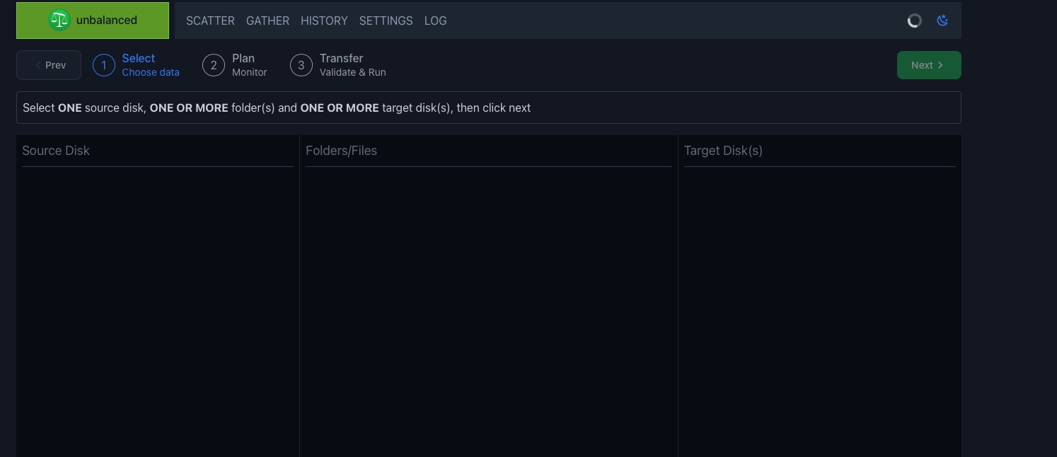

10 hours ago, Seven7527 said:
but when I go to the Web UI I can't click on anything. and there is a spinning circle in the top right corner
mmm that seems to be a bug, can you do a t
tail -f /var/log/unbalanced.log
if that doesn't show anything do a
cat /var/log/unbalanced.log
it does seem to be running but for some reason, the ui isn't picking up notices about current state of the transfer
Transferred 0B at ~ 0.00 MB/s
2024/04/04 20:20:59 Unable to write history: json: unsupported value: NaN
2024/04/04 20:27:29 unable to read websocket message: websocket: close 1001 (going away)
2024/04/04 20:29:55 unable to read websocket message: websocket: close 1001 (going away)
2024/04/04 20:37:14 unable to read websocket message: websocket: close 1001 (going away)
2024/04/04 20:45:38 unable to read websocket message: websocket: close 1001 (going away)
2024/04/04 20:51:53 unable to read websocket message: websocket: close 1001 (going away)
2024/04/04 21:03:25 unable to read websocket message: websocket: close 1001 (going away)
2024/04/04 21:48:25 unable to read websocket message: websocket: close 1001 (going away)

37 minutes ago, Seven7527 said:
2024/04/04 20:20:51 scanning:disk(/mnt/disk1):folder(Movies/Music)
2024/04/04 20:20:51 issues:not-available:(stat /mnt/disk1/Movies/Music: no such file or directory)
2024/04/04 20:20:51 items:not-available:(stat /mnt/disk1/Movies/Music: no such file or directory)
there's something odd about your data, these folders can't be found by the operating system, when issuing a stat command 🤷‍♂️
if you run the following on the command line, does it work ?
but that's not the "it hangs spinning" problem, i think
this isn't good, it means some value can't get converted to json format, i wonder if some size is getting misread by the os (given the os error above), this is what's probably causing the ui to hang, but can't tell for sure
is that a healthy drive or it has some issues ?
in any case, there's no data transfer happening, it's always coming up with "zero" bytes to transfer,
this is what happen
stat: cannot statx '/mnt/disk1/Movies/Music': No such file or directory
oh nope showed be this  stat /mnt/disk1/Media/Music
this is what I get
