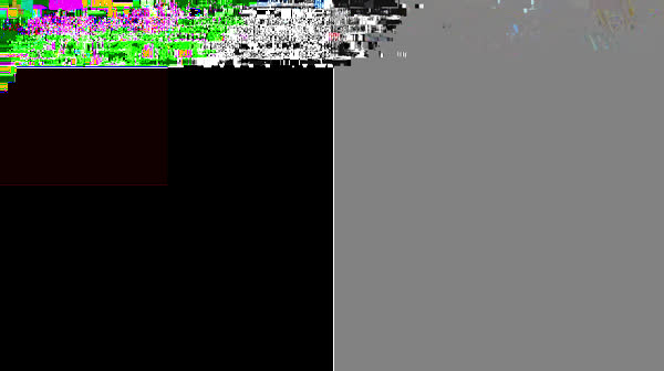

Anybody here familiar on how to prevent thumbnails from being generated incorrectly for certain video codecs?
Video
Codec H264
AVC Yes
Profile High 4:4:4 Predictive
Level 50
Resolution 1280x720
Pixel format yuv444p10le
Edited by ken-ji

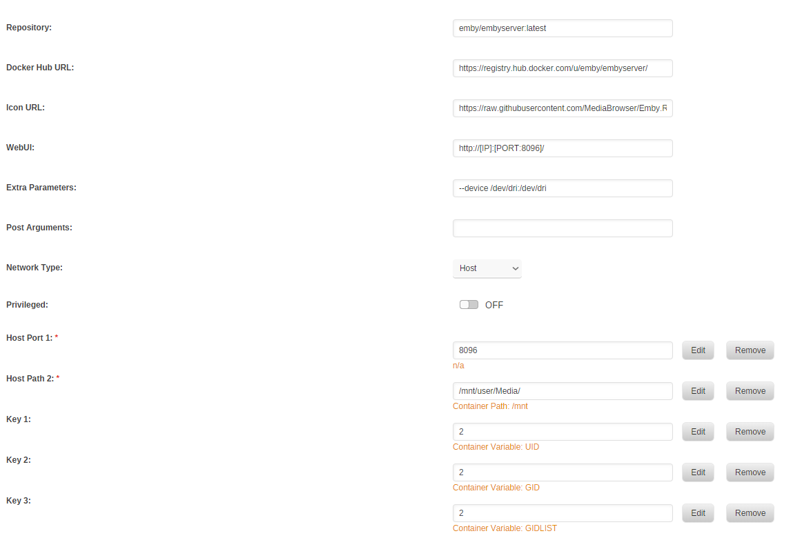

    may start like this   change UID > 99 GID > 100 remove GIDLIST <<<< delete this entry   check /mnt > edit > check if its read / wri

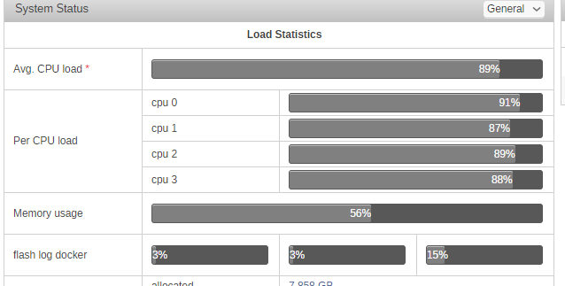

I was having issues with emby locking up.  I would restart the docker and restart kodi on all attached boxes, and within a day it would lock, not sure what was triggering it.
I tried to completely delete the docker image file and the folder as well as blown out emby on both Kodi boxes and redid everything.  5 hours after it finished updating, it locked.

What is 'GIDLIST' in the container template? and ehat should it be set to?
Should the UID be 99 and the GID be 100 ?
The defaults used on this template seem to be different to other unRAID templates.
GID_LIST is other group (ids) that the running emby process will be a member of, so its used to grant additional access to iGPU for transcoding, and maybe the DVB tuners (if your using the DVB build) without having to muck with the device node permissions and ownership.
The reason is that the docker image itself is a general use image, it's not specifically for unRAID, so the template has to provide some overrides and the defaults might not make sense.

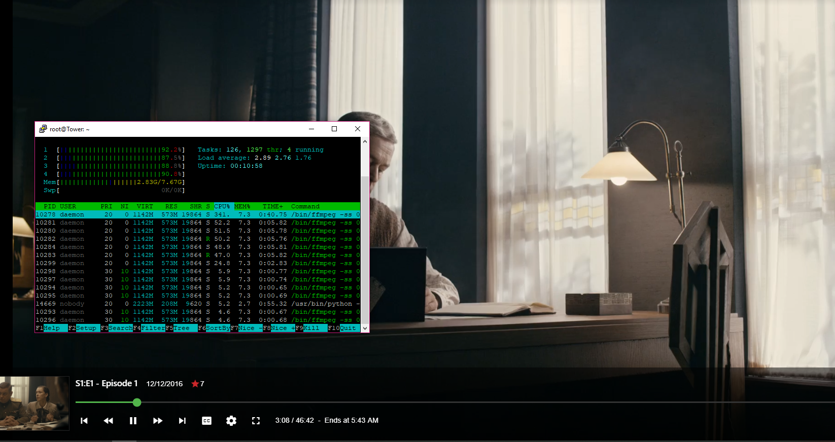

@vanes, hi. Can I ask how you got hardware transcoding working?
Are you using official embyserver docker?
I have a working embyserver, and can stream from it. What I don’t have at this time is hardware transcoding.  What steps did you take to get it working?
What needs Ed’s to be in the go file?
Where do I put —device /dev/dri/renderD128? Putting it in extra parameters gives me errors.
I already selected va api in embyserver transcoding settings. I also see va api device as /dev/dri/renderD128 already.
Yes
my go file is:
#!/bin/bash
#enable module for iGPU and perms for the render device
modprobe i915
chmod -R 777 /dev/dri
# Start the Management Utility
/usr/local/sbin/emhttp &
container Extra-Parameters:
@vanes, did them both.  Still getting the following:
I followed your go file.  Is it the file in flash/config/go?  Modified it using notepad.
@jang430 try htop in terminal
Edited by vanes
this is my screenshot
take a look at this. double check all bios settings, nomodeset , go file, etc
noted, will try vanes.  What does he mean by  having trouble to get /dev/dri to show up?  I don't know whether mine is considered as showing up currently, or not yet.  How do I check this?
@jang430 open terminal, type mc, th en go to /dev/dri folder. U see renderd128 ?
Edited by vanes
yes, I see it.
@vanes, thank you!  The setting in the bios did it.
