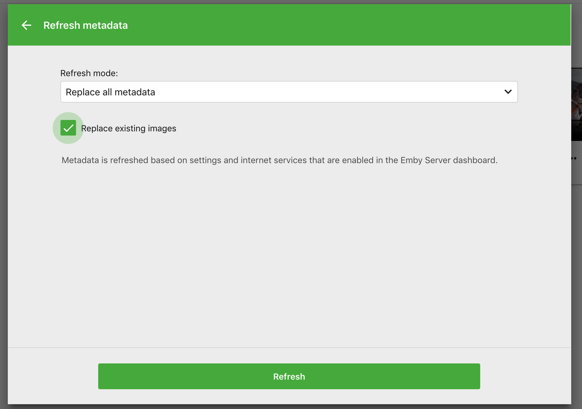

I am Premiere Lifetime Member and I went into Emby Version 4.0.2.0 and went into Movies in my web browser.  In looking at the list of movies I had seen a lot of cover art was not showing up for some reason.  So I went back one screen and I clicked on the 3 dots and selected Refresh Metadata and selected to REPLACE ALL METADATA and checked the box to Replace all the Images. At that point it just went through and deleted everything!  GONE!  Nothing!  All deleted!
Posted on the Emby site about this and this was the reply...
"Ok it looks like you did actually use the delete media function, and for whatever reason it may have gone up an extra level when deleting the movie folder. I will have to add more logging to confirm this. I believe we have noticed this issue being associated with the database upgrade from 3.5, but it does not occur on newly created libraries. It is already resolved for the next release so that it will not happen again. I apologize for the disruption.   Luke"
Over 1000 movies GONE!  Seeing that unRAID has NO WAY to recover deleted files....Emby just toasted me! (Along with unRAID not having a snapshot backup system and being just parity. I have been a unRAIND user for a very long time.  First time I lost everything.  Now I am looking for a solution that could have saved me with such a large BUG.
I am sorry to hear about this but it is not an unRAID issue. You should have backups of your data for situations like this, you cannot blame unRAID. Sure it would be nice if unRAID had snapshot capability but you are aware it does not, so you can't rely on it. I have close to 10,000 movies in my collection and I have them on two different servers and backed up to a third that I keep offline. I realize not everyone can afford to to do this, but if your data is important to you, then you have to think about a backup strategy. Perhaps it is also time to look at Plex unless you don't like it, I have been using it for years without issues.
