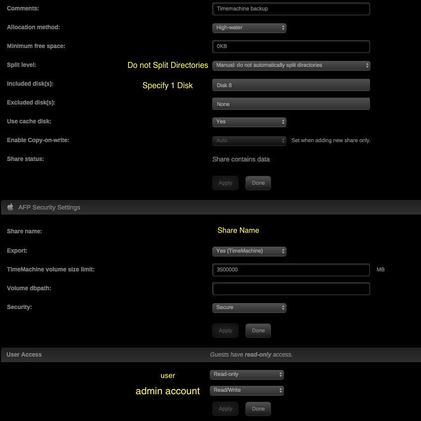

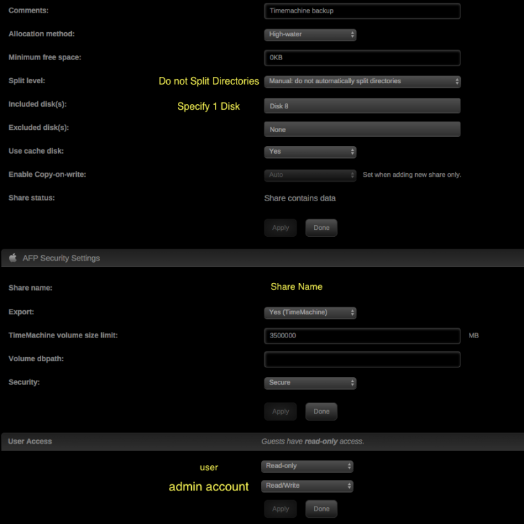

Here is what I found worked...
I tried to not use Cache and specify only one disk and used Private with same user account as my Mac. Time Machine (Using MacOS Sierra) will not connect..
attaching a screenshot (annotated and redacted) of my settings

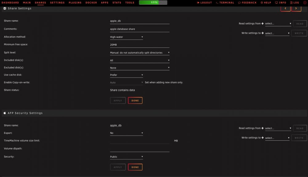

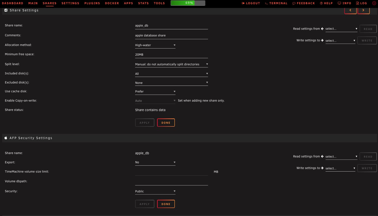

I am far from an expert, but it's my understanding that it is best to set an alternate location for Volume db path. I set up another share for this-
Edited by wgstarks
