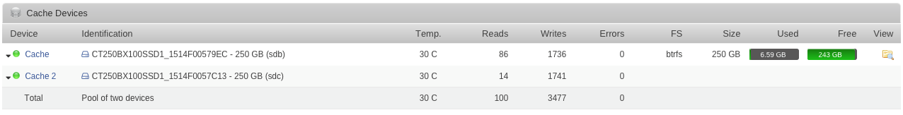

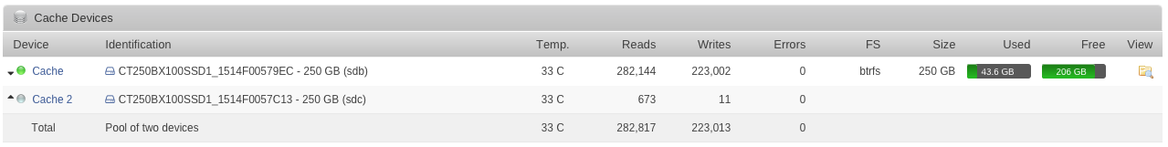

I configured a RAID1 btrfs Cache Pool yesterday for the first time using two identical SSD's. The setup seemed to go OK BUT when I woke this morning I took a glance 3 of things appear to be happening that confuse me:
1. Only Disk 1 in the Pool seems to be showing usage statistics;
2. Disk 2 in the Pool does not have any increased (or similar to Disk 2) Read/Write Statistics as Disk 1 despite having over 100GB written to the Cache Pool in the last 24 Hours;
3. Disk 2 has not "spun" up since installation.
Can anyone help me out with this, is this expected behaviour?

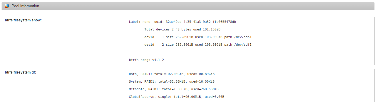

That does not look right, the number of writes should be similar, click on cache disk and post btrfs filesystem info

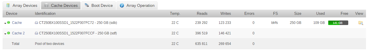

Some screenshots of my cache pool,  see attachments.
Thanks dude! Appreciate it!
Now that's more like it!! Both drives active, reasonably similar reads and writes accross both drives.

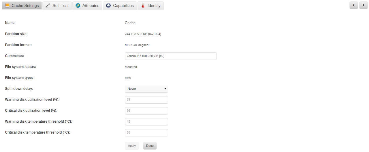

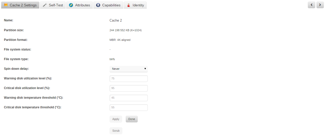

To make the pciture complete I have added the settings page of the second cache drive too (see previous post).
You can verify the settings of both cache drives, if any doubt about the file system.
