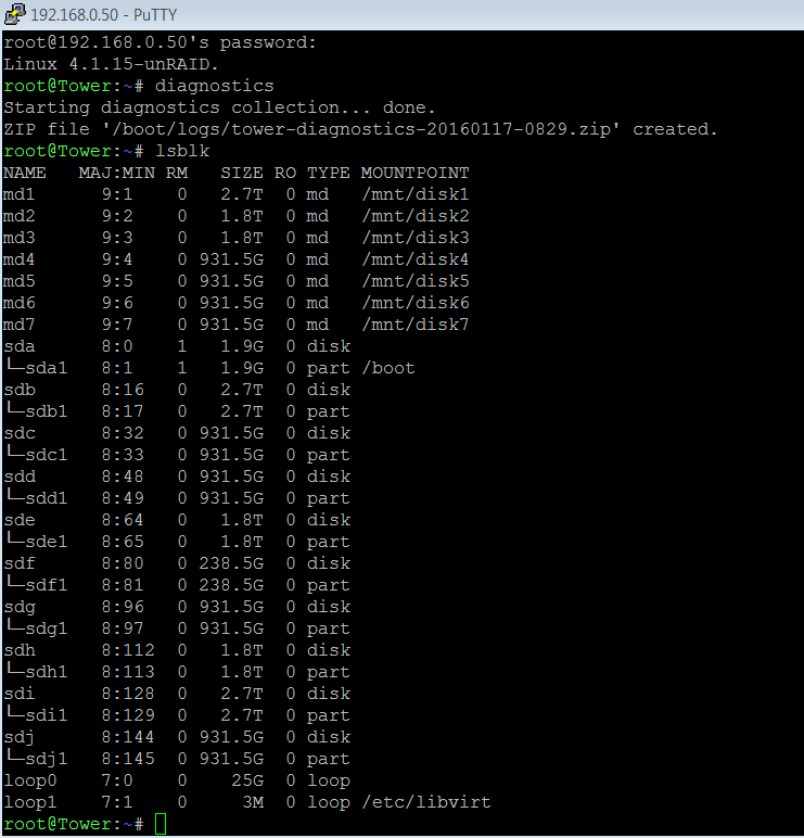

What do you get with this?
lsblk
lsblk screenshot attached.

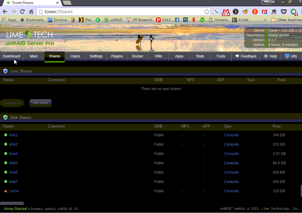

OK...check out the attached screen shot from my putty session.
I go to /mnt/user and type ls and no user shares are listed.  On a whim, I decided to change directories to one of my known user shares "Vdisks" and I get to that path and am able to list the folders.  I then tried a couple other known user shares and I am able to get to these.  Coincidently I am able to go to /mnt/user/NOTWORKING identified in my post above.
I also included a screenshot of my Unraid GUI showing that I have no user shares.
Any suggestions?  Why don't the user shares show up when I type ls -la?????

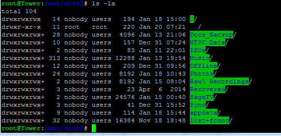

I had another thought...could this be some sort of permissions issue.  Check out the attached screenshot.  Is it normal for the double dot to be root and root.  I thought everything was supposed to be Nobody and Users.  I haven't run the New Perms utility since I converted from unraid 4.7 to version 5 several years ago...maybe I should run it again.
Yes. The double dot refers to the parent directory of where you're currently looking. In your example it is /mnt which is owned by uid root, gid root. That is correct.
However, your previous example is perplexing. You've effectively done
cd /mnt/user
ls -la
and found /mnt/user to be empty, though you were then able to
cd Vdisks
and not get an error. There's something wrong with fuse.shfs here.
If you look within /mnt/disk1, /mnt/disk2, etc I take it you can see your user shares as you allocated them but they are clearly not being combined together in /mnt/user
