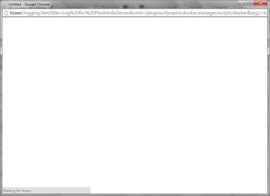

I am running VIPRE, tried disabling and same thing.
I get the pop up and it just spins and spins and spins.

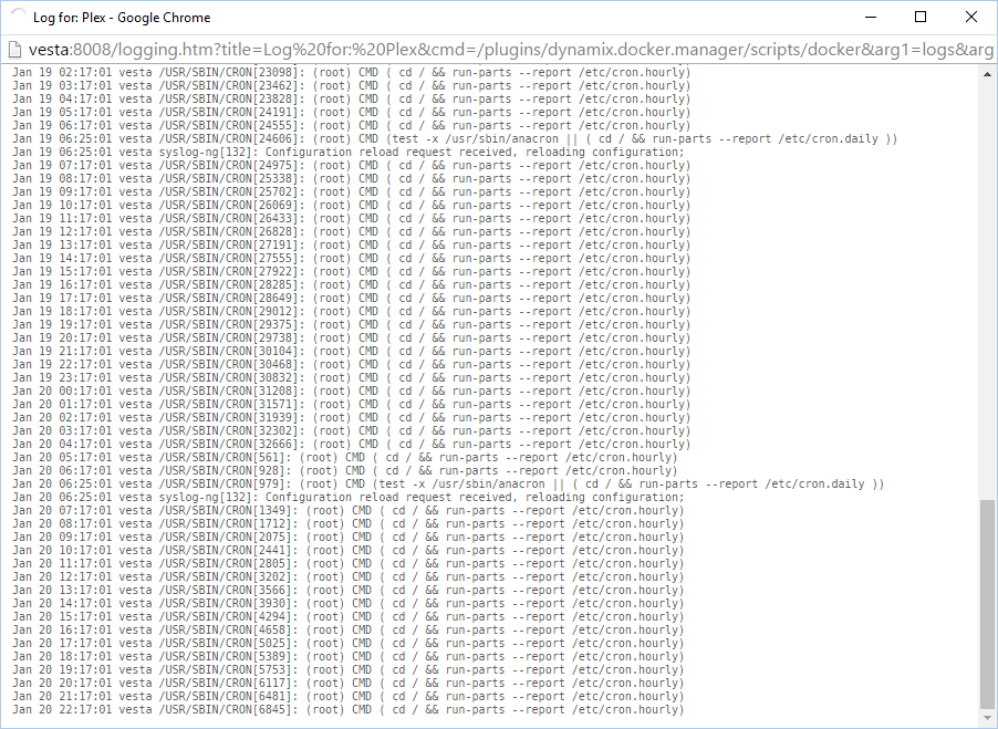

I think the browser / AntiVirus you're using doesn't handle having the stream not fully flushed out. So this is a client side issue. Try using one browser that actually works, such as Chrome, FireFox, IE, Safari.
It definitely works fine for me with Eset NOD32 AV and Chrome, FireFox, and IE.
The docker logs feature definitely works.
It certainly works in Chrome on WinOS with Eset NOD32 A/V.

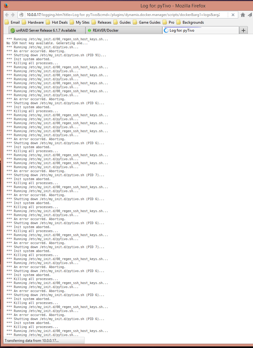

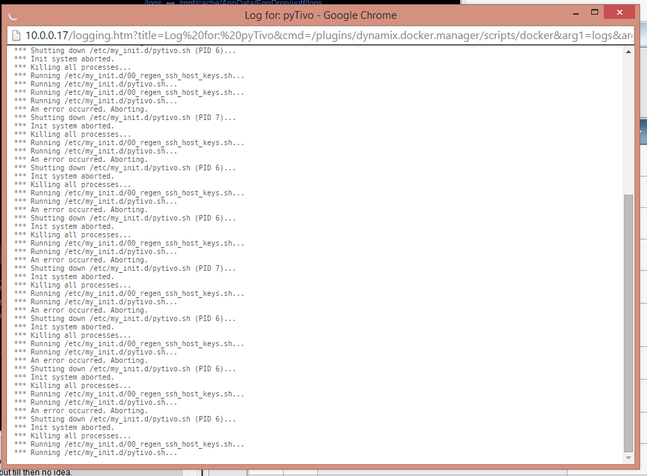

No sorry, it was just a couple of containers that were the issue...  I can't reproduce this here.  Got suspicious as the first container I installed after recreating docker.img doesn't seem to be sending logs
I'll poke around this afternoon/evening.

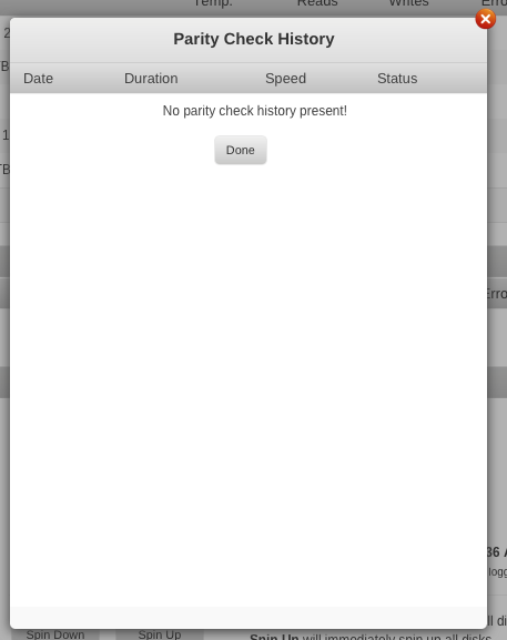

I deleted the
/boot/config/parity-checks.log
file.
Now I have the following line in the parity-checks.log file:
root@Tower:~# cat /boot/config/parity-checks.log
Jan  1 06:40:36|0|0|0
However, I am still not seeing the logs in the Parity History Log popup. Please see the attachment below.
Thanks,
Sagun
