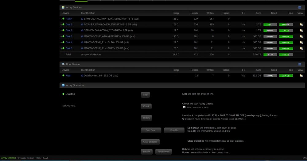

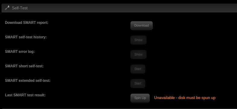

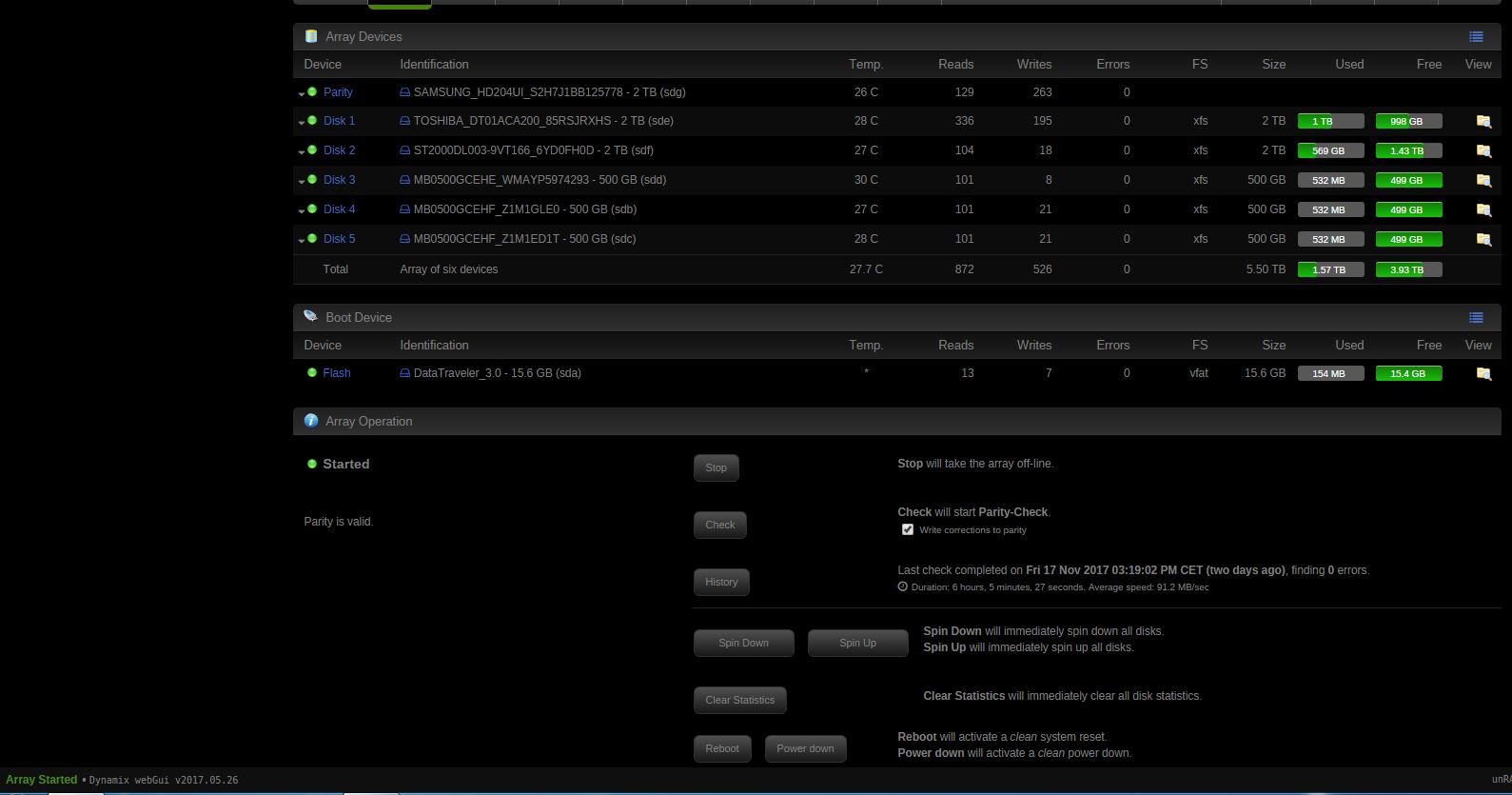

I seem to have the same problem.. Any idea how i get the disk menu back so i can start a smart self test? .. I pressed the spin up button in the disk settings page but the smart alternative did not come back.. and the text still says "Unavailable - disk must be spun up"
When i went to the the mainpage the led were white... after a while i tried to click it so it went grean. That worked but the smart alternative is not back under the specific disk menu. Is the disc still in spun down state or is there a bug? How do i get the SMART self test alternatives back?
I tried doing a restart of unRAID but after the restart the 2 discs have the same problem... I will not use the spin down button in main again, thats for sure ;)
Any advice?
Its disc4 and disc5 that has this problem..
