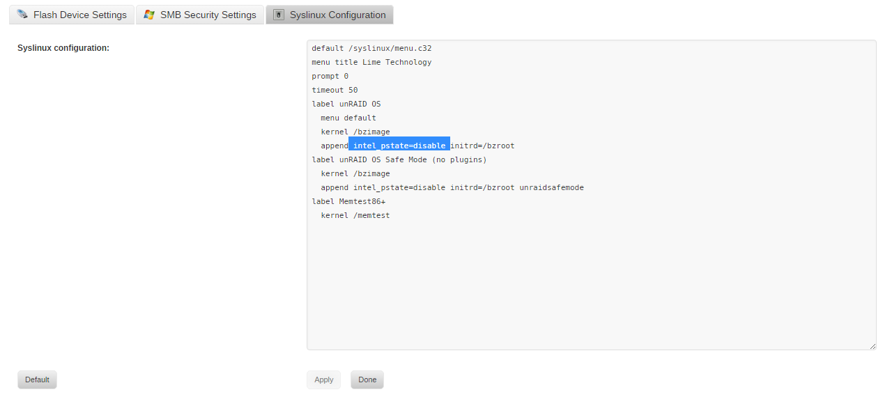

You can add the intel_pstate=disable setting to the syslinux configuration (see attachment)
Goto Main -> Boot device -> Flash -> Syslinux configuration.
Edit and apply the setting. You need to reboot the system to make the setting active.
