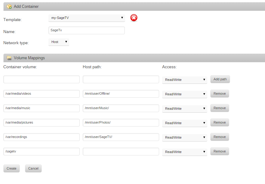

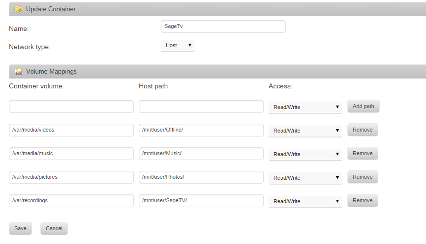

Thanks for the compliant xml.  I edited your sample to match my user share names and then copied the xml file to my flash drive.  I then went to dockerman and created a new container and selected the my-SageTV template and the settings with my correct mappings showed up.  I then hit create and the process complete and the docker is there with the red stop sign and it will not start.  When I edit the container it looks like the <Host>/sagetv</Host> portion is missing.  Also after the creation when I look at the my-SageTV.xml several entries are then missing.  Here is the xml after docker creation:

Does this make sense?  Any suggestions would be greatly appreciated!
I attached my edited version of your xml (renamed as .txt for attachment purposes), and two screenshots of the docker template settings for reference.
Thanks,
Dan
my-SageTV.txt

On a closer look, I think I see what you're talking about "missing entries"  Those would be the <Config section at the bottom.  That is the 6.2 section (not strictly required even under 6.2) and 6.1 does not generate them.  That will not impact loading this template (assuming that the app even works or that the original 6.2 template is correct - All I did was load buddy's 6.2 template, resave it through 6.2 dockerMan and then post the result - and the result happens to be 6.1 compatible
