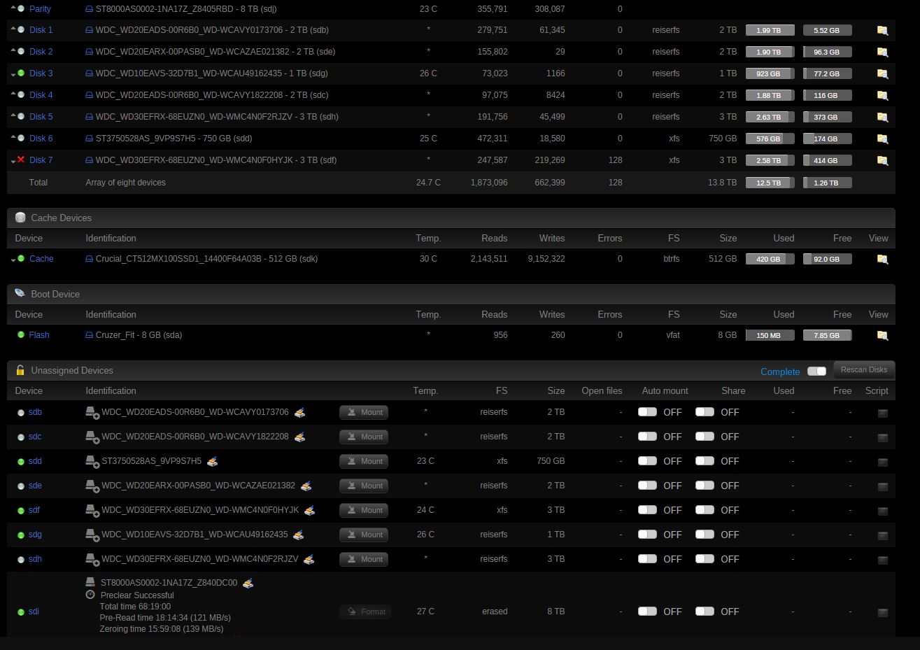

Also I noticed that my array home page is showing the following. Why are all my drives showing unassigned and assigned? Is this an update to unraid in the last update? I am not doing anything with my array until I get some reassurance! lol
What makes you think the drive itself failed and not the controller or cable?
I suspect this is NOT the actual drive failing, but either a bad controller port;  bad cable; or some configuration issue in your system [the screen you posted showing both assigned and unassigned status certainly implies there's some config issue => I don't use the unassigned devices plugin, so am not sure what might be causing this ... hopefully somebody who does can weigh in on this.].

well, there is an LSI raid card flashed to IT Mode but i would think if that was the issue, more drives would be failing since there are multiple drives attached to that LSI card. About half of my array is on that card. I suppose when I replace or reattach this drive, I can replace the SATA cable entirely and change the SATA port on the MB this drive attaches to. I really have no idea what is causing this.
I was wondering if it was normal for this plugin or not. As you can see by the pic I posted, I just ordered and threw in a new Seagate 8TB so I was thinking about rebuilding the array with that drive until I figure out what to do with this failing or not failing drive. The 8TB is precleared and ready to go luckily.
