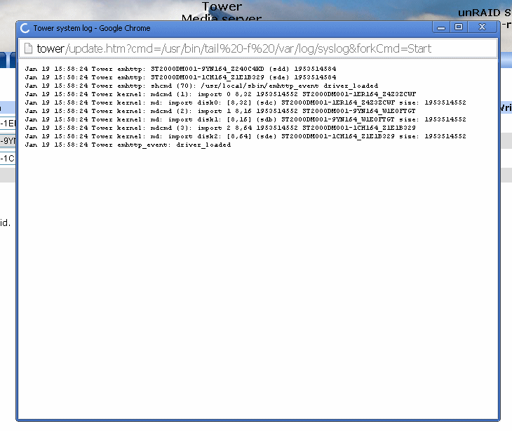

In addition to a screenshot, post a syslog.

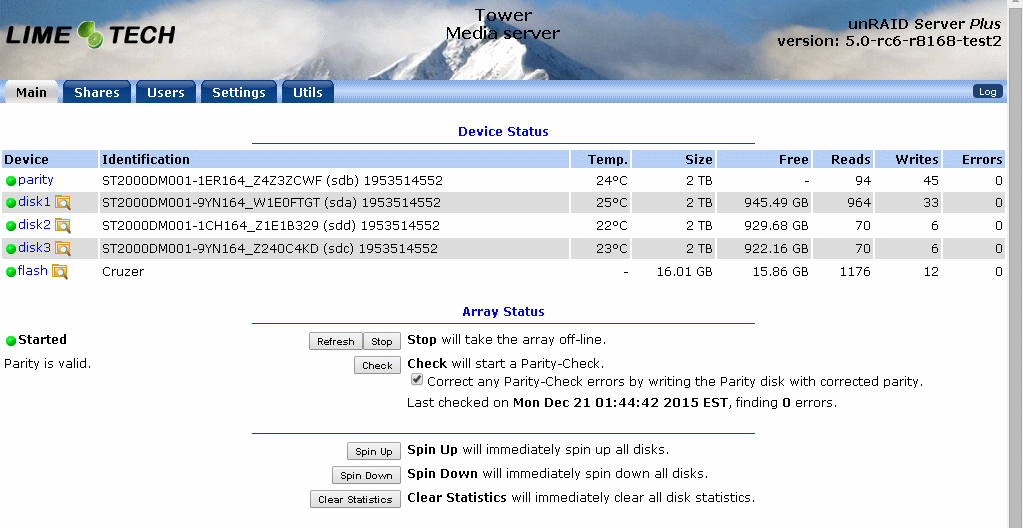

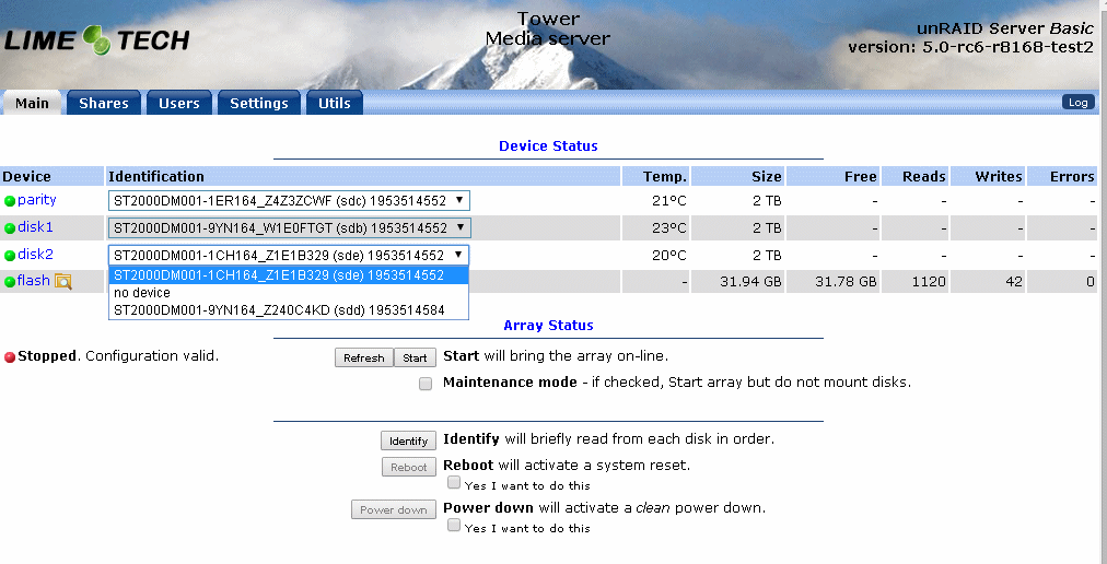

Here is a screen shot of the Syslog using the Backup Flash that is not showing all of the drives.
Also are screenshots of the Main WebGUI screen with the working flash and the backup flash with the missing disk.

You screen shots for the backup suggest that unRAID IS seeing the third drive, but that you have not set the number of slots (at the bottom of the page - off the screenshot) to a large enough value to allow it to be assigned to the array.
