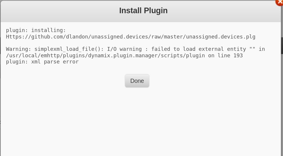

That one doesn't work for me either ... (see attachment).

https://github.com/dlandon/unassigned.devices/raw/master/unassigned.devices.plg
vs.
Https://github.com/dlandon/unassigned.devices/raw/master/unassigned.devices.plg
The one with the lower case H worked.
I'm using the latest unRAID version: 6.1.7
Thanks.
***EDIT***:
vs.
I linked to a version with a lowercase h....  ???
I know - it was my fault. I copied it on my Android smartphone and it was changed to a capital first letter. Didn't know that "Http://" won't work ...

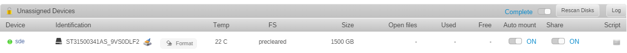

Now I need to find out how to format a precleared disk with that plugin. The button "Format" doesn't work ...
It does if you have enabled 'destructive' mode for the plugin in is settings
