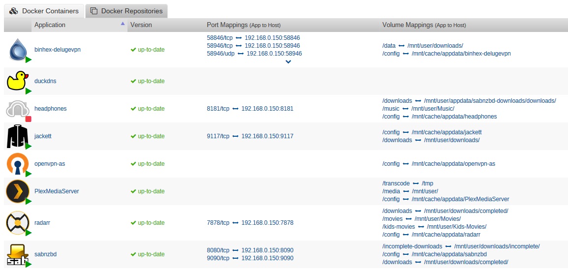

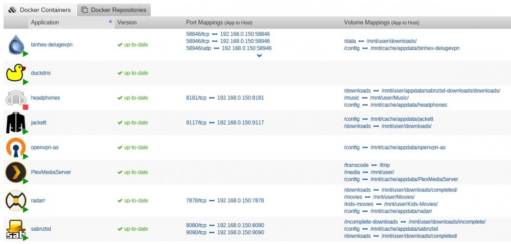

Not sure if this is totally Deluge related but - have an error in radarr that No files are eligible for import from /data/completed
Here are my mappings
Your mapping’s don’t match. You’ll need to set Radarr to match the /data path in Deluge.
should radarr mapping be /downloads - /mnt/user/downloads
Yes
I also have sonarr not shown on screen so im guessing i need to change mappings for
Radarr and Sonarr
Sabnzbd will stay the same
last question how then will radarr know to look in the completed folder inside the downloads folder for movies to rename and move
Magic ?
IDK. Just works.
Ok that didnt work what did work was adding remote mapping in Radarr
I guess changing /data to /downloads in deluge mappings would have the same effect
