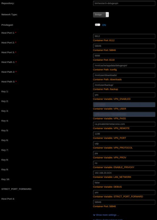

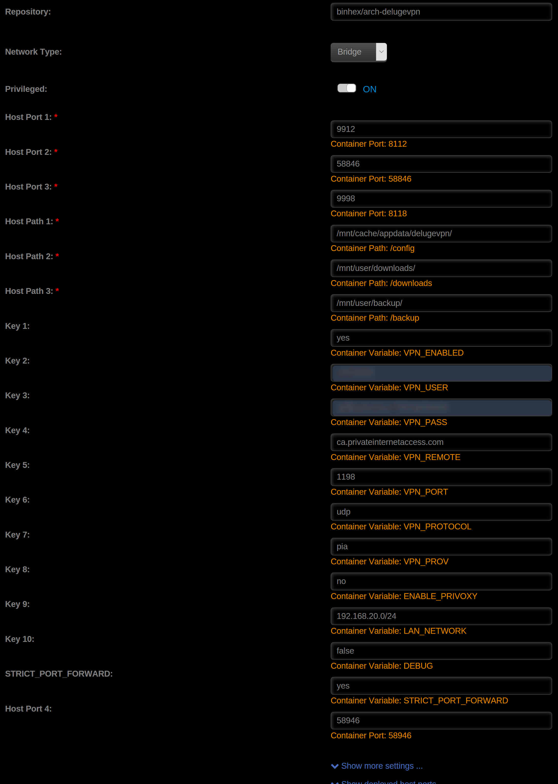

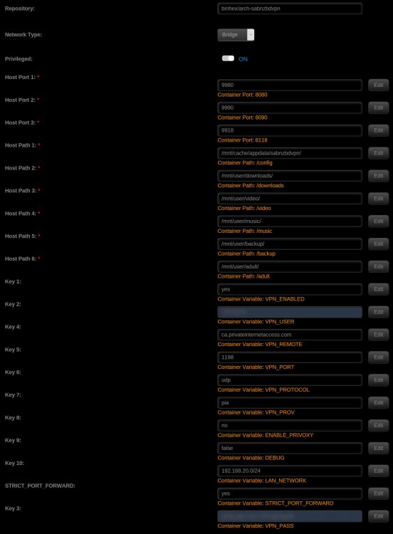

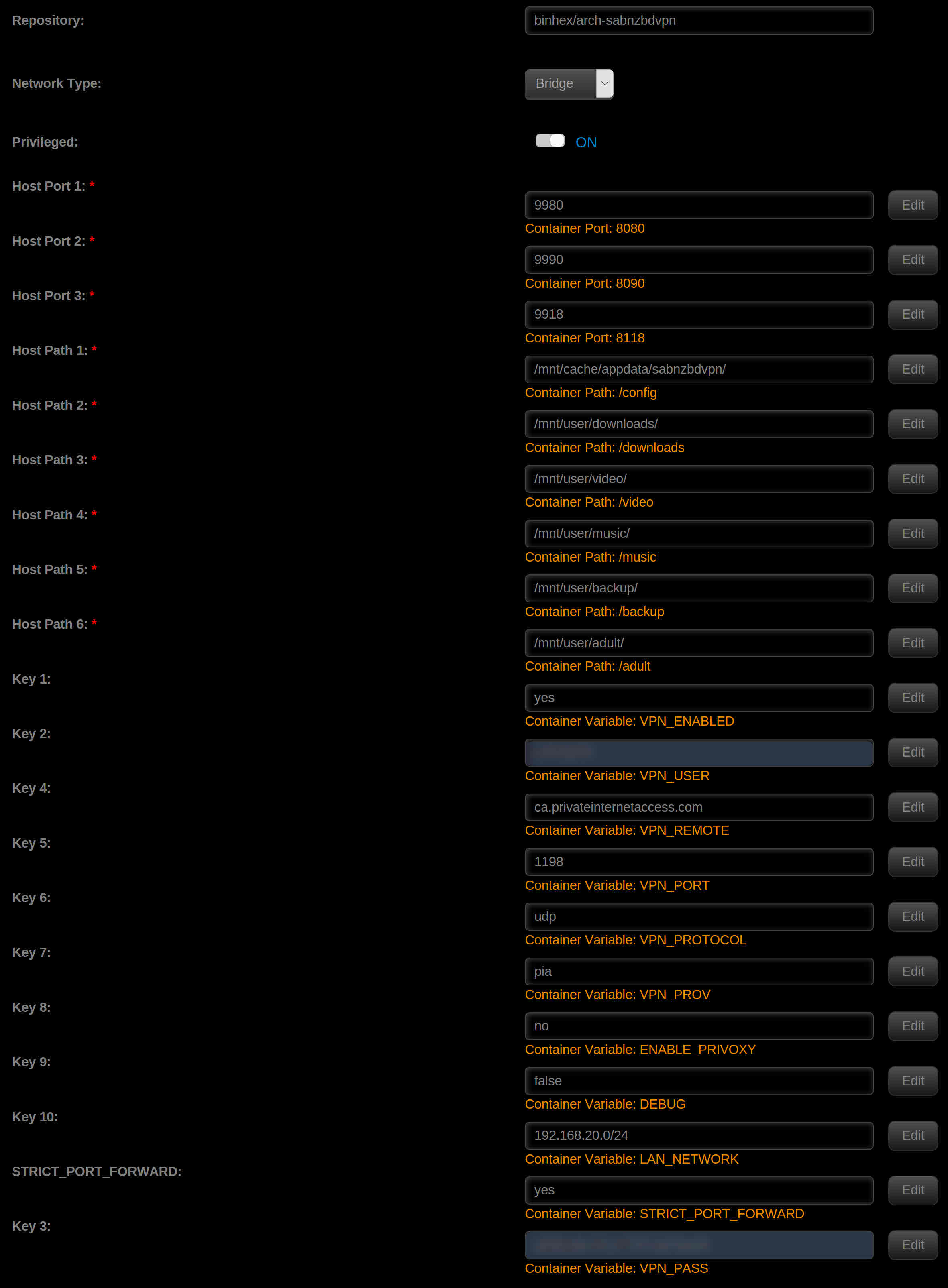

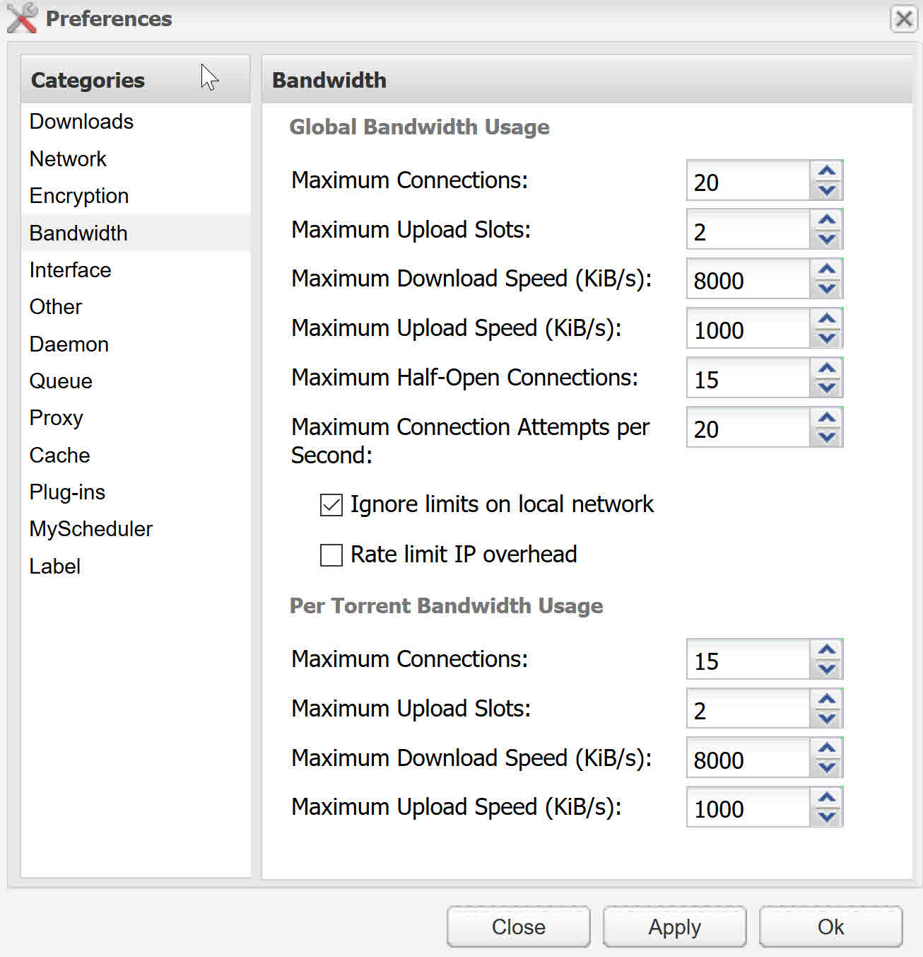

So, I've got terrible satellite internet, and go over my data every month.  But, they do allow me my 'normal' speeds during the day, when the network isn't busy.  My download speed is 12 Mbps, and 1 Mbps upload.  I just ran a test and got 9 Mbps down and 1 Mbps upload, which is typical during the day here.
I have felt my download speeds were very slow with Deluge for some time, but just kinda ignored it, but now it's annoyed me enough to try to 'fix' it.  I know part of the issue will be available seeds, so I went to a torrent site and just grabbed something with over 3000 seeds, so it should be about as fast as it will get.  I watched it climb to about 400 KiB/s, then settle into a more normal for me 125 KiB/s.
I assume this isn't normal and I should be able to get better speeds than this.  With SABnzbdVPN docker I get 1.2MB/s regularly.  I just added something as a test and SAB has leveled off at about 700-800 KB/s.
both are using the same VPN settings.  I included screenshots of the SAB and deluge docker setups and also the deluge bandwidth settings. I think I have it setup right from what I've read here, but it seems something isn't right.
any advice appreciated.
I improved my speeds a great deal by using a drive mounted outside the array for /downloads. You won’t have parity protection for your torrents but that didn’t really matter for my setup.
I have them set to go to my SSD Cache drive.  I guess I could send them to the unassigned SSD I use for my VM's as a test.  Hopefully someone else sees something else I'm not doing right.
I looked at the supervisord.log and it keeps saying "random port = False" which someone said is bad, but I've enabled/checked random incoming ports in the deluge interface settings several times, and it always looks like it's accepted the check, but when i restart the docker, it's back to not being checked.  Not sure how that's happening.
This is really only a guess on my part, but it may be because you have specified a port in the docker configuration. I know I don’t have this variable in my configuration.
do you mean this entry?
Key 6:     Container Variable: VPN_PORT   1198
I don't remember adding that, i thought it was part of the template.
Perhaps I need to just kill this container altogether and restart from scratch.  Although, it seems I have it set right, that seems drastic.

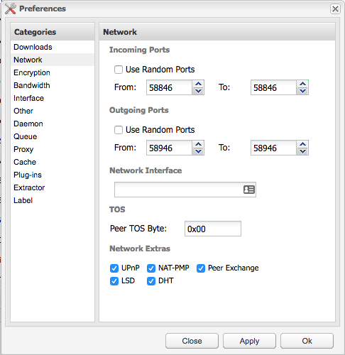

Hey guys,
I'm struggling getting connectable. Both porttest.net and canyouseeme says I'm invisible, in addition to the trackers that I'm using.
So my Deluge-settings looks like this:
5a6da177eb966_ScreenShot2018-01-28at11_07_20.png.74fad9252df85d72b38ce312f8407d00.png
My router (Unifi USG with UPNP disabled) like this:
5a6da1a9554ae_ScreenShot2018-01-28at11_10_09.png.e6678e24c16b601b93d327f1da6ae1d5.png
*Note this type of port-forwarding works for other services like Letsencrypt/Plex.
And my docker:
5a6da1d222894_ScreenShot2018-01-28at11_11_03.png.cc7206c2c938d25c681b6a3114242c14.png
I'm running latest Unraid with latest docker (non-vpn). I've also tried moving the docker to br0 with a static, separate IP, without any luck.
I'd love some pointers on where I'm going wrong.

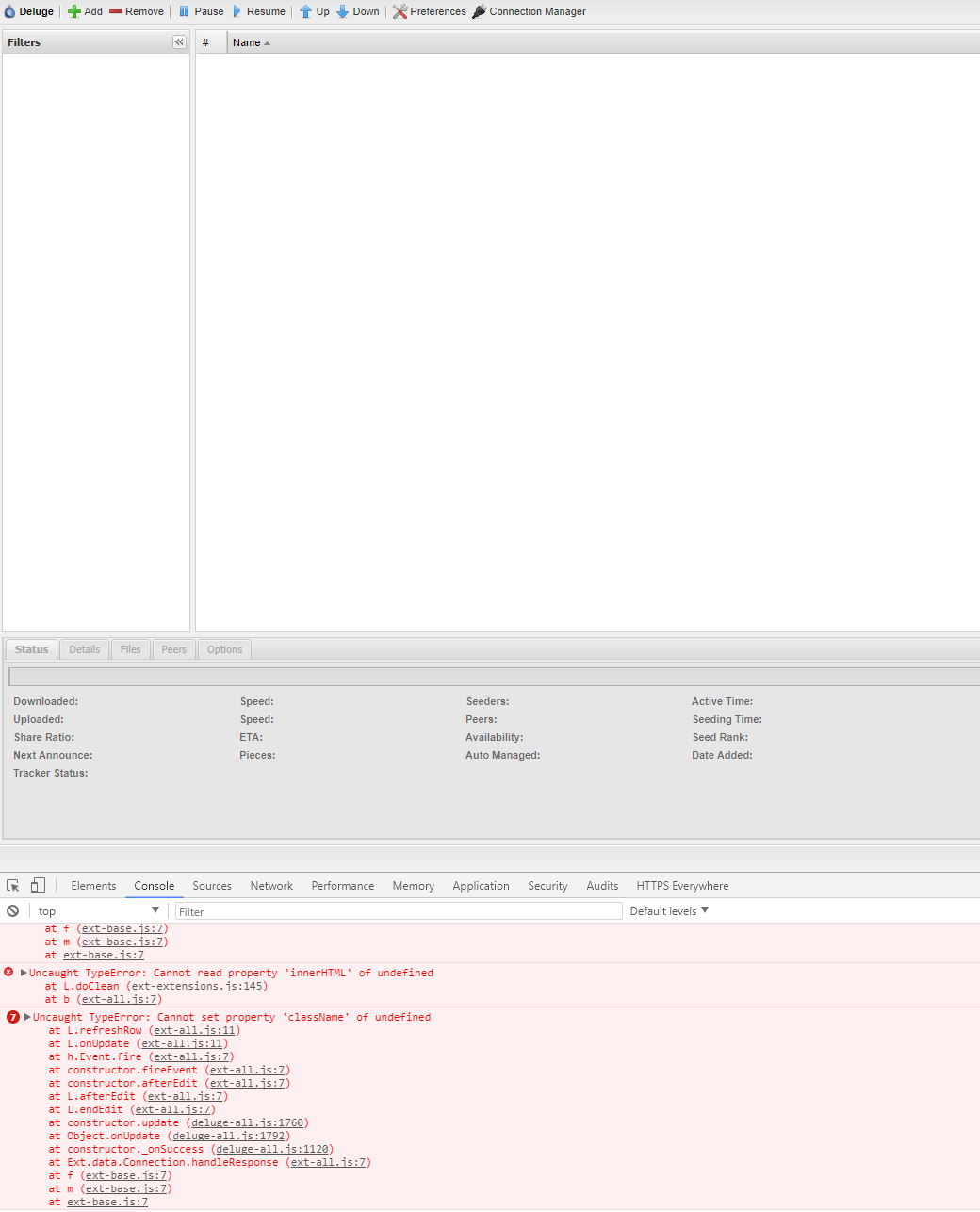

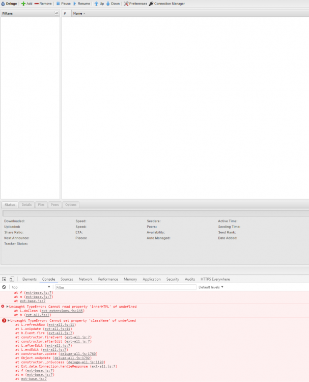

 Anyone have any thoughts on how I can solve the WebGUI not working properly? There seems to be a number of Javascript errors being thrown and I'm not sure of the root cause or even how to investigate. I've attached an image showing the issue.
EDIT: I found the issue. I have Radarr let up, and there was several corrupt files, so it was sending over the same file over and over and over, causing an error.
Edited by J_Hizzal
Fixed the issue.
I'm having the same issue. After a few hours the daemon will crash. The web ui is still accessible, but nothing like Sonarr or Radarr can connect to it. Also nothing will appear in the GUI like in your picture. Restarting the docker helps, as does restarting the daemon. Not sure what's wrong but it's been happening for about a month now. Really frustrating.
15 hours ago, Fredrick said:
Hey guys,
And my docker:

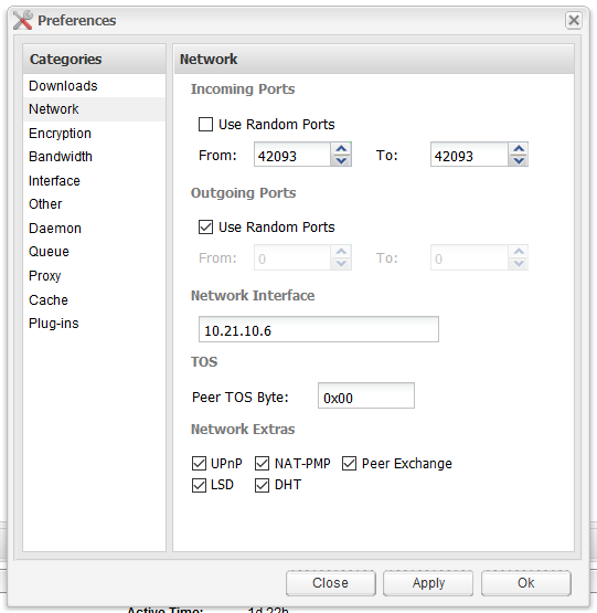

I am using DelugeVPN and connect without issue.  For comparison, here are my settings (none of which I modified, they are all the defaults):
Note:  Incoming Ports: Use Random Ports is not checked and it is not necessary to set it to the port variables specified in the docker setup. Outgoing Ports: Use Random ports is selected, but no ports are specified.  You have nothing in the Network Interface and I suspect this is a problem.
These are default docker settings, I modified nothing.
I also have a Ubiquiti USG router and it is not necessary to set any port forwarding rules for Deluge. I have set some port forwarding rules for OpenVPN and Plex, but nothing for Deluge.
I don't know of this will help, but, it comes from my working setup and there are several differences.
Note: I do not have an IP address assigned to this docker.  It is using the same IP as  the unRAID server.
