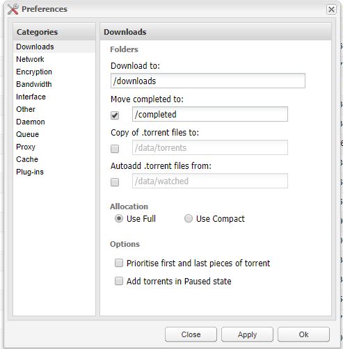

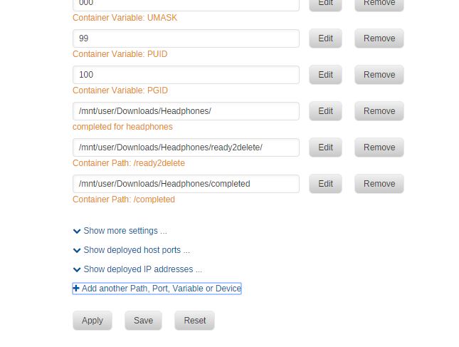

Can anyone point me in the right direction as to why deluge might not be moving completed downloads the completed downloads just sit in the downloads directory
As far as I can see there is no problem with my config, I cannot find a logfile to tell me any different?
Many Thanks!
Many Thanks!
From what I can see from your config /downloads isn't mapped to anything. So how can deluge move anything from /downloads when it isn't mapped in your config?
Edit: or it's: completed for headphones in your config? I can't see the container mapping so I don't know
Edited by strike

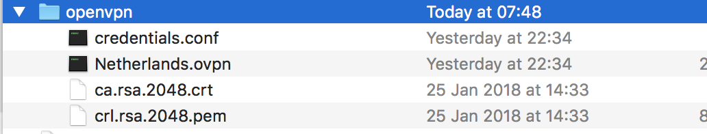

dos2unix: Binary symbol 0x00 found at line 1
dos2unix: Skipping binary file /config/openvpn/._Netherlands.ovpn
2018-02-22 07:56:57.606292 [crit] VPN configuration file /config/openvpn/._Netherlands.ovpn does not contain 'remote' line, showing contents of file before exit...
Mac OS X            2∞‚ATTRWÄ‚ò9ò9com.apple.quarantine0081;5a8de550;Chrome;CF44E65D-5F4A-4FED-8ABA-35786C5450D8This resource fork intentionally left blank
5a8e6a6670bf0_ScreenShot2018-02-22at07_46_10.thumb.png.70f3cbd616fd80eeceb6ceea2f1db509.png
The built-in antivirus in OSX is quarantining the.ovpn file. Exlude the file in your antivirus app and you should be good
Edited by strike
Wow, I actually did not know that OSX had a built in antivirus function!
It might be due to the lack of coffee, but my google searches does not yield any results in how to do that. Thanks for the quick reply though!
actually my faq is not correct (sorry strike i know you were quoting from my faq), these are mac os resource fork files being generated, i noticed your post and i have enhanced my code to remove these files as they are basically apple crap, or crapple if you like :-), new image should be up later today, in the meantime you could manually get running by cd /config/openvpn and then run the following command:-
rm -f ._*.ovpn
then restart the container.
p.s removed the entry from the faq as its now handled automagically :-).
p.p.s for those who want to learn a bit more:- http://xahlee.info/UnixResource_dir/macosx.html
Edited by binhex
rm -f ._*.ovpn
Thanks for still updating this awesome docker! :D
I'm quite new to unRAID, so I'm not sure if you mean I should use the terminal in the webUI for unRAId or the terminal in OSX?
either :-), if you're new then why not the web ui, its easier eh.
