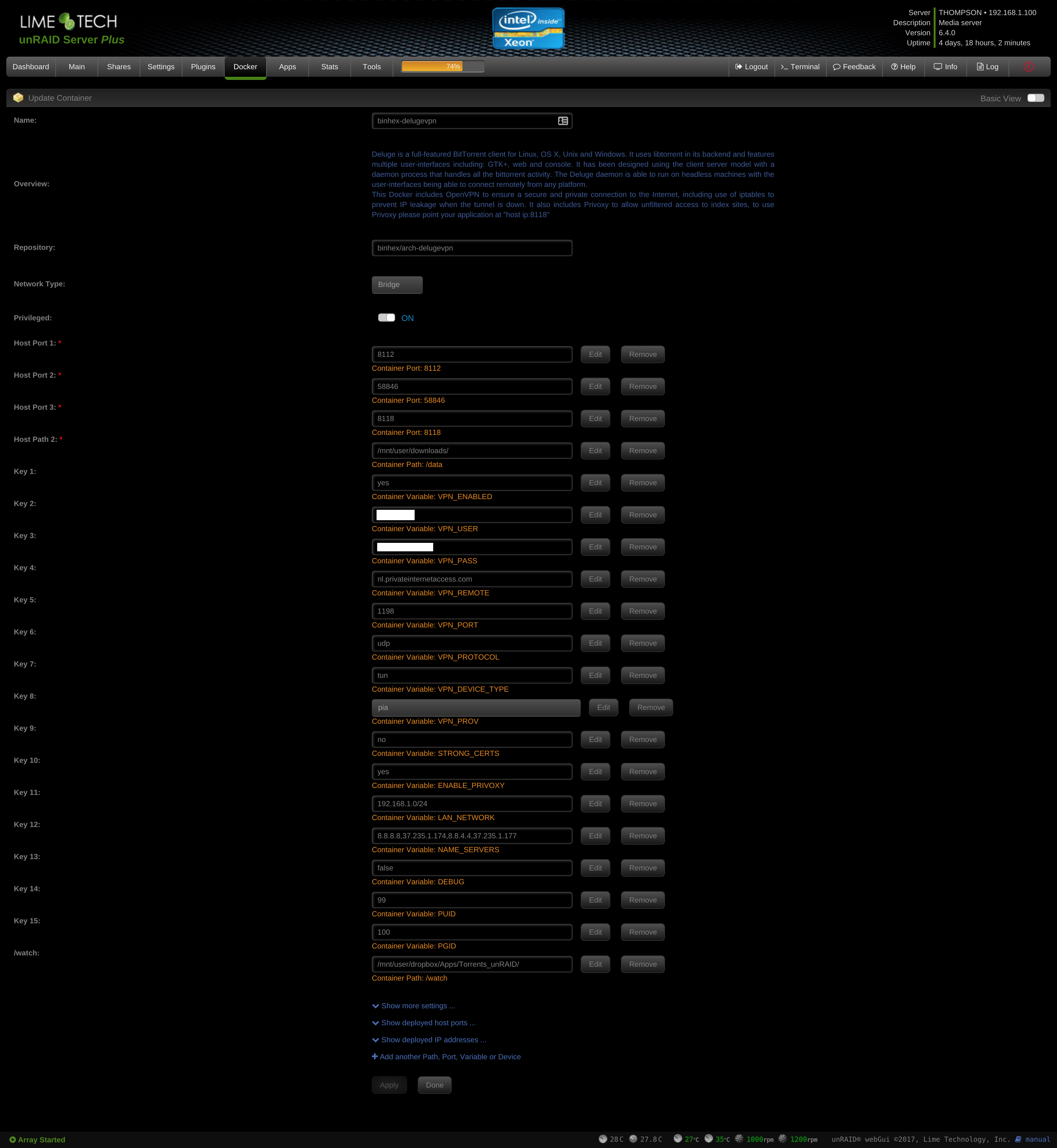

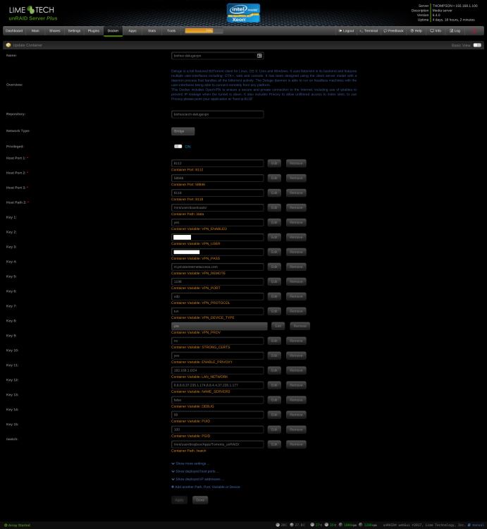

I have a problem.
I had to restore my appdata from a backup. All seemed to go well but now I can not access the deluge daemon from any client on my LAN. The webui seems fine. But the daemon seems to be just... not there!
58846 is open according to nmap:
Host is up (0.0020s latency).
PORT      STATE SERVICE
58846/tcp open  unknown
Where should I be looking to troubleshoot this? supervisord.log (with debug enabled) attached.
supervisord.log
Edited by gergtreble
Added docker settings screenshot
