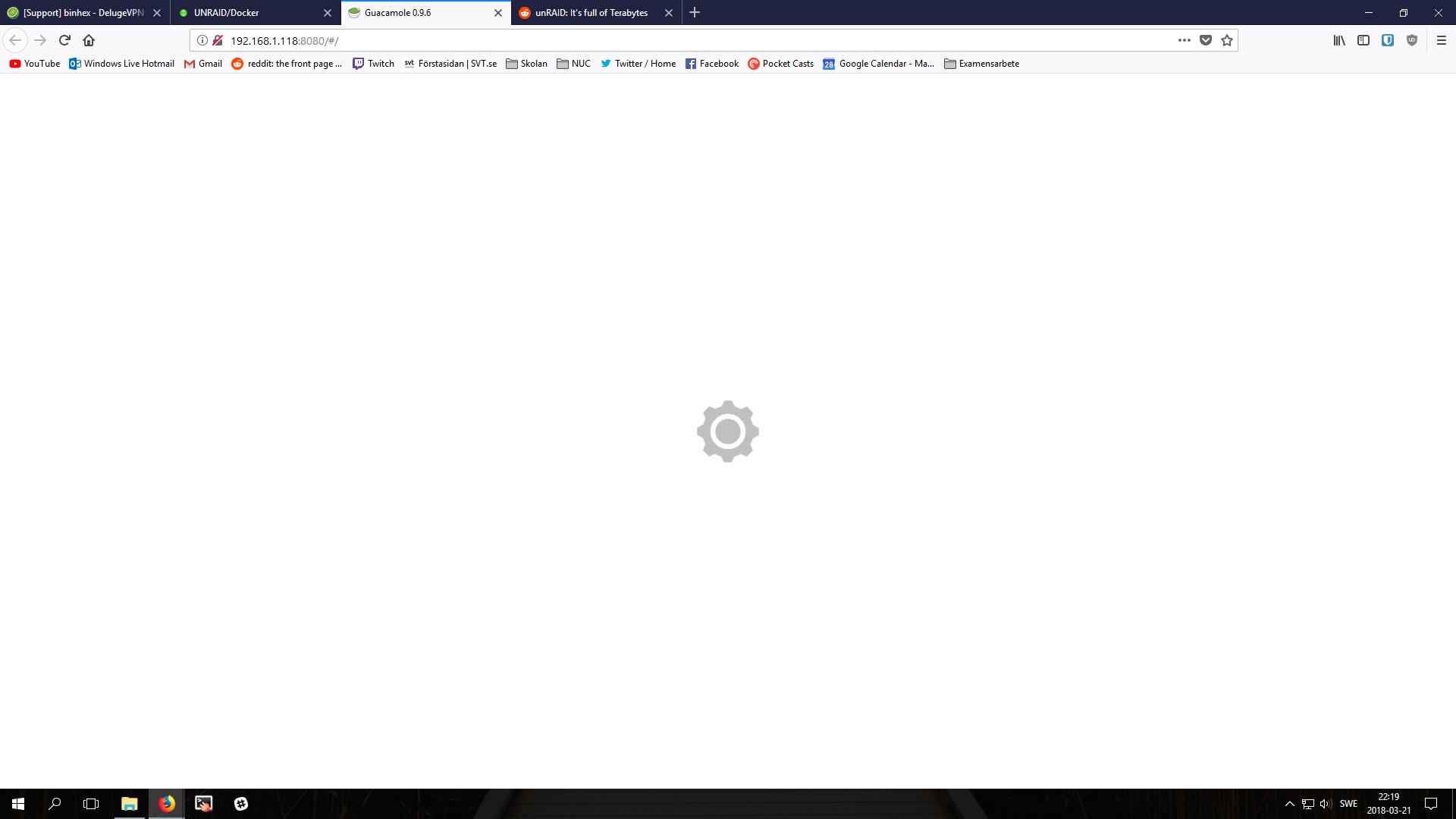

Ah sorry, my previous post was a little vague. I cannot access the web-ui. Neither can sonarr contact sabnzbd.
EDIT: To add on this, when i rightclick the sabnzbd docker in the unraid GUI and select the option "webui" it opens 192.168.1.118:8080/#/ and opens guacamole. Is there some redirect issues going on? I've tried rebooting unraid, flush the dns and open the link in incognito but it still opens up the guacamole interface...
This is what it looks like if i start the sabnzdb container and open the webui:
Edited by peeqi
