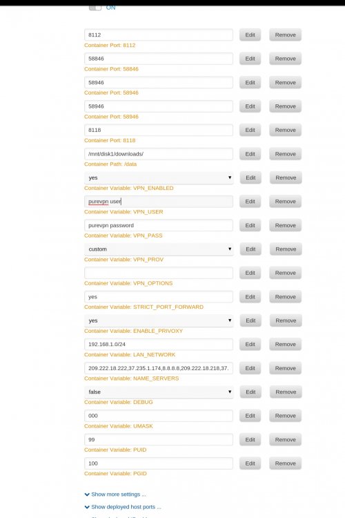

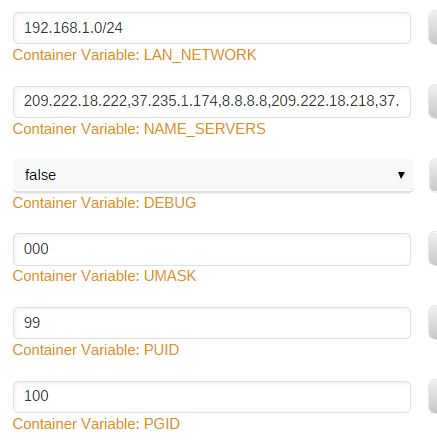

I have a few questions regarding Delugevpn. For my VPN provider, I have to send an email for them to enable port forwarding. I have a port forwarding range of 49,000 - 49,999 udp or tcp. I left the ports to default for the container, so I would need to replace the incoming port which is 58946, with one from my VPN’s approved range, correct? Do I need to forward the daemon port? Also, can I use both DelugeVPN and SabnzbdVPN at the same time? When I try to start Delugevpn, I always get a server error, but when I stop sabnzbdvpn, the webui for Delugevpn starts without issues.  Can sabnzbdvpn use privoxy from Delugevpn? I didn’t see an option for it in sabnzbd’s setting options?

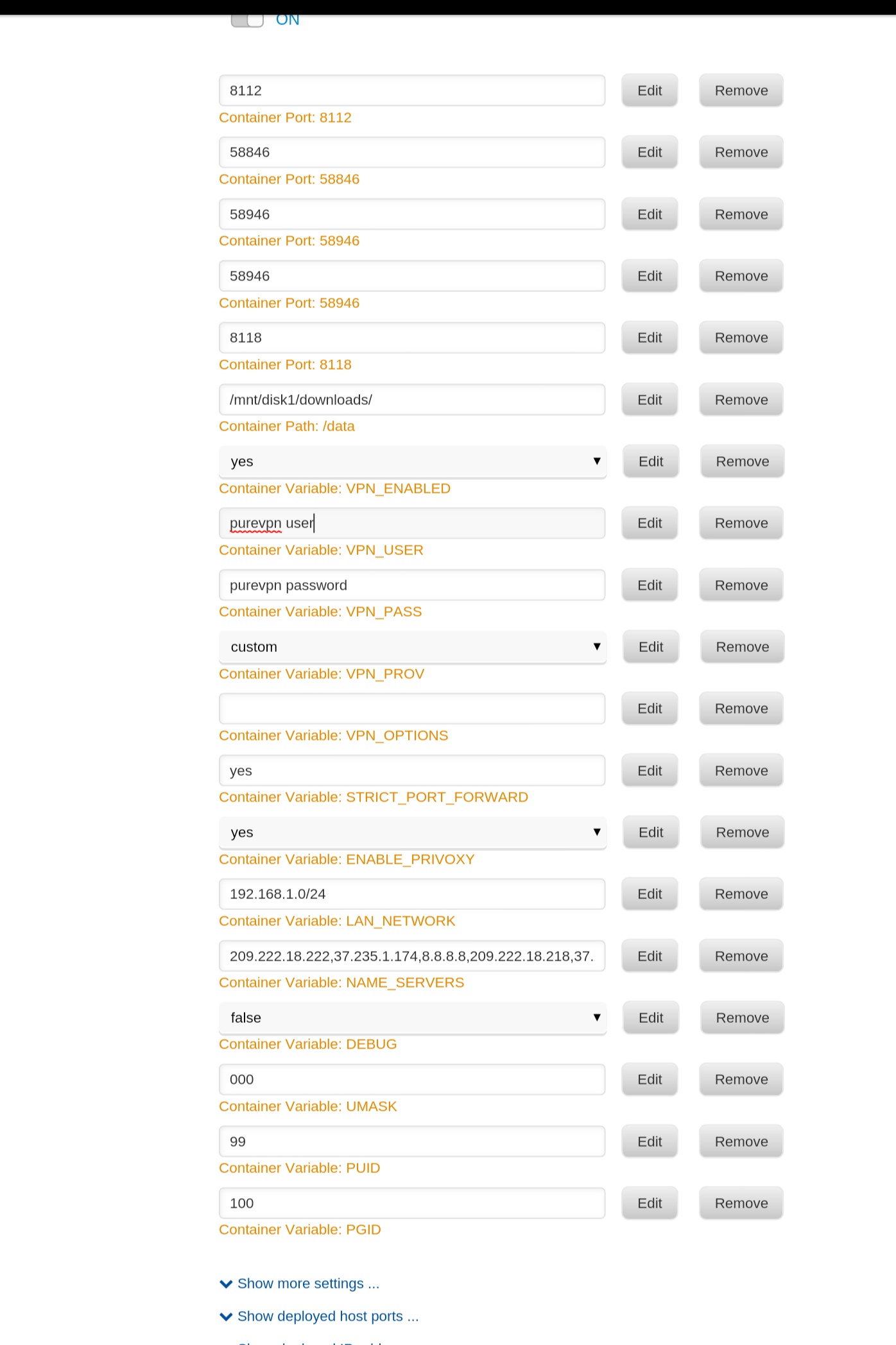

Hi,can someone help me, please  with delugevpn setting with Purevpn i can't get it to work i found a tutorial for Piavpn but not work. Thank you very much.
Edited by Vesko

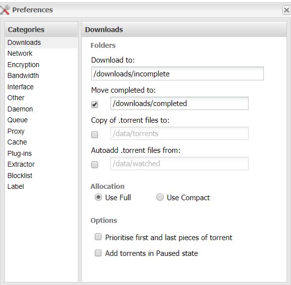

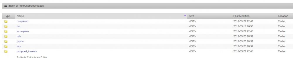

On 3/22/2018 at 3:08 PM, greennick said:

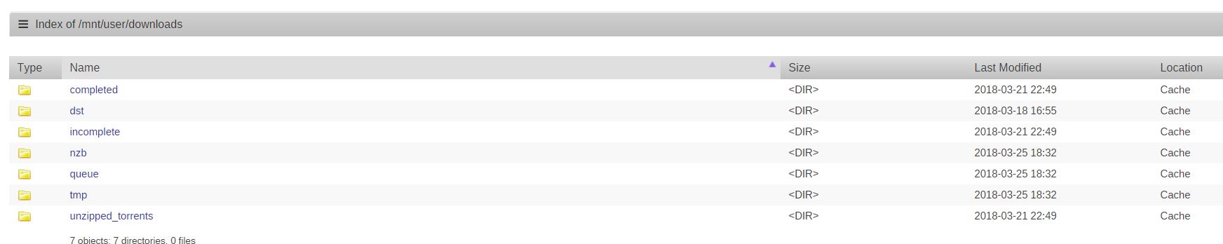

I am new to all this, just setting everything up after building a server, so please bare with me.  I can't get Deluge to work.  I thought I had set it all up right, but I get the following errors:
In deluge on each download:
Status: Permission denied: /downloads/incomplete/ubuntu-17.10.1-server-amd64.iso
Then in the deluge log files:
2018-03-21 21:23:22,306 DEBG 'deluge-web-script' stdout output:
[info] Starting Deluge webui...
e":"can not get logs from container which is dead or marked for removal"}
e":"No such container: a5cdf7b73613"}
What should I look at changing first?
Thanks

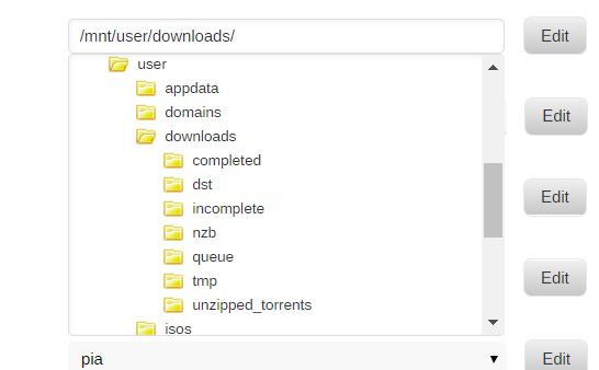

Really at a loss with this as it seems my permissions are fine (ran New Permissions to be sure):
root@Tower:~# ls -l /mnt/user/downloads
total 0
drwxrwxrwx 1 nobody users   0 Mar 21 22:49 completed/
drwxrwxrwx 1 nobody users  24 Mar 18 16:55 dst/
drwxrwxrwx 1 nobody users   0 Mar 21 22:49 incomplete/
drwxrwxrwx 1 nobody users 116 Mar 23 06:55 nzb/
drwxrwxrwx 1 nobody users  24 Mar 23 06:55 queue/
drwxrwxrwx 1 nobody users   0 Mar 23 06:55 tmp/
drwxrwxrwx 1 nobody users   0 Mar 21 22:49 unzipped_torrents/
total 0
what is your umask set to?, had a VERY similar issue only a few days ago with another guy who set is umask to 755, that is a  BAD idea.

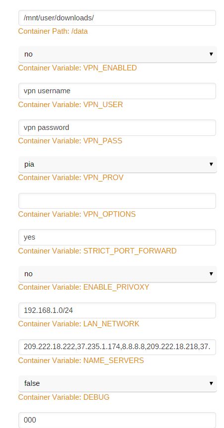

Thanks for the response binhex.  I didn't think I changed any of those settings following the advice of Spaceinvader One in his binhex videos.  Settings are attached, umask is 000.

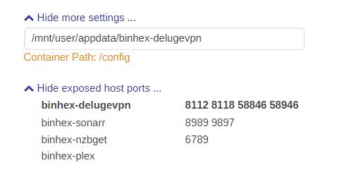

yes, just ensure that privoxy is running on a different host port otherwise they will clash.
this is probably the port clashing, see previous comment.
ok can you screenshot the rest of the config, im interested mainly in the volume mappings.

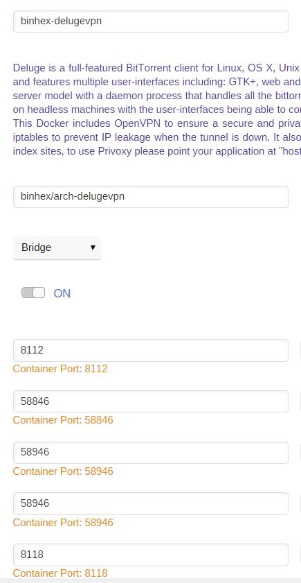

here are the rest of the settings

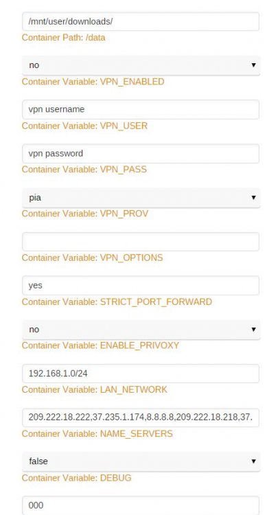

yeah, so /downloads does not exist, see below for snippet from your screenshot:-
note the container path, its not called /downloads, its called /data, thus you are trying to store downloads in a folder that doesn't exist, change your config in deluge to use /data/<whatever>.
I created a share called downloads, would that not work?  In SI1s video he created a downloads share and then linked to that.  Do I need to create a data share to switch to that folder?
Or do you mean I should path it to /data/downloads/incomplete?
in short you have two options ro resolve this:-
1. stop the container and change the container path (not to be confused with the host path) from /data to /downloads.
or
2. reconfigure deluge and change /downloads/incomplete to /data/incomplete, do the same for completed.
you really need to get your head around volume mappings, take a look here for my explanation of it Q4:-
https://lime-technology.com/forums/topic/44108-support-binhex-general/?tab=comments#comment-433612
Edited by binhex
or
Agh, that is so simple of a fix that has taken me hours to get to!  I changed the path in deluge to /data/incomplete and it works.
So, essentially in the deluge app it will replace /data with the mapping to /mtn/user/downloads I mapped in the docker container?  So, I have the following;
I created a share /mnt/user/downloads
Within which I created an incomplete directory: /mnt/user/downloads/incomplete
In the deluge docker settings /data is mapped to /mnt/user/downloads
Then within deluge I map incomplete to: /data/incomplete
Edit, I just downloaded a 1.5gb test file in less than 5 minutes, which moved to complete with no issues, so everything is working !  Cheers binhex, sent a small donation your way for the help.
you got it!, thats it in a nutshell.
