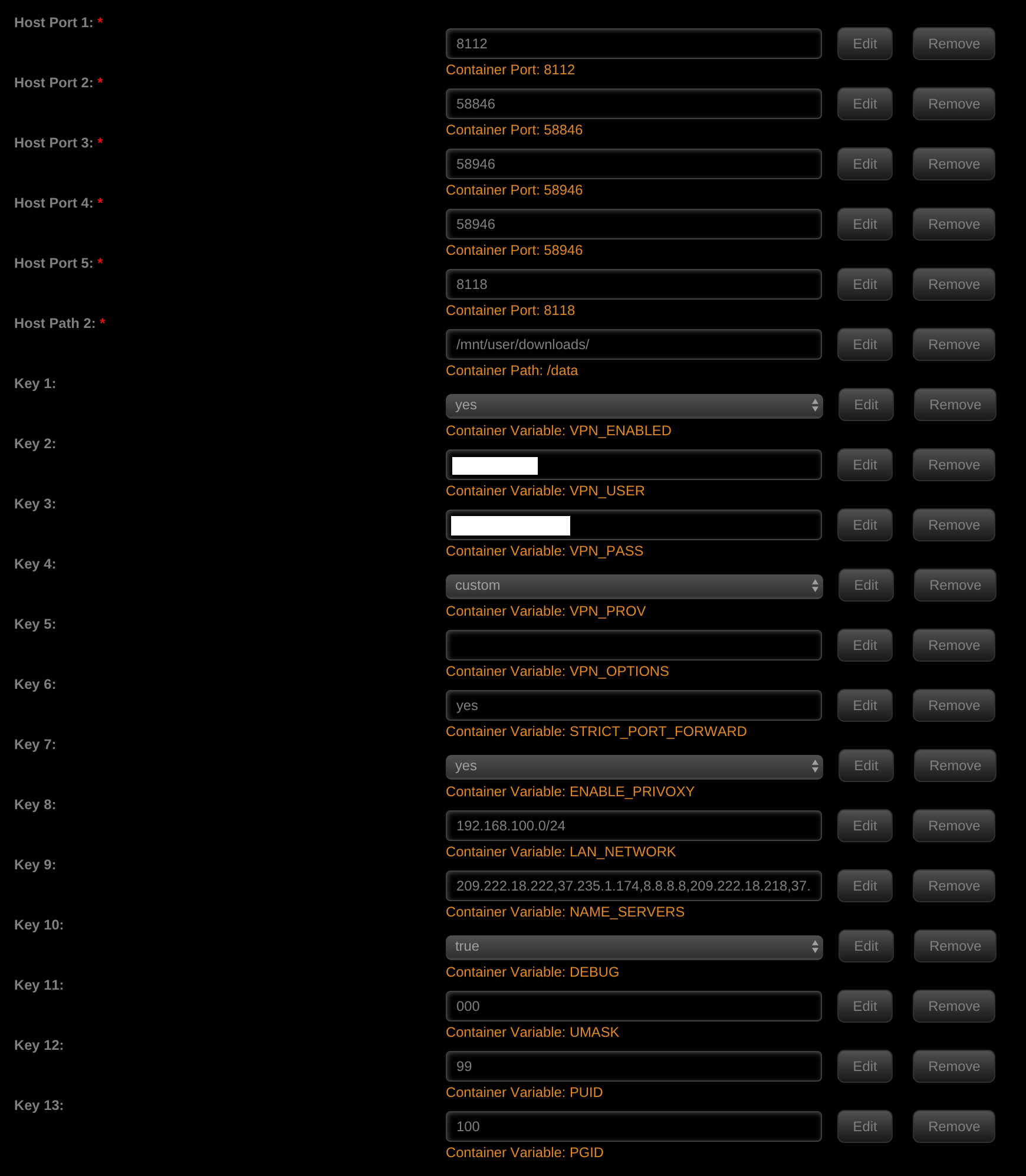

Hi there, would love any tips for getting VyprVPN to work with this Docker. I've followed SpaceInvader1's YouTube tutorial, but he uses PIA. I even signed up for a month of PIA, and that works, however I don't want to pay for two VPNs if I don't have to.
I've tried using VyprVPN with "STRICT_PORT_FORWARD" set to "yes" and "no", the tutorial says it should be 'yes' for PIA, but I don't know for VyprVPN.
Posting my log file. I'm using a .opvn and cert file from VyprVPN. I got them from Goldenfrog.
Thanks for any help.
I'm getting conflicting information on the VyprVPN support site on whether or not they support incoming ports. If they don't allow you to open up an incoming port, you are not going to be able to seed torrents, even if you do get a vpn connection. I know for sure if you enable their NAT Firewall, it won't work.
