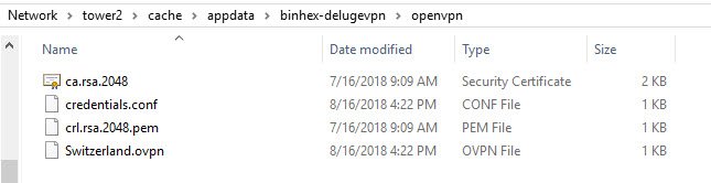

I tried option 1 but it didn't work for me.  I also didn't see a variable for STRICT_PORT_FORWARD in my settings.  Is this because I have an outdated template?
EDIT: I also noticed more than one file in the /config/openvpn/ directory.  Is this an issue?  I tried removing the openvpn.ovpn file but no change.
Edited by betaman
option 1 worked good for me - using Switzerland
Can you please screenshot your /config/openvpn/ directory?  I tried Switzerland as well to no avail.
Sure here you go
