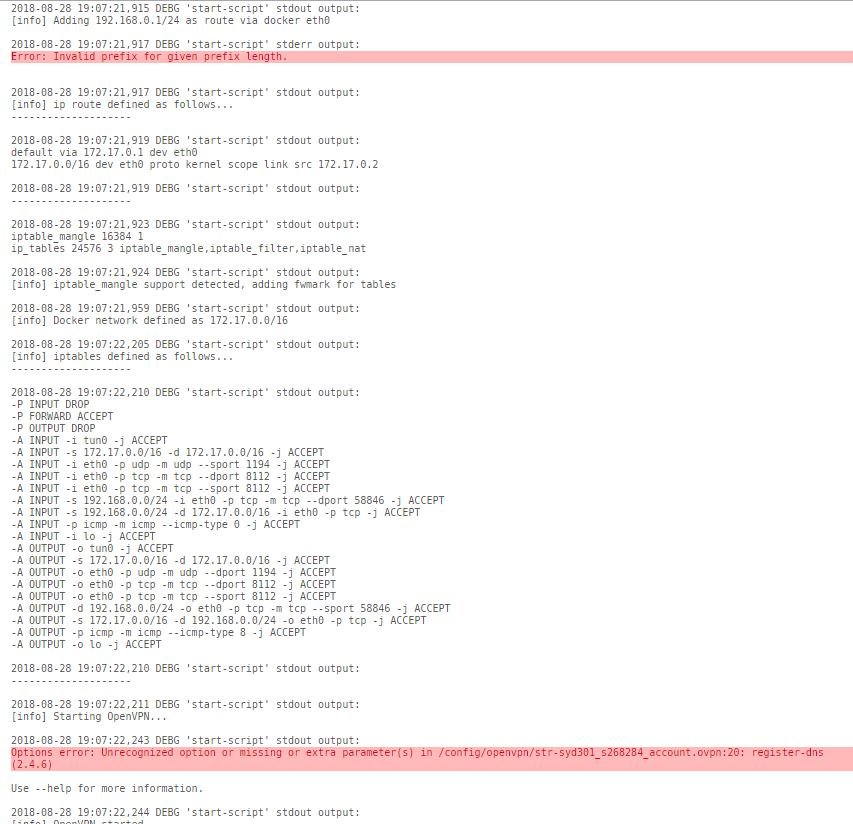

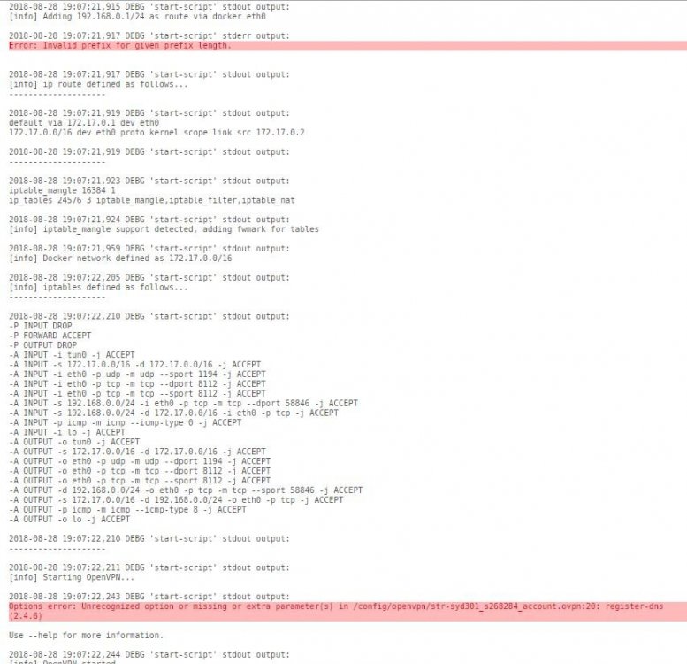

Im trying to get this working with my current vpn provider (Strongvpn). When I have vpn turned off deluge works as expected and everything is fine. I checked the log file when vpn is turned on and I get these two lines in red. Ive set the VPN_PROV to custom and have entered the user name and password they gave me. Ive downloaded the vpn file and put it in the /appdata/binhex-delugevpn/openvpn folder. Is there anything else I am missing?

    Found the solution on reddit.   Due to the recent change in the authentication process, using your email and password for the manual connection method will no longer work. You will need to u
Remove everything in vpn_options

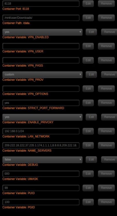

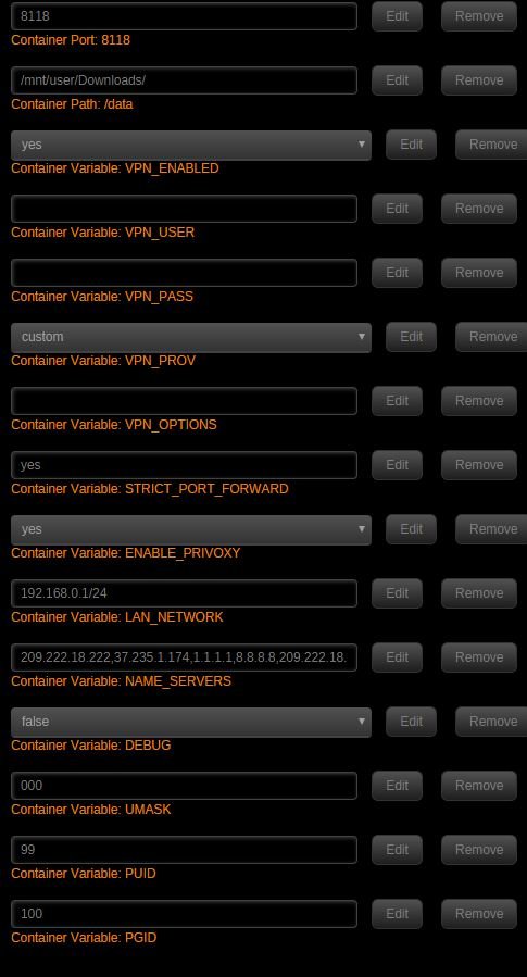

Is there anyway I can change the docker containers local IP.  Right now it is the same IP as my unRAID system, I would like to change it for QOS.  I changed it earlier today and the web interface wouldn't load, however the log gave no errors.
In the setting there is nothing in that particular box. When I select edit there are more options. If I remove that box all together will it negatively affect anything?

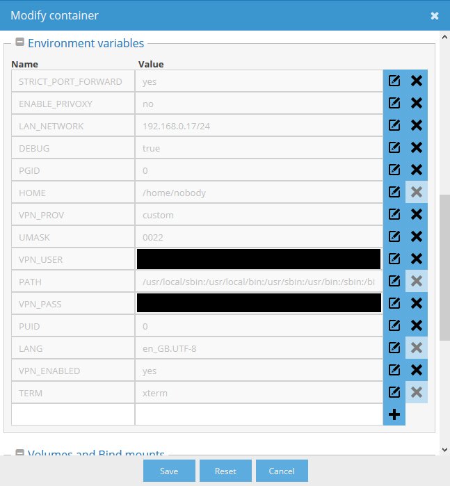

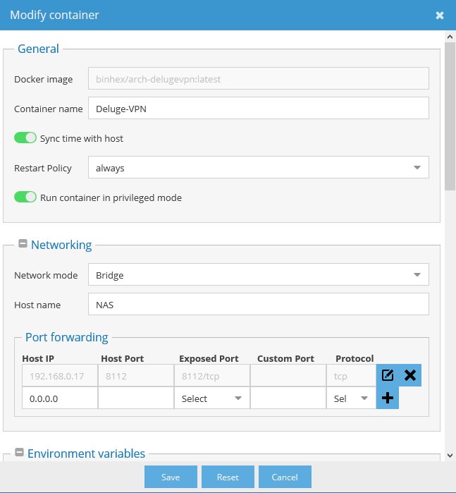

Hello there !
I'm trying to use your plugin in a docker with OMV, but I have some issues :
- without the VPN, everything is OK.
- with the VPN, I don't know how to see the webui anymore.
Here are my settings :
At the end of the "supervisord.log" file, I have this :
[debug] VPN incoming port is
[debug] VPN IP is xxxx
[debug] Deluge incoming port is
[debug] Deluge IP is xxxx
There is nothing after "incomming port is".
"xxxx" replace my real ip address.
I did setup the port forwarding with my VPN, but when I try to connect to the ip address with this port, it's not working.
Did I missed something ?
@snowfitz Try changing your lan_network to 192.168.0.0/24
Edited by strike
Done, but whatever the combo of ip address / port, I can't access the webui. Maybe I'm not trying the good ones.
There is only one correct combination to reach the webui and it's HostIP:8112
If it doesn't work you need to enable debug logging and post the complete supervisord.log file
