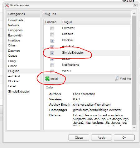

DelugeVPN keeps removing my plugin "simply extractor" and reverting back to "extractor"
Binhex, did you change the default /data mount to /media ?
I only just noticed this as all my downloads started failing!
nope, the template hasn't changed in 7 months (even if it had it wouldnt change your template), and i dont set defaults for any deluge configuration.
How odd. I fixed it anyway now. I think I must have customised it and it got re-installed then.
Binflex we're you able to look at this?
Sent from my Pixel 2 XL using Tapatalk
I don't use this docker and haven't use the application either.
How is this plugin installed? Typically the only things that persist in a docker is things in appdata since container updates are basically a reinstall.
I had appdata set to cache yes, I switched that to Only. Hope that this helps. Thought something between the drives once getting now transfered right or something
If I need to provide more information, please let me know.  I have been trying to determine what changed for over a week and I'm unable to figure it out.  From my point of view, nothing has changed.

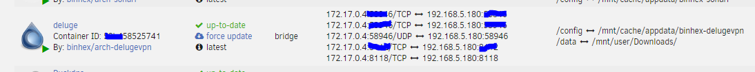

I switched to cache-prefer since I see its better than cache-only.
Here is image of my setup.
What I was trying to get at earlier about how a deluge plugin is installed. I don't know, am not inclined to research it since I don't use it, and you haven't told me.
A docker container is a little OS designed to hold a single application. The question is whether or not the installed plugin resides in Unraid storage (appdata) or resides somewhere else in that little OS. If it isn't in appdata it won't persist since updating the container replaces that little OS.
Maybe someone who uses this will be able to help you.

Plugins should be installed in appdata/binhex-delugevpn/plugins/.
In the past I’ve had issues with plugin settings reverting to defaults (I believe this is/was a Deluge issue) but never had plugins completely disappear.
@scubieman What method did you use to install the plugin?
I use the install button then select the plug-in egg. The plugin stays installed. Just goes unchecked and extractor plug-in goes checked.
I’ve seen a few similar complaints in the Deluge forum. Might try starting a thread there.
In my case, using the GTK to configure the plugins seems to have helped. I haven’t had any recent problems with plugin settings getting corrupted.
ive also seen this issue, i believe its a deluge bug thats been around for quite some time, as i cannot see any permissions related problems with the image and the plugin does install, its just deluge unticks the option, weirdly if you then re-tick it you can end up with multiple installs of the same plugin!.
You recommend qbittorrentvpn then?
its an option thats available although the web ui version of qbittorrent is missing a lot of functionality imho, it depends what you need, give it a go, its still in the early days and there is a lot of work to be done to the web ui for qbittorrent before its anywhere close to the gui version but it seems stable to me.
