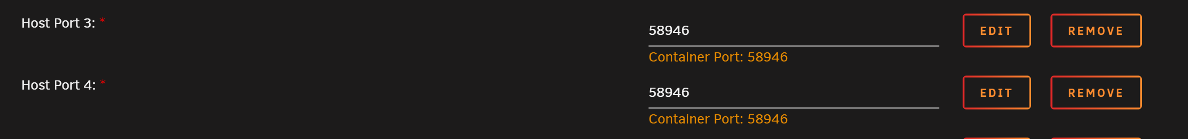

just now Deluge-VPN won't start and a reinstall gets this message.
root@localhost:# /usr/local/emhttp/plugins/dynamix.docker.manager/scripts/docker run -d --name='binhex-delugevpn' --net='bridge' --cpuset-cpus='2,4,3,5' --privileged=true -e TZ="America/Phoenix" -e HOST_OS="Unraid" -e 'VPN_ENABLED'='yes' -e 'VPN_USER'='******' -e 'VPN_PASS'='*********' -e 'VPN_PROV'='pia' -e 'VPN_OPTIONS'='' -e 'STRICT_PORT_FORWARD'='yes' -e 'ENABLE_PRIVOXY'='yes' -e 'LAN_NETWORK'='10.10.10.0/24' -e 'NAME_SERVERS'='209.222.18.222,37.235.1.174,1.1.1.1,8.8.8.8,209.222.18.218,37.235.1.177,1.0.0.1,8.8.4.4' -e 'DEBUG'='false' -e 'UMASK'='000' -e 'PUID'='99' -e 'PGID'='100' -p '8112:8112/tcp' -p '58846:58846/tcp' -p '58946:58946/tcp' -p '58946:58946/udp' -p '8118:8118/tcp' -v '/mnt/user/':'/data':'rw' -v '/mnt/disks/KEVINPC_g/':'/KPCG':'rw' -v '/mnt/user/appdata/binhex-delugevpn':'/config':'rw' 'binhex/arch-delugevpn'
7287b28e9c3c2b095eac00ca44ca684c0614f4b5d27846d8c9efc2a7710f5360
/usr/bin/docker: Error response from daemon: driver failed programming external connectivity on endpoint binhex-delugevpn (3481502e83b48702f7d3e7eccf79040bbf5a169cc598454c1eac98ba84cbd6ba): Bind for 0.0.0.0:58946 failed: port is already allocated.
The command failed.
I can't get you a log because it won't even start and gives me an execution error. Any assistance here would be much appreciated. I've had it up and running for literally months and months so it was stable and all I did was restart the server.

Your post shows that the startup failed because port 58946 is already in use. Is another docker using the same port?
I double checked and no, no other docker is using that port. However, it is listed twice in the deluge-VPN settings when I go to edit the container. Are both of these necessary? Should I try deleting one?
Somehow, it fixed itself... I had just rebooted the server but this time I went and just turned the docker engine off and back on while the server was still running and automagically it just started working. Literally no clue but I guess I'm happy now. Strange! 🤣

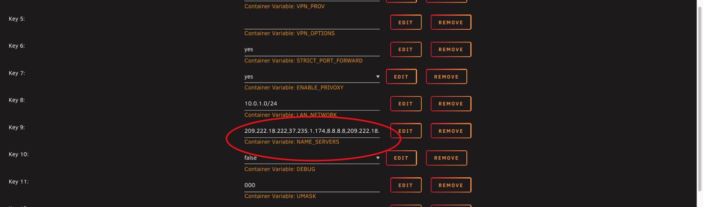

So you could use these for name resolution if you concerned. Just to add a bit more info to this, the risks of DNS leakage are minimised for this docker container, as we aren't routing all of your LAN traffic through this, it is used to purely route torrent traffic and possibly index site hits via privoxy, so information that could be gathered from your name server lookups wouldn't  be very specific to you as a individual, unlike when using the traditional Windows PIA client where ALL traffic is routed through for the host once the VPN is up, including websites you surf such as social sites etc, although even this is small/no risk as PIA do not log anything.

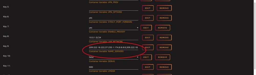

Could someone please tell me where I can find the value for the key "NAME_SERVERS"?  I checked all the files in appdata/binhex-delugevpn and could not find them.  Do I need to somehow create a new "key" on the "Update Container" docker setup page?  If so, could someone please walk me through doing this?  I would like to use the PIA name servers.
Thank you and kind regards,
craigr
Just change it in the docker settings. Docker tab>select the docker>edit the key.
Don't ask me how I didn't see that.
Thanks,
craigr
You probably have a blind spot right in front of your face like me.😁
