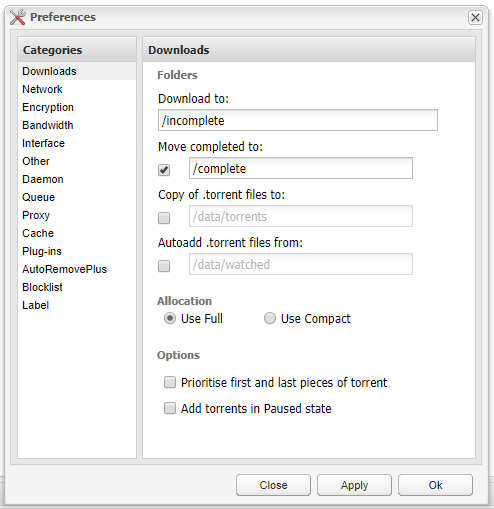

Ahh! Right. Sorry, I'm a total noob to all of this stuff. So I did delete the correct perms.txt and restarted the docker with the same result. I'm still stuck with deluge telling me "Status: Permission denied: /data/incomplete/" This location should be correct, I have the /data in the settings of the docket mapped to /mnt/user/Downloads/ and inside of there is my incomplete, complete, and unzipped_torrents directories. So, using /data/incomplete should be the correct pathing?

@BennyD From your docker run command post further up your mappings are: '/mnt/user/Downloads/':'/downloads
Have you changed this after you posted? please post a new docker run command and a screenshot of your Downloads settings in deluge. Be sure to redact username/password from the ducker run command.

Where it says "Download to:" needs to be set to /downloads if you docker run command is current.
Actually it should be /downloads/incomplete and /downloads/complete
Edited by strike
Well... I switched it to /downloads from your first response, and it's downloading stuff now without any errors so far, where is this directory defined? I have been trying to fix this on my own for a week now and it's driving me insane. I'm so confused, and I think I have gotten more confused googling! LOL
I have switched it to be /downloads/incomplete /downloads/complete. Seems to be working fine now...

I'm still confused as to where this /downloads directory is being set.
The docker config page. You told it to map /mnt/user/Downloads on the host to /downloads on the container.
Aha! Thanks! I was being confused because under the field I have the /mnt/user/Downloads defined it says "/data".
Thank you everyone for all of your help! GREATLY APPRECIATED!
Sorry to be such a rookie! I'm trying, I really am! Googling and some of the docker settings confuse me, the fields are very descriptive. Hehehe
@strike Yeah, I understand how the mapping works, I was just confused because it seems like every docker image, the directory your mapping to is just "labeled" as /data instead of in deluge that /data should really say /downloads, that's why I was so lost.
