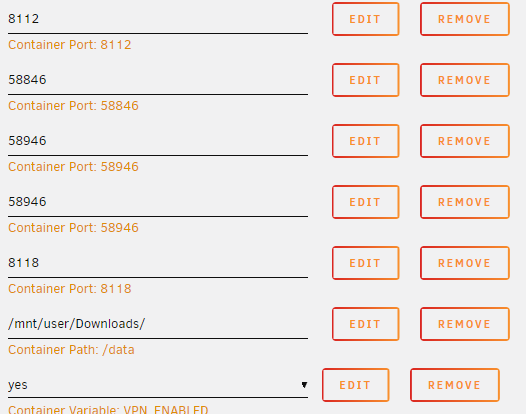

2 minutes ago, BennyD said:
Thanks! I was being confused because under the field I have the /mnt/user/Downloads defined it says "/data".
/data should have been the default predefined value in the docker template when you installed it. At least it used to be.
That's strange. Can you click the EDIT button on that path and screenshot what shows up?
What @wgstarks said. What you did was change the container path to /downloads but forgot to change the description so if still said /data
Yeah, you guys are correct. the description wasn't changed and it was totally screwing with me!
Just remember if you're using some of @binhex other containers like radarr etc, you'll have to do the same change in the volume mappings that you did with deluge. All of @binhex containers use /data as default, so if you don't change the mappings you'll have issues.
This situation has brought to light something that I think needs to be fixed. @bonienl, can you please take a look at the last several posts? Something needs to be changed to clarify the situation, but I'm not sure how to best approach it.
What's wrong.  The description is just that - a description of what the mapping is for.  If the template authors don't enter in a description in English, then it's on them, not up to unRaid.
Yes, but hiding the actual container mapping totally seems wrong to me. I know WHY the decision was made to hide it, but it seems like hiding it is causing at least as many issues as it solved. Maybe displaying it but still not allowing the edit without a button push? It's not like there is a lack of real estate on that screen. Maybe display like this:
Unraid Host /mnt/user/appdata/whatever = /preconfigured inside docker container
for path and port entries.
The description would still show below the text to the right side of the = and only the unraid host entry could be changed without pressing edit.
Basically I'm just wanting more description around those fields and exposing the container side for inspection but not for direct editing for path and port entries.
