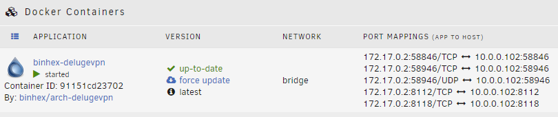

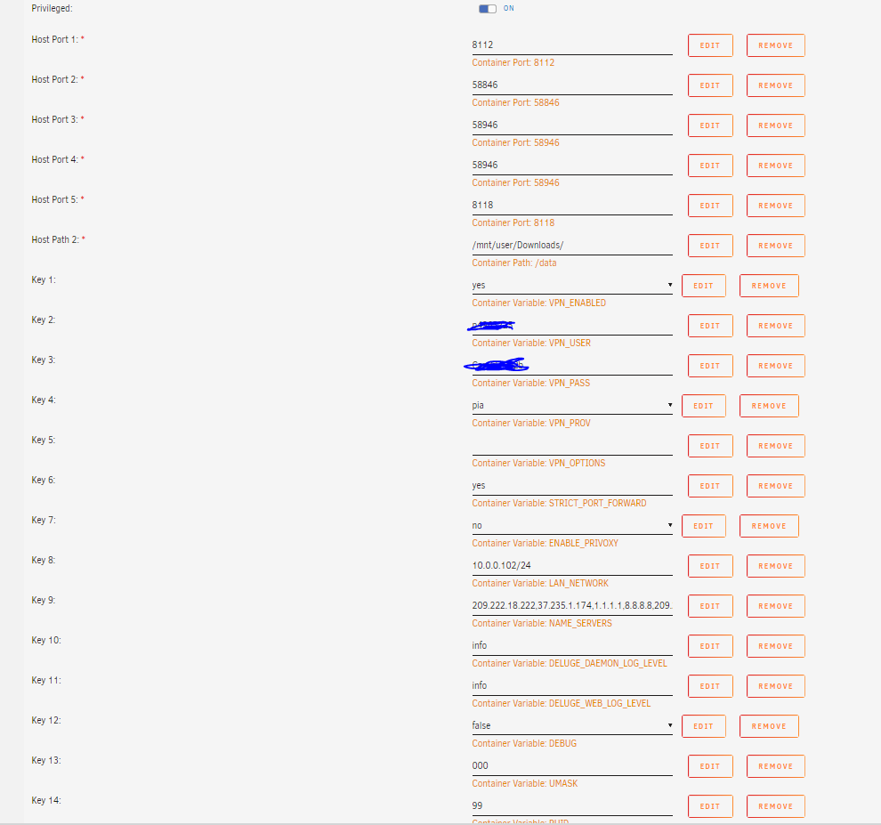

So a bunch of binhex containers are showing as "update ready". I updated deluge but the update said it was deleting the container instead. now its gone. what gives?
First Image Unable to access the Webgui see
2nd Image i have files in openvpn
3rd image i've changed it from customer all way to bridge and no luck
4th image the configurations

5 hours ago, darrenyorston said:
US Texas end point doesnt support port forwarding.
https://www.privateinternetaccess.com/helpdesk/kb/articles/how-do-i-enable-port-forwarding-on-my-vpn
Also check your LAN NETWORK config. I am assuming 10.0.0.102 is you unRAID server. If so change the fourth group to 0 and not 102.
