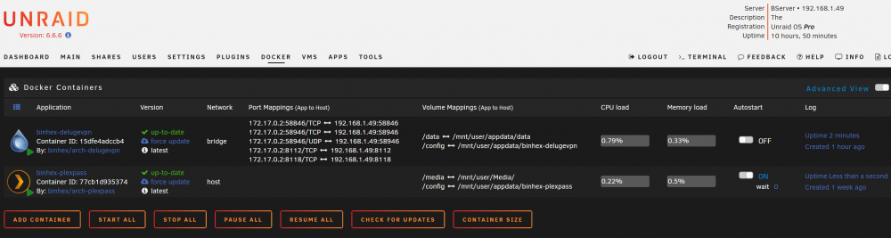

I had the GUI running fine for 2 days, but I added a static ip OpenVPN config file, restarted my unRAID server, and now can't load the GUI. Log just shows this error:
twisted.internet.error.CannotListenError: Couldn't listen on 0.0.0.0:8112: [Errno 98] Address already in use.
I tried removing the Docker and reinstalling, but getting the same error. Any tips? And no, I'm not running another instance of the docker AFAIK.
Edited by BBLV
there is only ever one reason for the above message, and that is the port being in use by another plugin/container/vm, your choice is change the port on the host side to be something different to 8112 (8113 for example) for this container or find out what is listening on port 8112 and shut it down or change that to something else.
The only other docker I have is your PlexPass docker (port 32400, WebGUI works just fine) and I'm still getting the "Address already in use error". I've cleared cache, reinstalled the docker, restarted my router, restarted my server, can't figure it out. Any way to clear all docker/port data and start fresh - do I just uninstall and delete the appdata folder for delugevpn?

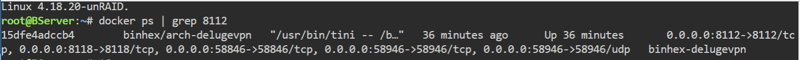

try this, issue the following via the console of the host (not the containers console):-
docker ps | grep 8112
it will display containers that are running that are using port 8112.
Here's the result
1 minute ago, BBLV said:
Here's the result
so there ya go you already have this container running, and its using port 8112 as expected, thats why you cant create another container with the same port, so either work out why this isnt working or delete it and create a new container, my advise is to try and work out why you cant access the web ui for the existing container, if you want to do this then follow the steps in the link below:-
https://forums.unraid.net/topic/44108-support-binhex-general/?do=findComment&comment=435831

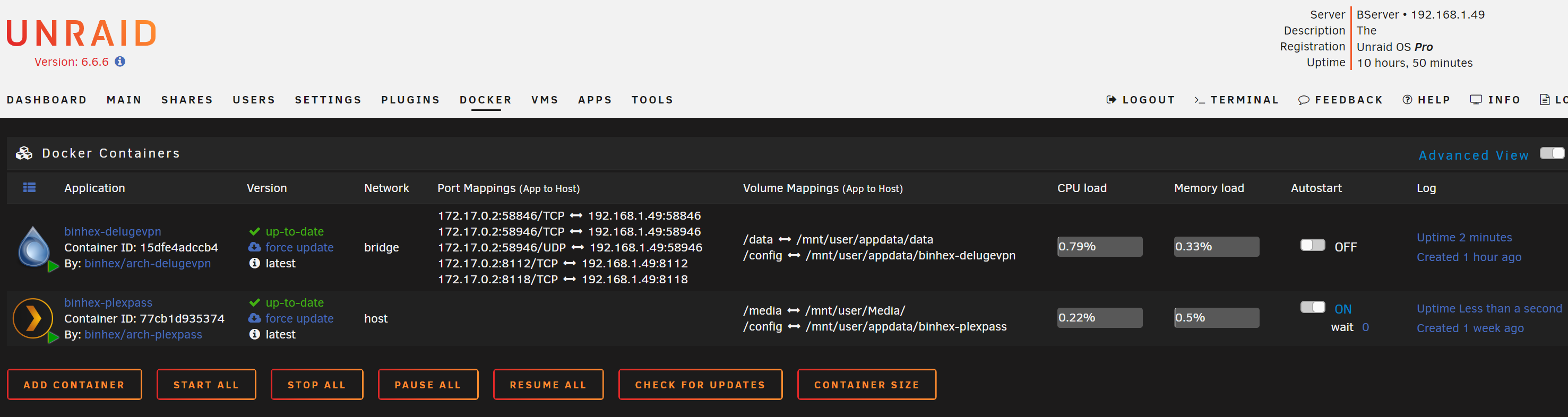

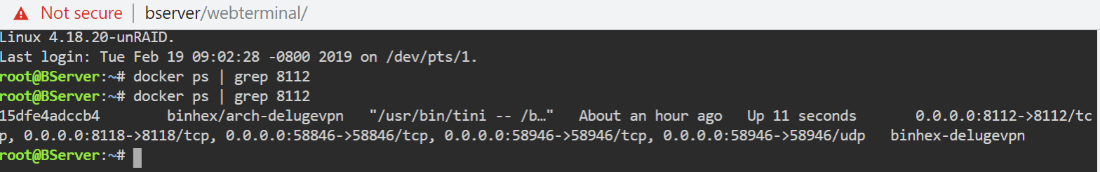

That was with the docker running. As soon as I stop the docker and run the same command line, it returns nothing. Here is the screenshot - first line is without the docker running, second line is WITH the docker running.
I also included a screenshot of my docker page for reference. Maybe something funky is going on (this is my first dive into unRAID and I'm just figuring out all of its quirks and nuances, but have watched an insane amount of YT videos and spent hours upon hours in the forums researching).
Thanks for all the help binhex, donation coming your way!
