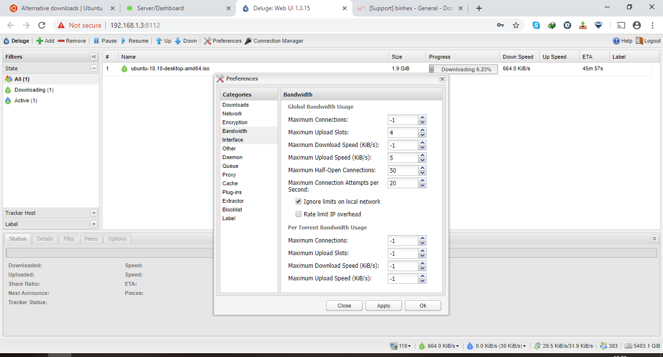

So after using CP and Transmission for years, I decided t switch t o delugevpn after watching spaceinvader's video, everything seems to be working and set up with PIA but when I use the same example download of unbuntu I am not even getting 1mb/s Netherlands is no longer available in the openvpn so tried
DE Berlin
DE Frankfurt
Switzerland (current openvpn cfg)
But same slow speeds, got privoxy enabled on my Win10 VM and even using speedtest.net is super slow Ping ms 122 Download Mbps 0.36 Upload Mbps 1.84
Havent got around to checking SABnzbd but set up Radarr and Sonarr to use proxy so I am guessing they will be equally slow. Any suggestions on what I can do, also tried a whole other bunch of servers from this list https://www.privateinternetaccess.com/helpdesk/kb/articles/how-do-i-enable-port-forwarding-on-my-vpn
Not sure if its a delugevpn issue or PIA issue - Now using Switerland but still no better.
Sabnzbd is maxing out my connection which is correct because its not usng VPN and uses SSL
Looks like its possibly deluge which is the issue, not sure if I need to configure proxy in preferences, its all set to none.
If I disable Proxy on my VM I get normal download speeds on speedtest ~300Mbps, enable proxy using 192.168.1.3 Port 8118 downloads speeds drop to ~9Mbps
Ubuntu downloading in deluge is around ~342.2 KiB/s

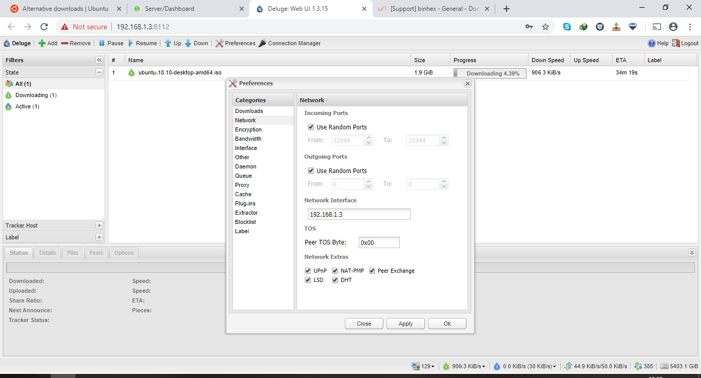

I have checked everything and as far as I can tell its looks ok, I am going to download the PIA app directly to my laptop and win10 vm to rule VPN issue or just a deluge config issue.

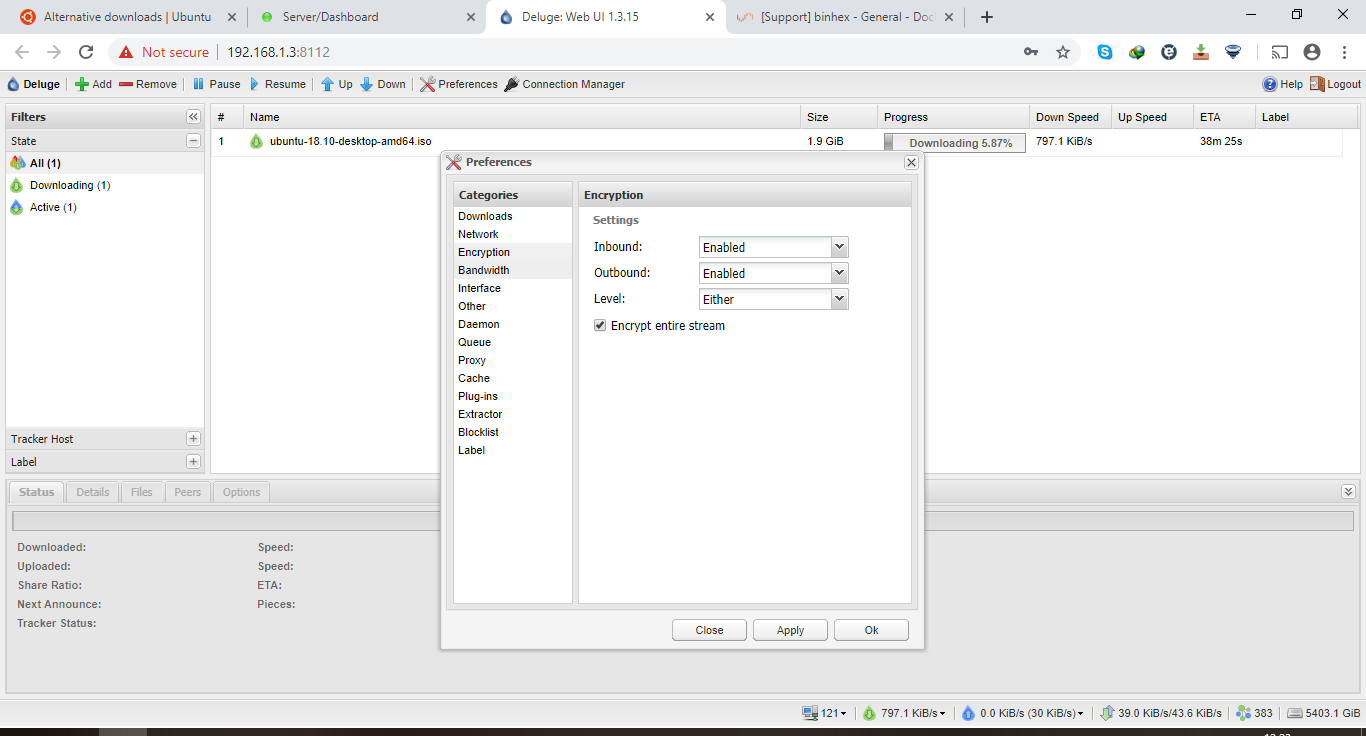

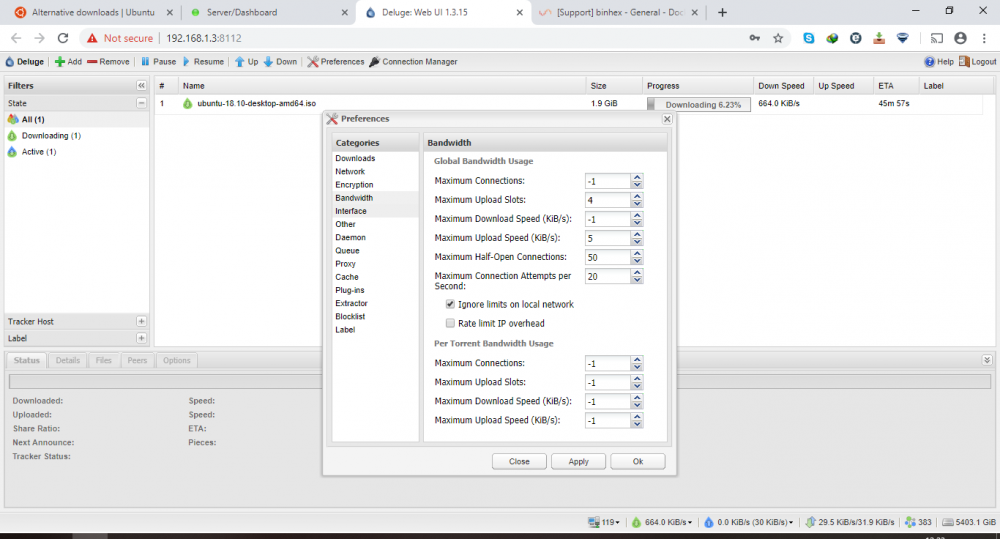

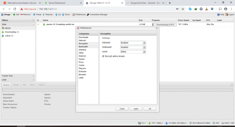

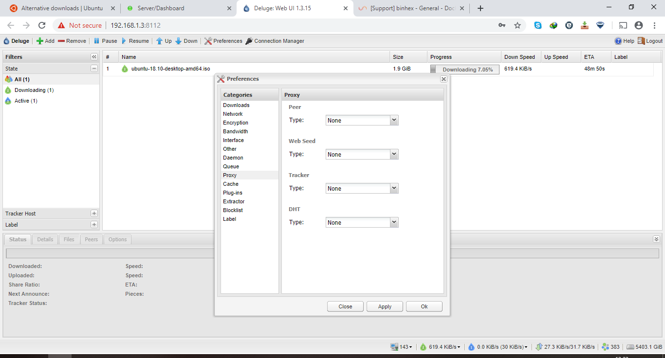

I have attached some screenshot if you dont mind checking to see if there is anything wrong, but then I am also thinking this should be affect privoxy and speeds I am getting through Chrome ?
@bally12345 two issues i can see from your screenshot:-
1. upload lmit of 5KB/s - this is WAY too low, remember torrent protocol uses tit-for-tat, you wont get high download rates without giving back, increase this to around 70% of your max upload rate for your line.
2. incoming port set to random - i cant remember which vpn provider you are with, but without a working incoming port your speeds are going to be very low, you need to sort this, each vpn provider is different, for PIA i set this up for you.
21 minutes ago, binhex said:
[mention=62199]bally12345[/mention] two issues i can see from your screenshot:-
1. The upload limit I changed from unlimited to 5 now too 300 just to test.
2. Unchecked randomize ports
Still slow
Edited by bally12345

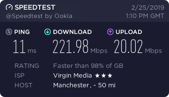

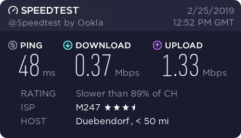

Speedtest results
2 minutes ago, binhex said:
you may of unchecked randomize incoming port, BUT have you allocated it a working incoming port from your vpn provider? please be aware of this Q16.:-
https://forums.unraid.net/topic/44108-support-binhex-general/?do=findComment&amp;comment=433612
I am using PIA (Switzerland) STRICT_PORT_FORWARD is set to yes so it should be automatic is that correct? Might just restart the docker
Yes that is automatic, you will need to restart in order for the incoming port to be configured

Yeh still no good, after restarting the docker was getting good speeds on speedtest on my VM but deluge was still slow. Might try another app and see what happens.
Sent from my SM-G930F using Tapatalk
did you check to see if deluge did indeed have a dynamically allocated incoming port?
