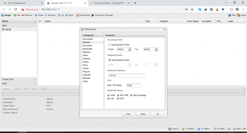

9 minutes ago, bally12345 said:
Really simple check, disabled VPN from container settings, restarted and download at 45MB/s
enable VPN and hit 1MB/s
I deleted everything and started again, so pretty vanilla setup other than entering the PIA credentials and 3 files to the openvpn folder now using FRANCE

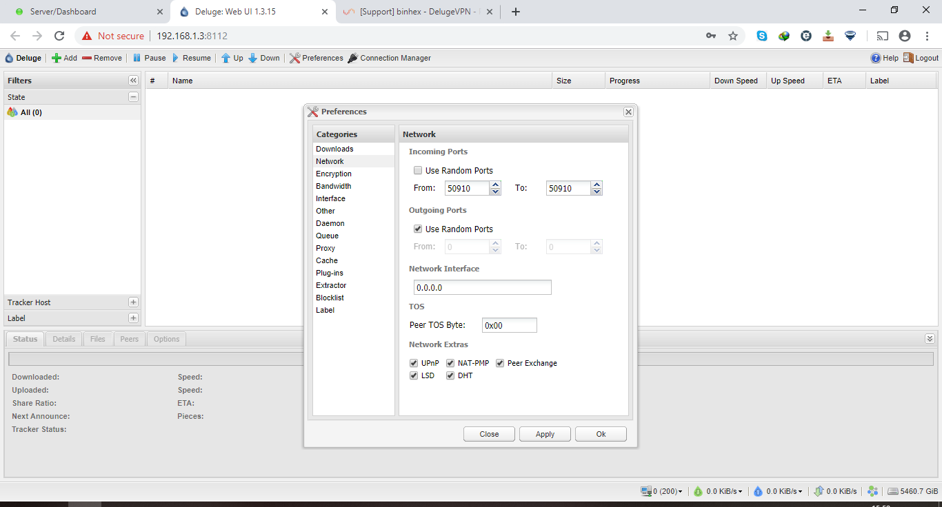

screenshot for the incoming port please, obviously with vpn enabled
Edited by binhex
Network interface is now showing as 0.0.0.0 is that correct?
yep thats normal, looks like the incoming port is now set correctly, and you are still limited to 1MB/s ?, i see you have redone things so double check upload rate/download rate etc as per my earlier post:-

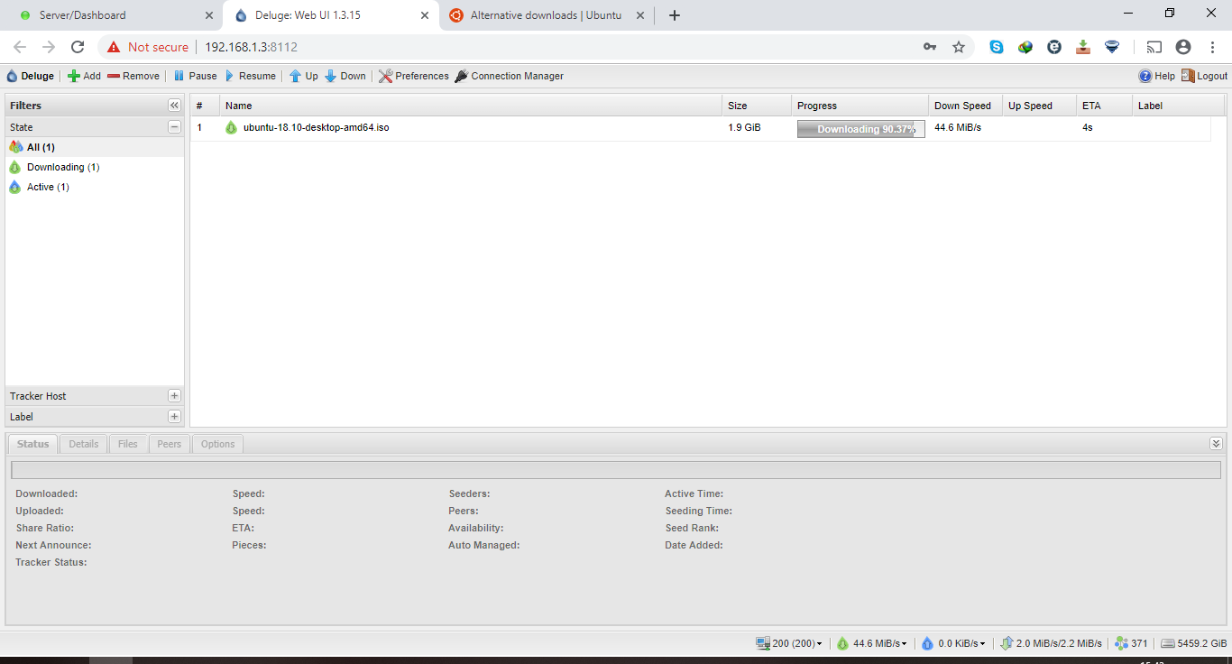

hmm ok new one on me, fyi i did a quick torrent download of the same torrent as you, ubuntu 18.10 desktop and hit 3MB/s no probs, which is not too bad for my connection, thats without the above tweak *shrug*, glad you got something that works for you, i will add this to the faq.
