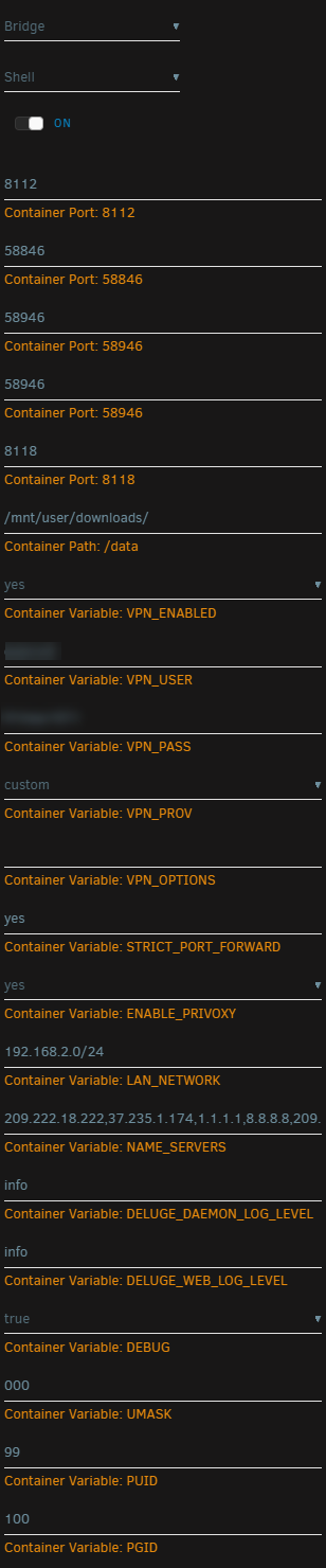

Having the issue where Deluge will not load the WebUi portal if VPN is set to 'yes'. Odd thing is no errors in logs (says WebUi started) and it was working for several days without any changes just stopped. If the VPN is set to 'no' the page loads immediately. I have tested setting to force port forwarding and appropriate forwarding server but same issue, was previously not using port forwarding and speed was fine.
#probably worth noting that I went to Deluge as Qbittorrent stopped the same way after working for months. Deluge is soo much better but why the random stop I'm not sure
Update:
Somehow the subnet was change, no idea how but once I noticed and correct working as expected.

Using the OS X PIA app with killswitch on and IP checked to make sure, I DL'ed that file above at 5MB/s using the PIA client. Changed to Czech Republic and it was MUCH faster than France.
Not sure if the app would be using OpenVPN or not..
Changed the Deluge VPN to Czech republic and restarted Deluge, just as slow.
Or is it a port issue? When you change locations with PIA you get a new forwarded port. Do you put this in the WebGUI Deluge preferences incoming and outgoing ports or in the Docker settings?
Also couldn't get wget to work:
Total Download Size:   0.61 MiB
Total Installed Size:  2.81 MiB
:: Proceed with installation? [Y/n] y
:: Retrieving packages...
error: failed retrieving file 'wget-1.20.1-3-x86_64.pkg.tar.xz' from mirror.pseudoform.org : The requested URL returned error: 404
error: failed retrieving file 'wget-1.20.1-3-x86_64.pkg.tar.xz' from archlinux.dynamict.se : The requested URL returned error: 404
error: failed retrieving file 'wget-1.20.1-3-x86_64.pkg.tar.xz' from arch.mirror.far.fi : Protocol "rsync" not supported or disabled in libcurl
error: failed retrieving file 'wget-1.20.1-3-x86_64.pkg.tar.xz' from mirror.pseudoform.org : Protocol "rsync" not supported or disabled in libcurl
warning: failed to retrieve some files
error: failed to commit transaction (download library error)
Errors occurred, no packages were upgraded.
7 minutes ago, Chamzamzoo said:
Could it be the type of VPN that VM is slow with?
Yeah sorry, as I said that didn't work. You can probably spend time to get wget working in the container - but it might not be worth it. It ~might~ be a different type of encryption being used in the application versis the .ovpn file that deluge container is using - binhex has a help thread where he mentions selecting a different algorithm if it's supported by the vpn endpoint, but I've not got any experience with that.
When you change location (or even reload the container) you will get a new port and likely a new IP. Binhex is very clever and his container automatically negotiates and configures this port inside deluge for you (as long as you're using PIA) - so you don't need to touch it.
Edited by jmbrnt
I see, that certainly is clever :)
Opening the ovpn files for the app and the one I uploaded to app-data, they are both using aes-128-cbc and other the settings are the same.
What do you do with the incoming and outgoing port settings in Deluge, they need a value? Set it to random? or is it irrelevant whatever you put in it?
