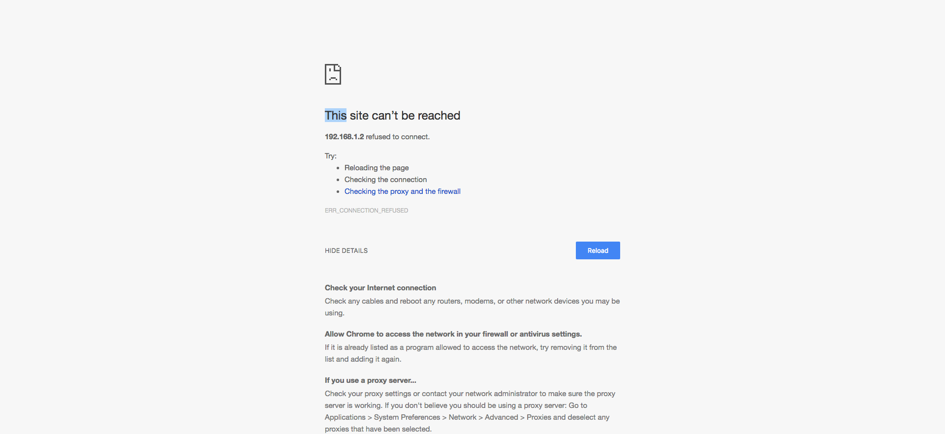

hey everyone - I am new to this and I installed the delugevpn docker and when i click on it and choose webUI it will not connect.  I get ERR_CONNECTION_REFUSED.  Is there some other configuration that needs to happen to enable the web ui?
You probably haven't configured the LAN_NETWORK variable. Change the view to "Advanced" and at it there. Make the variable match your IP range, i,e, 192.168.1.0 and add "/24" to the end, final result should be something like:
192.168.1.0/24
the last number should be ".0" and the rest need to match your server IP.
If your server is 10.1.10.123 then the variable should be set to 10.1.10.0/24
Thank you for that tip.  I didn't see the advanced option before.  Now I see the lan_network option.  It was set to 192.168.1.0/24
My server ip is 192.168.1.2
That should be correct right?
What else could be preventing me from seeing the web ui?
nevermind - i got it working...
VPN_PROV was not properly set.  once i fixed that, the web ui loaded right up.
thank you!!
