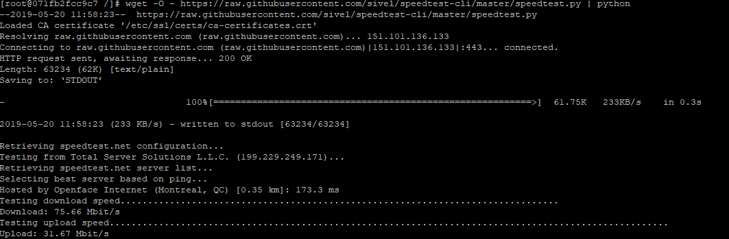

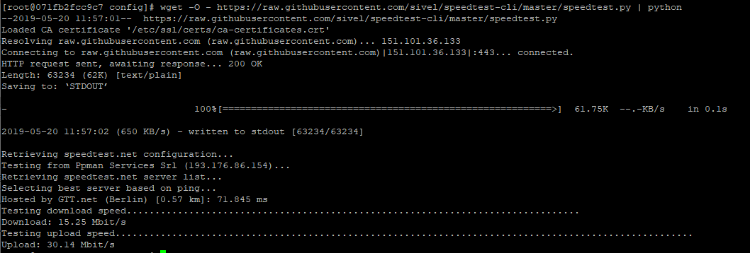

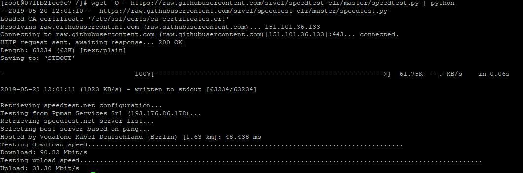

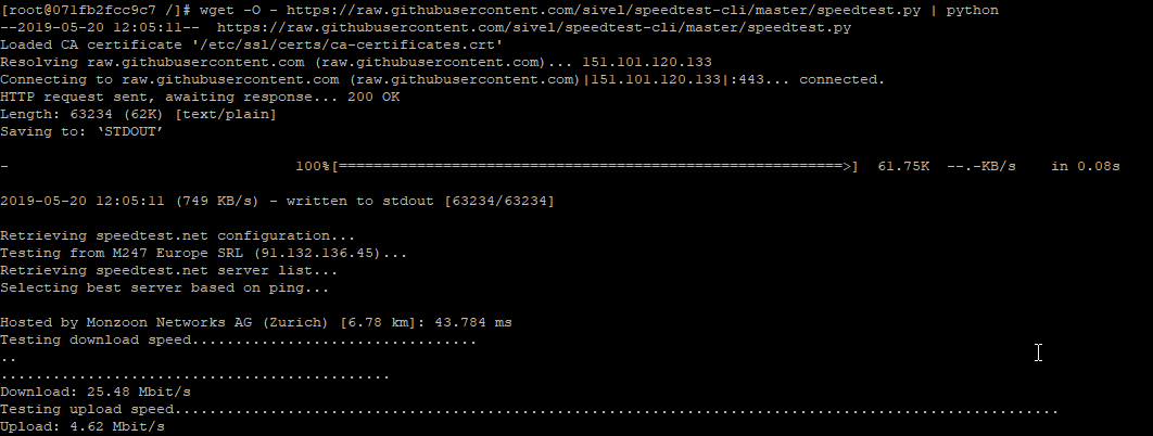

So, I had a look a the actual speed i'm getting over the different VPN servers. In the attachement you can see the speed ranges from terrible (15Mbit) to pretty good (90Mbit). This is tested straight from the container. HOWEVER, my deluge still seems "capped" at around 2.4MiB/s.
What would be the next step in troubleshooting this issue?

firstly test with a stable swarm size, ubuntu iso downloads are always a good choice, lots of high speed peers, load this in deluge and see what you get:-
http://releases.ubuntu.com/19.04/ubuntu-19.04-desktop-amd64.iso.torrent

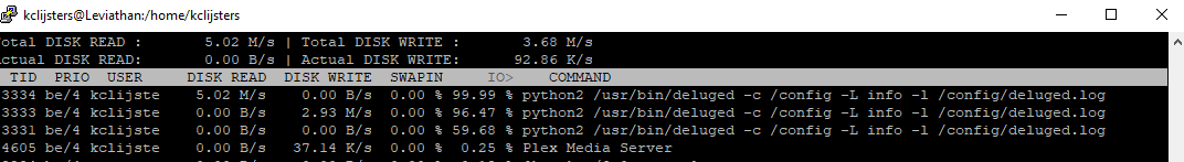

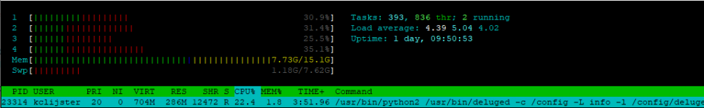

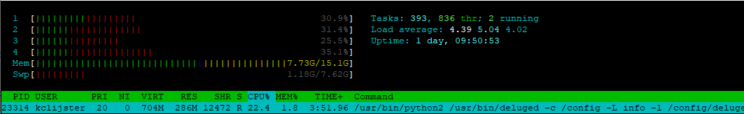

I've added the ubuntu image to deluge and got  peak of about 2.8MiB. But still am getting consistent sub 2MiB speeds, even on torrents with 2000+ peers. It's almost like there is a cache that keeps filling up, since as soon as the speed hits the 'cap', it throttles down to sub 1MiB/s only to creep back up to 2.8MiB/s and throttle again. This is now very noticeable with the ubuntu torrent.
I also noticed high IO usage from the deluge instance. Might this be the limiting factor?

Just now, itractus said:
I think we are finally getting somewhere.

ok, sorry to bang on about this, but you have definitely done all the steps in the slow speeds faq then right?, so reduced upload rate, disabled ') Rate limit overhead' etc etc? this can all make a significant difference.
Yes, I understand the steps in the FAQ, and have applied them where needed.

ok cool, so your I/O def does look like a possible cause of the speed issues, what are you writing incompletes to?
So right now, the Incomplete folder is an NFS share mounted on the docker host. I haven't had any issues with this running a different deluge container, however I can see that with this specific configuration there is an issue. I use the default mount options for the share. As you can see the CPU load is nothing crazy, and this is with 10 active torrents 300+ in queue
Edited by itractus
1 minute ago, itractus said:
So right now, the Incomplete folder is an NFS share mounted on the docker host. I haven't had any issues with this running a different deluge container, however I can see that with this specific configuration there is an issue. I use the default mount options for the share:
yes i would suspect this is the bottleneck, if you can (at least temporarily) try changing the /data container volume mount to point at a location on the host, so NOT a nfs or smb share, if speeds suddenly shoot up then you know thats the issue.
After doing some testing, setting the download folder to the local host DID remove the insane IO load i was having. So for that I will be troubleshooting my NFS config. Possibly I'm using some flags that are not optimal for torrenting.
HOWEVER, it did not increase my bandwidth. I did notice less "flushing" to the local drive, but still only hit top speeds of 2.5MiB/s.
I will do some more research and get back to you guys after I find out the exact issue.
