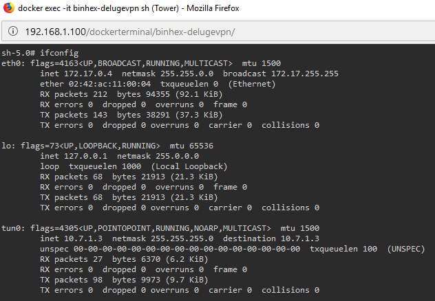

ifconfig br0
br0: flags=4163<UP,BROADCAST,RUNNING,MULTICAST>  mtu 1500
        inet 192.168.1.8  netmask 255.255.255.0  broadcast 192.168.1.255
        inet6 fe80::6821:7dff:fe0b:679a  prefixlen 64  scopeid 0x20<link>
        ether 00:25:90:50:30:0b  txqueuelen 1000  (Ethernet)
        RX packets 533719233  bytes 1710461864114 (1.5 TiB)
        RX errors 0  dropped 0  overruns 0  frame 0
        TX packets 99910465  bytes 9144509531 (8.5 GiB)
        TX errors 0  dropped 0 overruns 0  carrier 0  collisions 0
4 hours ago, anylettuce said:
changed it back to 192.168.1.0 and nothing
ifconfig br0
br0 is not supported in this container, please change to bridge or host.

ExpressVPN is not going to work well with torrenting due to the fact that they don't support port forwarding. Even if you were able to download anything it will be painfully slow and it would only work on public trackers. Do yourself a favor and change to a provider that supports port forwarding.
Hey guys, I'm having what I think is a networking issue. I had everything up and running fine for a long time, however I was troubleshooting an unrelated vm issue last week, and I think I mucked up a network setting somewhere. I can get my container to start, and connect to my vpn provider, but nothing will download, and all the trackers timeout. In the console I can see the connection, but I cannot ping anything outside of my network. My other containers seem to be functioning normally. Any thoughts? I am probably missing something super obvious.notun.png.40a87cad1f08b1cc64795b07bce136ee.png
deluge_log.txt
Edited by Biloxi_1
looking at your log i would say your vpn provider is having issues:-
Fri Jun 7 07:17:14 2019 TLS Error: TLS key negotiation failed to occur within 60 seconds (check your network connectivity)
try a different endpoint, or contact your vpn provider and tell them you are having TLS key negotiation failing.
Thank you for your response. I did try a different end point, and received the same results. I noticed while troubleshooting that if I swap the network type in the settings from "bridge" to "custom: br0" the torrents will start downloading, but I i cannot reach webui in that configuration.
