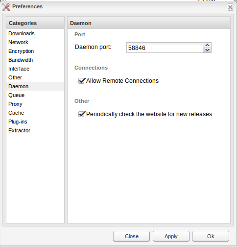

I'm having issues connecting CouchPotato to deluge.
Been down many avenues and am now sure that it is that the daemon is not running.
How can I start the daemon, and is there a way to make it start with delugevpn. I didn't seem to have this issue with my old installation, and nothing has change as far as I know. :/
Thanks in advance.
It should already be started, you simply need to check allow remote connections under preferences in the webui (see attachment). Then in CouchPotato this is what I have setup for deluge (see attachment). I use the IP address of UnRAID plus the port of the daemon and the user I defined in the auth file according to Q6 in the OP.
Thanks in advance.
I've checked all this many times. The daemon is not running. I get connection failed, which is 100% not to do with my ip or port. The auth file and details in CP are correct. Using a different version of CP gives the same issue. I am positive it is the Daemon.
