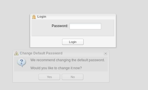

So I've been trying to figure this out for a couple days. This my first time setting up delugevpn on this machine, so I don't have any previous config files or anything. My issue is that once connected to the webui, I can't figure out what password it wants me to enter. I've checked the auth file and the password in there is a random string of characters. It does not work, even when copied and pasted. If I edit the file and add admin:deluge:10 and restart the container, it still does not work. I have tried deleting the file, and recreating it with only admin:deluge:10, but after restarting the docker container, it appends a new entry to it with a new random password, that again does not work.
Here is my current auth file
admin:deluge:10
localclient:e55c8d0f44919b92be1c397663f1e2670063f729:10
and here is my supervisord.log
Created by...
___.   .__       .__
\_ |__ |__| ____ |  |__   ____ ___  ___
 | __ \|  |/    \|  |  \_/ __ \\  \/  /
 | \_\ \  |   |  \   Y  \  ___/ >    <
 |___  /__|___|  /___|  /\___  >__/\_ \
   https://hub.docker.com/u/binhex/
2019-07-22 18:25:14.235708 [info] System information Linux 327ef426dad0 5.0.0-20-generic #21-Ubuntu SMP Mon Jun 24 09:32:09 UTC 2019 x86_64 GNU/Linux
2019-07-22 18:25:14.259674 [info] PUID defined as '1000'
2019-07-22 18:25:14.284497 [info] PGID defined as '130'
2019-07-22 18:25:14.323747 [info] UMASK defined as '000'
2019-07-22 18:25:14.346967 [info] Permissions already set for volume mappings
2019-07-22 18:25:14.373322 [info] DELUGE_DAEMON_LOG_LEVEL defined as 'info'
2019-07-22 18:25:14.396998 [info] DELUGE_WEB_LOG_LEVEL defined as 'info'
2019-07-22 18:25:14.423869 [info] VPN_ENABLED defined as 'yes'
2019-07-22 18:25:14.454512 [info] OpenVPN config file (ovpn extension) is located at /config/openvpn/CA Toronto.ovpn
dos2unix: converting file /config/openvpn/CA Toronto.ovpn to Unix format...
2019-07-22 18:25:14.489628 [info] VPN remote line defined as 'remote ca-toronto.privateinternetaccess.com 1198'
2019-07-22 18:25:14.514545 [info] VPN_REMOTE defined as 'ca-toronto.privateinternetaccess.com'
2019-07-22 18:25:14.540598 [info] VPN_PORT defined as '1198'
2019-07-22 18:25:14.567639 [info] VPN_PROTOCOL defined as 'udp'
2019-07-22 18:25:14.591472 [info] VPN_DEVICE_TYPE defined as 'tun0'
2019-07-22 18:25:14.615159 [info] VPN_PROV defined as 'pia'
2019-07-22 18:25:14.639732 [info] LAN_NETWORK defined as '192.168.1.0/24'
2019-07-22 18:25:14.663797 [info] NAME_SERVERS defined as '209.222.18.222,1.1.1.1,8.8.8.8,209.222.18.218,1.0.0.1,8.8.4.4'
2019-07-22 18:25:14.687306 [info] VPN_USER defined as 'PIA_USER'
2019-07-22 18:25:14.710806 [info] VPN_PASS defined as 'PIA_PASS'
2019-07-22 18:25:14.734295 [info] VPN_OPTIONS not defined (via -e VPN_OPTIONS)
2019-07-22 18:25:14.757749 [info] STRICT_PORT_FORWARD defined as 'yes'
2019-07-22 18:25:14.781409 [info] ENABLE_PRIVOXY defined as 'yes'
2019-07-22 18:25:14.805321 [info] Starting Supervisor...
2019-07-22 18:25:14,986 INFO Included extra file "/etc/supervisor/conf.d/delugevpn.conf" during parsing
2019-07-22 18:25:14,986 INFO Set uid to user 0 succeeded
2019-07-22 18:25:14,990 INFO supervisord started with pid 6
2019-07-22 18:25:15,991 INFO spawned: 'start-script' with pid 147
2019-07-22 18:25:15,992 INFO spawned: 'watchdog-script' with pid 148
2019-07-22 18:25:15,992 INFO reaped unknown pid 7
2019-07-22 18:25:15,997 DEBG 'start-script' stdout output:
[info] VPN is enabled, beginning configuration of VPN
2019-07-22 18:25:15,997 INFO success: start-script entered RUNNING state, process has stayed up for > than 0 seconds (startsecs)
2019-07-22 18:25:15,997 INFO success: watchdog-script entered RUNNING state, process has stayed up for > than 0 seconds (startsecs)
2019-07-22 18:25:15,999 DEBG 'watchdog-script' stderr output:
dos2unix:
converting file /config/core.conf to Unix format...
2019-07-22 18:25:16,038 DEBG 'start-script' stdout output:
[info] Default route for container is 172.17.0.1
2019-07-22 18:25:16,041 DEBG 'start-script' stdout output:
[info] Adding 209.222.18.222 to /etc/resolv.conf
2019-07-22 18:25:16,044 DEBG 'start-script' stdout output:
[info] Adding 1.1.1.1 to /etc/resolv.conf
2019-07-22 18:25:16,047 DEBG 'start-script' stdout output:
[info] Adding 8.8.8.8 to /etc/resolv.conf
2019-07-22 18:25:16,050 DEBG 'start-script' stdout output:
[info] Adding 209.222.18.218 to /etc/resolv.conf
2019-07-22 18:25:16,052 DEBG 'start-script' stdout output:
[info] Adding 1.0.0.1 to /etc/resolv.conf
2019-07-22 18:25:16,055 DEBG 'start-script' stdout output:
[info] Adding 8.8.4.4 to /etc/resolv.conf
2019-07-22 18:25:16,101 DEBG 'start-script' stdout output:
[info] Attempting to load tun kernel module...
2019-07-22 18:25:16,102 DEBG 'start-script' stderr output:
modprobe: FATAL: Module tun not found in directory /lib/modules/5.0.0-20-generic
2019-07-22 18:25:16,102 DEBG 'start-script' stdout output:
[warn] Unable to load tun kernel module using modprobe, trying insmod...
2019-07-22 18:25:16,103 DEBG 'start-script' stderr output:
insmod: ERROR: could not load module /lib/modules/tun.ko: No such file or directory
2019-07-22 18:25:16,104 DEBG 'start-script' stdout output:
[warn] Unable to load tun kernel module, assuming its dynamically loaded
2019-07-22 18:25:16,111 DEBG 'start-script' stdout output:
[info] Attempting to load iptable_mangle module...
2019-07-22 18:25:16,112 DEBG 'start-script' stderr output:
modprobe: FATAL: Module iptable_mangle not found in directory /lib/modules/5.0.0-20-generic
2019-07-22 18:25:16,112 DEBG 'start-script' stdout output:
[warn] Unable to load iptable_mangle module using modprobe, trying insmod...
2019-07-22 18:25:16,113 DEBG 'start-script' stderr output:
insmod: ERROR: could not load module /lib/modules/iptable_mangle.ko: No such file or directory
2019-07-22 18:25:16,114 DEBG 'start-script' stdout output:
[warn] Unable to load iptable_mangle module, you will not be able to connect to the applications Web UI or Privoxy outside of your LAN
[info] unRAID/Ubuntu users: Please attempt to load the module by executing the following on your host: '/sbin/modprobe iptable_mangle'
[info] Synology users: Please attempt to load the module by executing the following on your host: 'insmod /lib/modules/iptable_mangle.ko'
2019-07-22 18:25:16,133 DEBG 'start-script' stdout output:
[info] Docker network defined as    172.17.0.0/16
2019-07-22 18:25:16,136 DEBG 'start-script' stdout output:
[info] Adding 192.168.1.0/24 as route via docker eth0
2019-07-22 18:25:16,137 DEBG 'start-script' stdout output:
[info] ip route defined as follows...
default via 172.17.0.1 dev eth0
172.17.0.0/16 dev eth0 proto kernel scope link src 172.17.0.2
192.168.1.0/24 via 172.17.0.1 dev eth0
2019-07-22 18:25:16,138 DEBG 'start-script' stdout output:
2019-07-22 18:25:16,170 DEBG 'start-script' stdout output:
[info] iptables defined as follows...
2019-07-22 18:25:16,171 DEBG 'start-script' stdout output:
-P INPUT DROP
-P FORWARD DROP
-P OUTPUT DROP
-A INPUT -i tun0 -j ACCEPT
-A INPUT -s 172.17.0.0/16 -d 172.17.0.0/16 -j ACCEPT
-A INPUT -i eth0 -p udp -m udp --sport 1198 -j ACCEPT
-A INPUT -i eth0 -p tcp -m tcp --dport 8112 -j ACCEPT
-A INPUT -i eth0 -p tcp -m tcp --sport 8112 -j ACCEPT
-A INPUT -s 192.168.1.0/24 -i eth0 -p tcp -m tcp --dport 58846 -j ACCEPT
-A INPUT -s 192.168.1.0/24 -d 172.17.0.0/16 -i eth0 -p tcp -j ACCEPT
-A INPUT -p icmp -m icmp --icmp-type 0 -j ACCEPT
-A INPUT -i lo -j ACCEPT
-A OUTPUT -s 172.17.0.0/16 -d 172.17.0.0/16 -j ACCEPT
-A OUTPUT -o eth0 -p udp -m udp --dport 1198 -j ACCEPT
-A OUTPUT -o eth0 -p tcp -m tcp --dport 8112 -j ACCEPT
-A OUTPUT -o eth0 -p tcp -m tcp --sport 8112 -j ACCEPT
-A OUTPUT -d 192.168.1.0/24 -o eth0 -p tcp -m tcp --sport 58846 -j ACCEPT
-A OUTPUT -s 172.17.0.0/16 -d 192.168.1.0/24 -o eth0 -p tcp -j ACCEPT
-A OUTPUT -p icmp -m icmp --icmp-type 8 -j ACCEPT
-A OUTPUT -o lo -j ACCEPT
-A OUTPUT -o tun0 -j ACCEPT
2019-07-22 18:25:16,172 DEBG 'start-script' stdout output:
[info] Starting OpenVPN...
2019-07-22 18:25:16,177 DEBG 'start-script' stdout output:
Mon Jul 22 18:25:16 2019 WARNING: file 'credentials.conf' is group or others accessible
Mon Jul 22 18:25:16 2019 OpenVPN 2.4.7 [git:makepkg/2b8aec62d5db2c17+] x86_64-pc-linux-gnu [SSL (OpenSSL)] [LZO] [LZ4] [EPOLL] [PKCS11] [MH/PKTINFO] [AEAD] built on Feb 19 2019
Mon Jul 22 18:25:16 2019 library versions: OpenSSL 1.1.1c  28 May 2019, LZO 2.10
2019-07-22 18:25:16,178 DEBG 'start-script' stdout output:
[info] OpenVPN started
Mon Jul 22 18:25:16 2019 NOTE: the current --script-security setting may allow this configuration to call user-defined scripts
2019-07-22 18:25:16,180 DEBG 'start-script' stdout output:
Mon Jul 22 18:25:16 2019 TCP/UDP: Preserving recently used remote address: [AF_INET]172.98.67.88:1198
Mon Jul 22 18:25:16 2019 UDP link local: (not bound)
Mon Jul 22 18:25:16 2019 UDP link remote: [AF_INET]172.98.67.88:1198
2019-07-22 18:25:16,372 DEBG 'start-script' stdout output:
Mon Jul 22 18:25:16 2019 [0f6bb741d8cfe08e9d67c43afe693fcb] Peer Connection Initiated with [AF_INET]172.98.67.88:1198
as you can tell I can't find out why no passwords will authenticate

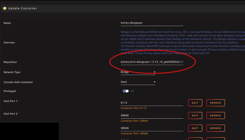

I am relatively new to unRAID and plug-ins, but Im not too new on Linux. Right now I'm having a dilemma adding the webAPI plug-in to Deluge.
I am running the latest pull from docker, this is my only issue I'm experiencing right now with it.
When I go to add the .egg file, it loads as [object File], but never appears in the plug-ins list to select. I also cannot stop my daemon, as I was figuring I'd just restart the daemon in the deluge web GUI, but it gives me 'An error occured'. I am on the latest unRAID version as well(6.7.2).
Im hoping there is another work around to this, as Im trying to get it to interface with Organizr V2.
Also here is someone on the github page having the same issue, maybe their description makes more sense.
Github link
Edited by feyded1020
Link to comment
Github link
Just from looking at that GitHub link, it appears that you are trying to use a python 2 plugin with the latest version of Deluge which uses python 3. This plugin (along with more than a few others) must be updated to python 3 before you can use it. You can use tagging in the docker configuration to roll back to a previous (python 2) version of Deluge if you want.
The full tag doesn't show in the screenshot, but it's binhex/arch-delugevpn:1.3.15_18_ge050905b2-1-04
Edit: Some people have lost torrents when rolling back. Be sure you have a backup of the docker to restore from.
Edited by wgstarks
  • Upvote 1

21 minutes ago, bugster said:
Hi all.
Just installed binhex-delugevpn and for some reason I can't change the WebGui default password. I tried a fresh install and still can't get in via the WebGui. See attached.
Thanks
Default password is deluge. Have you tried entering that and change the default password from the preferences menu?
Link to comment
41 minutes ago, qbone said:
Hmm ok. Sounds like it might be a permissions issue then. Does it save all other preferences you change in Deluge?
This is a new install. I haven't been able to get into the program to make any changes.
Edited by bugster
Link to comment
9 minutes ago, wgstarks said:
How are you trying to access the app? I don’t remember the webUI ever asking me to change the password.
Via the address: http://192.168.1.52:8112
- I just removed it and deleted /mnt/user/appdata/binhex-delugevpn.
- Did a fresh installed version "2.0.3" changing the /data path and adding my PIA username and password.
- Copied the files from PIA to the openvpn folder.
- Started the container and it doesn't shows any errors
I'm going to the WebGui http://192.168.1.52:8112/ and now I'm using deluge as the password but this time the Login window keeps coming up asking me for the password. This time the change default password window from the screen above is not coming up but it won't take the password
Edited by bugster
