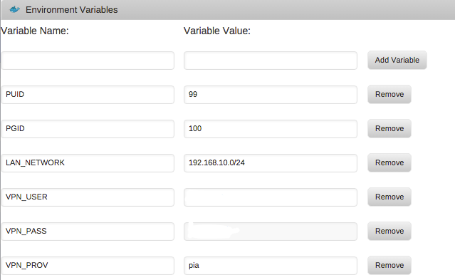

I'm having some issues with the PIA portion of this Docker. I added in the 4 variables as specified but using the test torrent it shows my normal public IP.
Is there a way to check for errors? I don't see anything in the logs you get from clicking on the Docker in unRaid.

Can you post your container log file and your environmental variable settings so I can make sure everything is set correctly? Also post your servers local IP and subnet so I can make sure the LAN_NETWORK variable is set correctly. Be sure to remove the VPN credentials from the container log and environment variables before posting.
Where do I grab the container log? I am familiar with getting into the Docker containers I just want to make sure I grab the correct file.

My server IP is 192.168.10.10 and the subnet is 255.255.255.0. I have attached my environment variables with the user and pass missing. (Additionally I had to manually enter all these variables, I assume that is expected based on the wording in the initial post of this thread)
My log 100% contains my VPN username and password right near the top and yours doesn't even seem to make a mention of VPN anywhere in the log you posted. Here is what my log looks like: http://pastebin.com/B8cLidFk
Having to enter the environmental variables manually is not the expected behavior, they should all be there and just need the values filled in. Are those the only environmental variables you have? If so you are missing some important ones. Based on what your log has in it I would say that these missing environmental variables are causing the VPN component of this docker to never be started in the first place which is why you are seeing your public ip address using the ip checking torrent file.
The environmental variables you should have are:

Out of curiosity did you get this docker template directly through binhex's repository or did you get it through the CommunityApplications plugin?
CommunityApplications, let me work on adding it through the repro as that must be the issue. Glad I mentioned the bit about adding variables.
I am pretty sure I installed mine through CA and didn't have any issues. I believe CA just pulls the templates from the developers repo when you request them through CA. It could have just been a bad download of the XML template?
Ya could be, however I installed it through the repro this time and it had all the settings and everything is working as expected.
