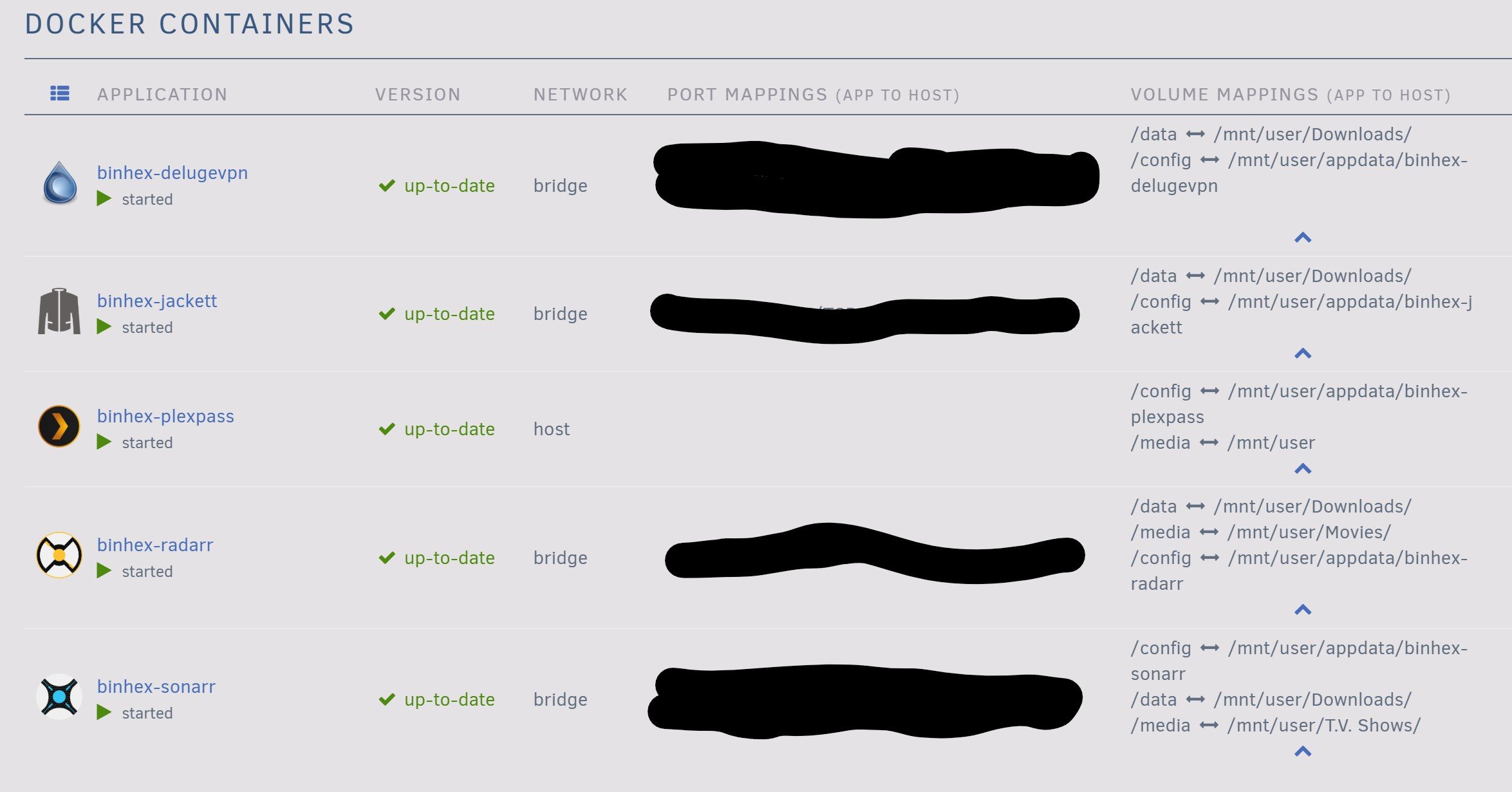

Let me start by saying, I don't believe I am having and issues with my setup; everything seems to be working as it should. This is more for my personal knowledge.
Now, these are probably dumb questions and have probably already been answered but I was unable to find a solid answer from my searches. I am very new to this so please forgive my ignorance....
I have DelugeVPN setup to download "/data/incomplete", once the download completes, it moves to file/folder to "/data/completed". This is working flawlessly.
I have the Sonarr container path: /media set to "/mnt/user/T.V. Shows/" and the container path: /data set to "/mnt/user/Downloads/".
I have Radarr set up similarly; container path: /media set to "/mnt/user/Movies/" and the container path: /data set to "/mnt/user/Downloads/".
I set Sonarr to download a TV Show, it went into Deluge as it should have. When it began downloading it was in the "incomplete" folder. When it finished downloading, it was moved to the "completed" folder. I then looked in my T.V. Shows folder and found the new folder with the individual season folder inside.
I have Sonarr, Radarr, and Jackett setup to fetch the downloads. This is where my confusion sets in. To my understanding, Sonarr and Radarr are supposed to move the downloads from "/data/completed" to the appropriate media folders once Deluge has finished downloading them. As I mentioned, this appears to be happening.
My first question is, how does this magic happen? I guess I'm just confused about the flow of everything.
Second question: after Sonarr moved the download file from the "completed" folder, I now have two copies of the downloaded file. One copy is still in the "completed" folder and the other is in "/mnt/user/T.V. Shows/" folder. Is this because the file is still seeding in Deluge?
Sorry for the long post, I also attached an image of my settings in unraid.
