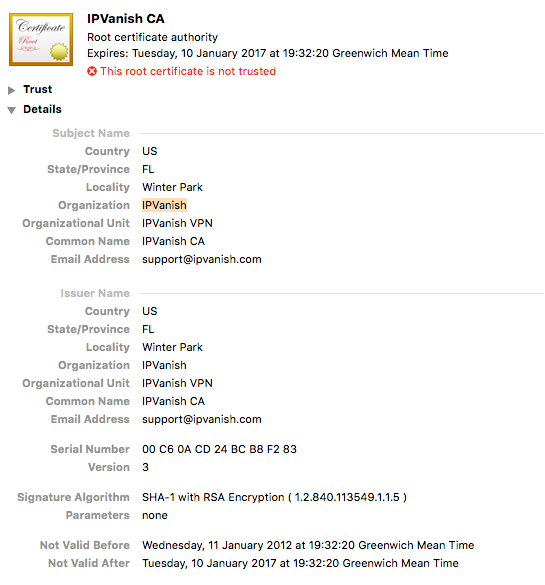

while trying to run this docker I get following error about my certificate that I pulled from their config file site  .. I am using IPVanish ... any help would be appreciated
/C=US/ST=OH/L=Columbus/O=Private Internet Access/CN=Private Internet Access CA/[email protected]
IPVanish will not use a PIA cert to secure the tunnel :-), dunno where you downloaded that from but i would check again, are you setting VPN_PROV to custom, if you have set it to pia then it will auto copy the pia cert to the openvpn sub folder.
I do have it set to custom and i got the vpn cert file from ipvanish config files site http://www.ipvanish.com/software/configs/ ..
Any other ideas?
hmm very odd, so you have this file in /config/openvpn/:-
http://www.ipvanish.com/software/configs/ca.ipvanish.com.crt
is that correct?, looking at that cert it isnt from PIA (see attachment), im pretty sure the crt file you have in /config/openvpn/ is not the one from the above url, can you double check please, also just ensure there is only a single crt file in there, it could be picking up the PIA cert in there if you previously had it set to pia before switching to custom.
edit - keep in mind ipvanish does NOT support incoming ports (port forwarding), so using ipvanish for torrents is going to be slow at best (https://support.ipvanish.com/customer/portal/articles/1969161-port-forwarding)
