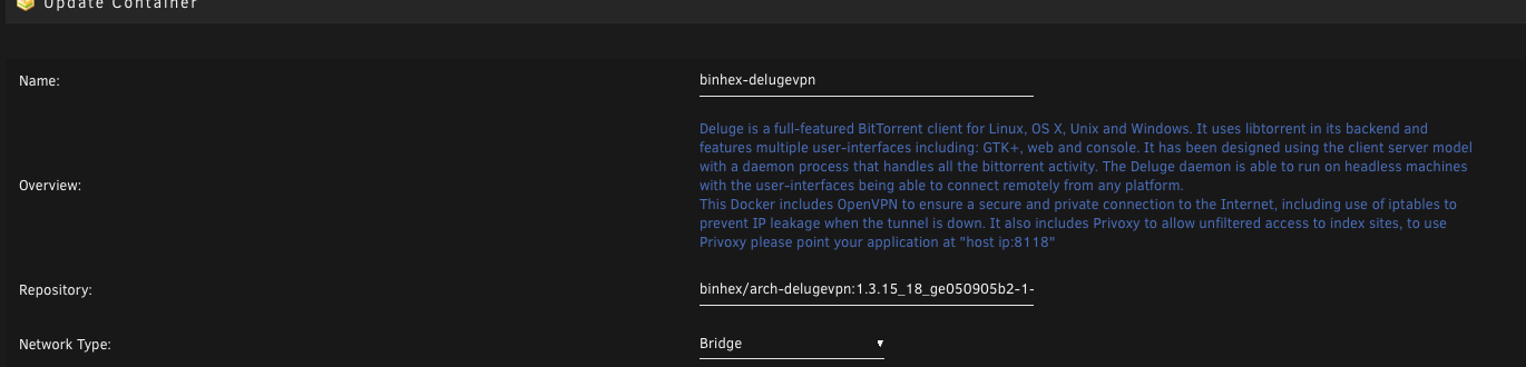

I have this docker installed via Community Applications.  Can someone explain how to rollback?  Will I have to uninstall from CA and install that release manually?
You just need to edit the docker to include the entire version number in the repository field.
@wgstarks, thanks!  That worked like a charm.

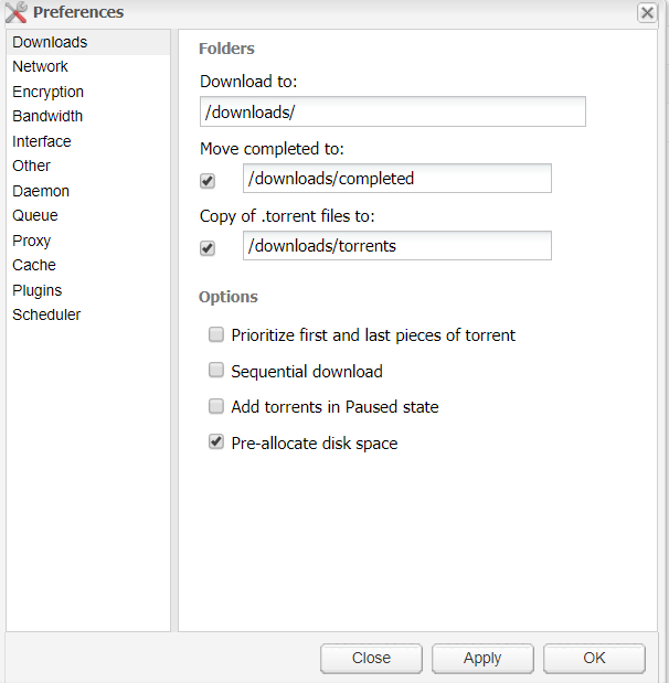

Having some issues with getting files downloaded.
Seems like its having folder permissions??
its showing free allocated space on the bottom right of deluge. So it seems like its connected to the volume map properly.
PUID and PGID set to 1000 for dockuser and dockgroup
image.png.10f9cb67f1433f8d955ad02d71334028.pngimage.thumb.png.be20a718dc0a0a91360d8a0bb706858f.png
Edited by streetsurfer

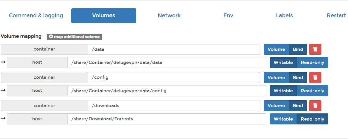

I don't know what system this is, but from your volume mapping screenshot I can see that /share/Download/Torrents is marked as read-only. I would bet that's your issue.
That was super stupid, must have misclicked and the colors werent helping!
THANKS!!!! needed that second look. lol
THe system is using "portainer" docker container manager

For anyone that must use 2.0.3 or older.
The latest release (tagged '2.0.3_23_g5f1eada3e-1-01') shows up as '2.0.4.dev20' (at least for me, in the webGUI). If only '2.0.3' is whitelisted, you may get an error.  I had success rolling back to the November 14th release (tagged 2.0.3-2-01).
To do this, I went to the configuration page for the container. Switched from "basic view' to 'advanced view' in the top right corner. Then under 'Repository', I replaced "binhex/arch-delugevpn" with "binhex/arch-delugevpn:2.0.3-2-01"
DockerHub page
