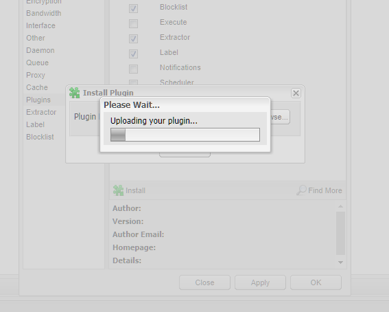

😂 okay I must be doing something wrong here ... I open deluge, I go to preferences select plugins, then choose install, I browse to my download folder and select the .egg file that I downloaded from your link, hit install ... a tiny window pops ups for a fraction of a second and then nothing happens. Could this maybe be a permissions thing where it can't write to the folder? Is there any way I can install this manually?
This window pops up for a fraction of a second
Edited by SiRMarlon
Don't upload the egg.  Copy it into the plugins folder in your App Data.  Then open the core.conf file and add it in to the "Plugins enabled" section.  That it the best way  The upload feature seems to be broken.
AHHHHH okayyyy ... let me give that a try!
Okay finally got it working! Thanks for the tip!

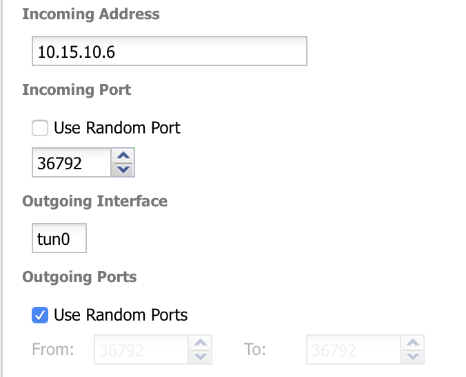

First of all, thanks for the container binhex. It's working great with PIA and port forwarding for the incoming port is working as advertised. However, I was wondering about the outgoing ports. I use a private tracker exclusively, and I'm trying to optimise for upload speeds.
My network settings are in the attached image. Can I use the same port for outgoing traffic as the incoming port? I've tested and confirmed that it is open. Is there a best practice here? Any recommendations is appreciated! Using PIA as mentioned through their Swiss server.
no, and there is no reason to, all outgoing ports will be open, but if you really feel the need to, or your private torrent site is insanely restrictive then feel free to set the outgoing port to whatever you want, just dont use a port thats already in use, most people will NOT need to do this and it will make zero difference to dl/ul speed.
Edited by binhex
Thank you for the explanation! Will leave it as is then.

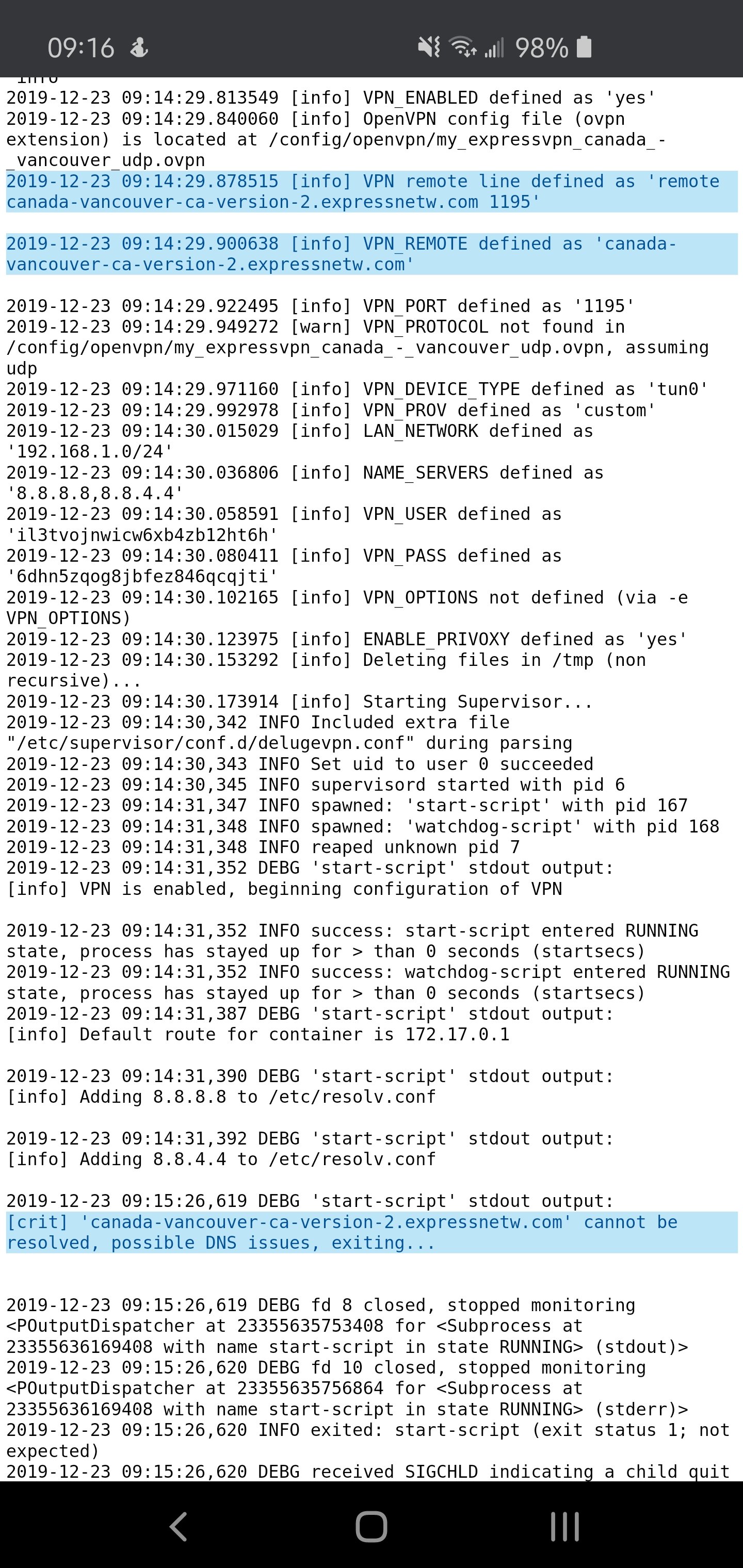

Having an issue after the update as well.  I can't access the GUI and the proxy isn't working.  Looks to be a DNS error with the VPN.  I've removed all the DNS servers that were there before and am only using Google DNS.  Everything worked fine before the update.
Edited by Xcelsior86
dunno where you got that ovpn config file from, but the endpoint (as specified via the remote line) does not exist, thus the dns failure, check your vpn provider for a updated ovpn file.
