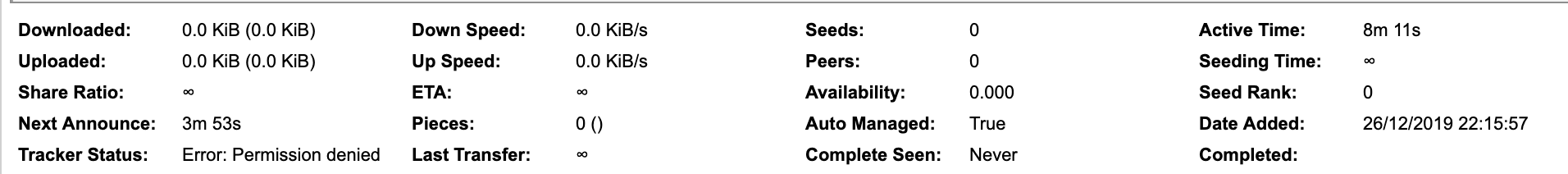

So it 'was' working. and i can get to the webui so my VPN must be working ok (nordvpn, couldn't make it work with ghostvpn). Now whenver I add a torrent I get no connection and in the tracker status: error: Permission denied
Any suggestions?
Any suggestions?
was having this issue on a fresh setup, after a couple hours of changing settings I forced an older version of the docker container, that seems to be working. I'm just resetting all settings and starting from scratch with this version now,
I couldn't ping anything inside the docker container with :latest
change repository in advanced settings to binhex/arch-delugevpn:2.0.3-2-01
edit: recreated and now it won't ping anything again :)
edit2: switched ovpn config to udp, seems to be ok now
Edited by chrismts
