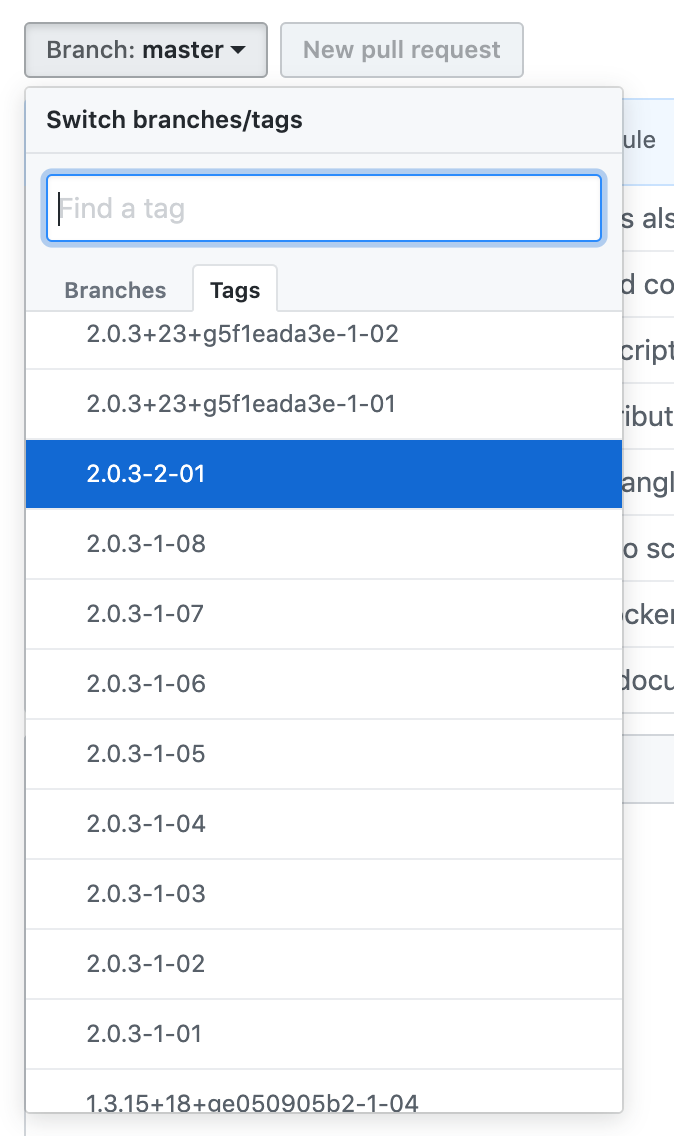

Looking back in the thread.. it appears to be an issue with the latest update.
Tried inititally turning off just the Privoxy but no go. Torrents sat at 0 download.
Used the earlier suggestion to roll back the update and it worked for me:
Repository: binhex/arch-delugevpn:2.0.3_23_g5f1eada3e-1-03
Edited by Supa

Hi guys, I experienced a few issues with this docker myself over the last week or so. For me the issues seemed a little sporadic. Like a file/error/lock with the VPN config was getting generated on start, blocking the web UI then after a few reboots clearing and allowing the Web UI to start again.
I resolved my issues by pointing at an old docker image (binhex/arch-delugevpn:2.0.3-2-01 -- which may be a red herring and might be simply just refreshing the image.) and then deleting my openvpn config from the container's openvpn folder and then re-pasting the config and restarting the container.
Your mileage may vary.  This is merely what worked for me and i can't elaborate on why this has helped.

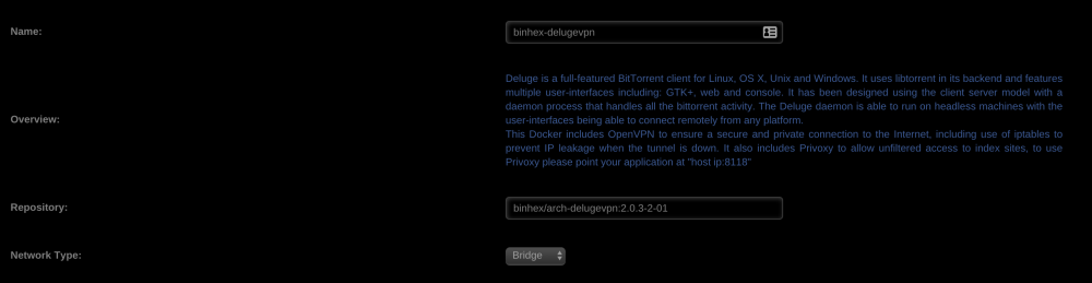

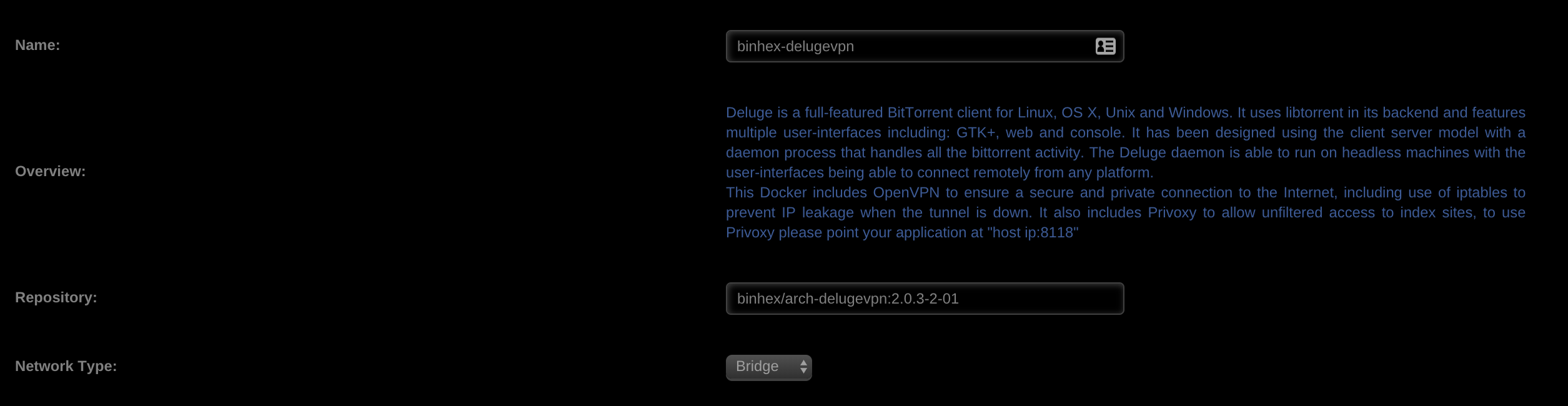

Initially I had it set to Repository: binhex/arch-delugevpn:2.0.3_23_g5f1eada3e-1-03 but it broke today.
Set it to binhex/arch-delugevpn:2.0.3-2-01 and it started downloading again.
Edited by Supa

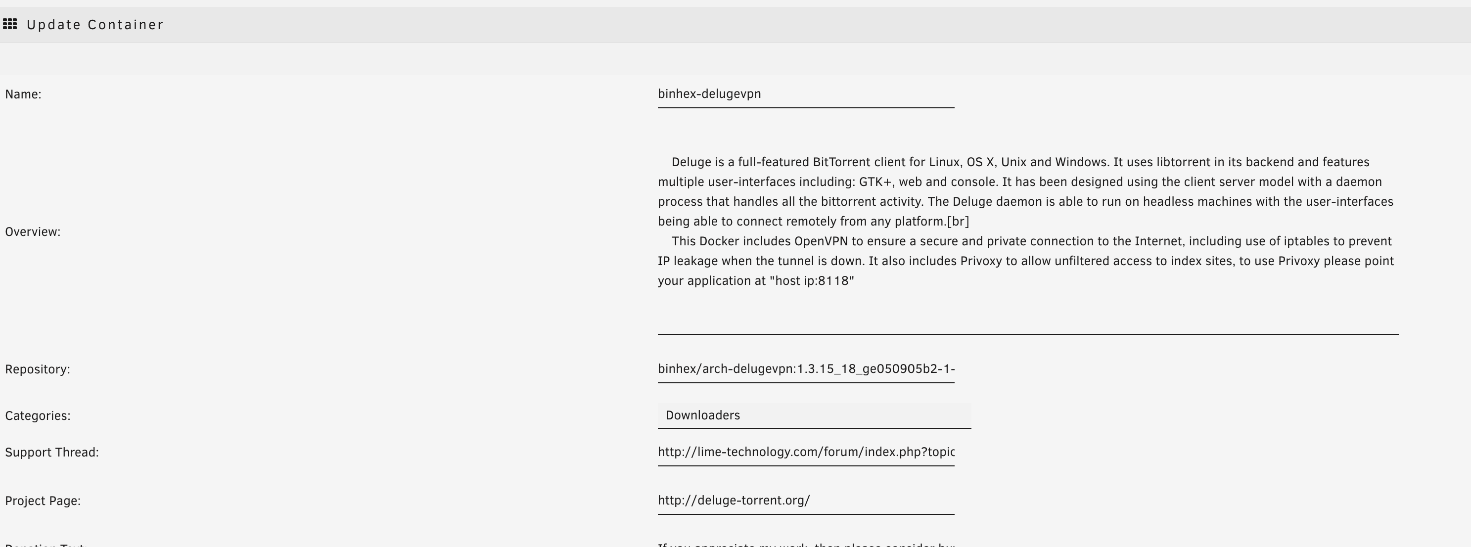

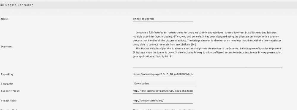

I've been using 1.3.15_18_ge050905b2-1-04 successfully for the last month or so.  Today I swapped out my cable between the wall port and my switch, and upon plugging it back in, Deluge wouldn't reconnect.
I tried restarting the docker, and it is giving me the following error in the logs.

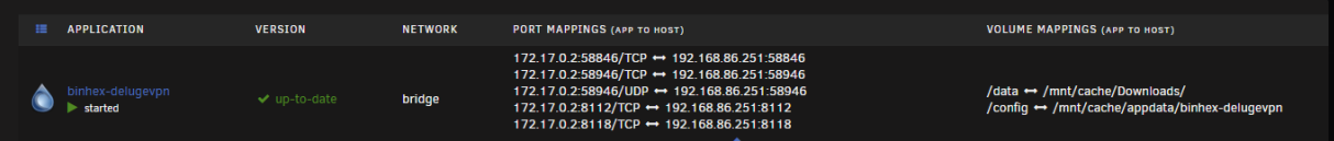

Hello the container is running on my synology nas I can connect to the webui.
It downloads I don't know yet if it uploads but it doesnt save the downloaded files in the folder from the "volume1/downloads/Deluge/Downloads". (mounted /data).
Should I add something on the webclient settings to get it working ?

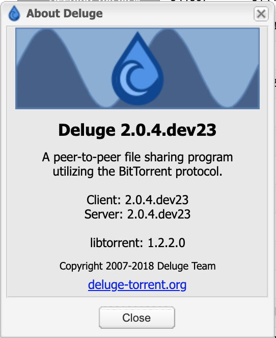

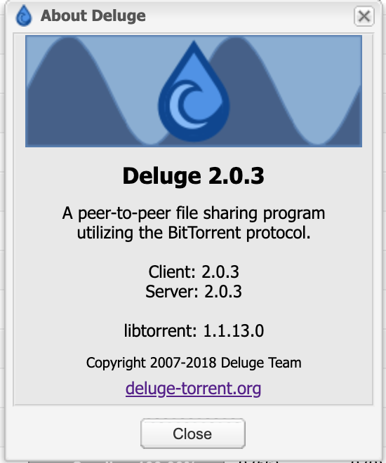

Is there a reason why a dev build of Deluge is packaged in this docker?
One of my trackers wont accept dev builds of deluge, and only support up to the official latest release (2.0.3). Is there any way I can downgrade the version or do I need to wait till 2.0.4 is an official release?
Thanks in advance.

Go into the Container and under Repository change the version. This is mine
Thank you. This really helped. I've managed to successfully downgrade. Just re-checking all my torrents now. This might take a while!
If anyone else need to do this. The extra string at the end of Bugster's Repo name is a git tag. You can find the right one by going to the binhex-delugeVPN github page:
https://github.com/binhex/arch-delugevpn
Then change the tag to whatever Deluge version you want:
Then just stop your container and add that string to the end of your repo (with a colon) and hit apply.
What link do I need to select on the github page to see a list of the versions?
