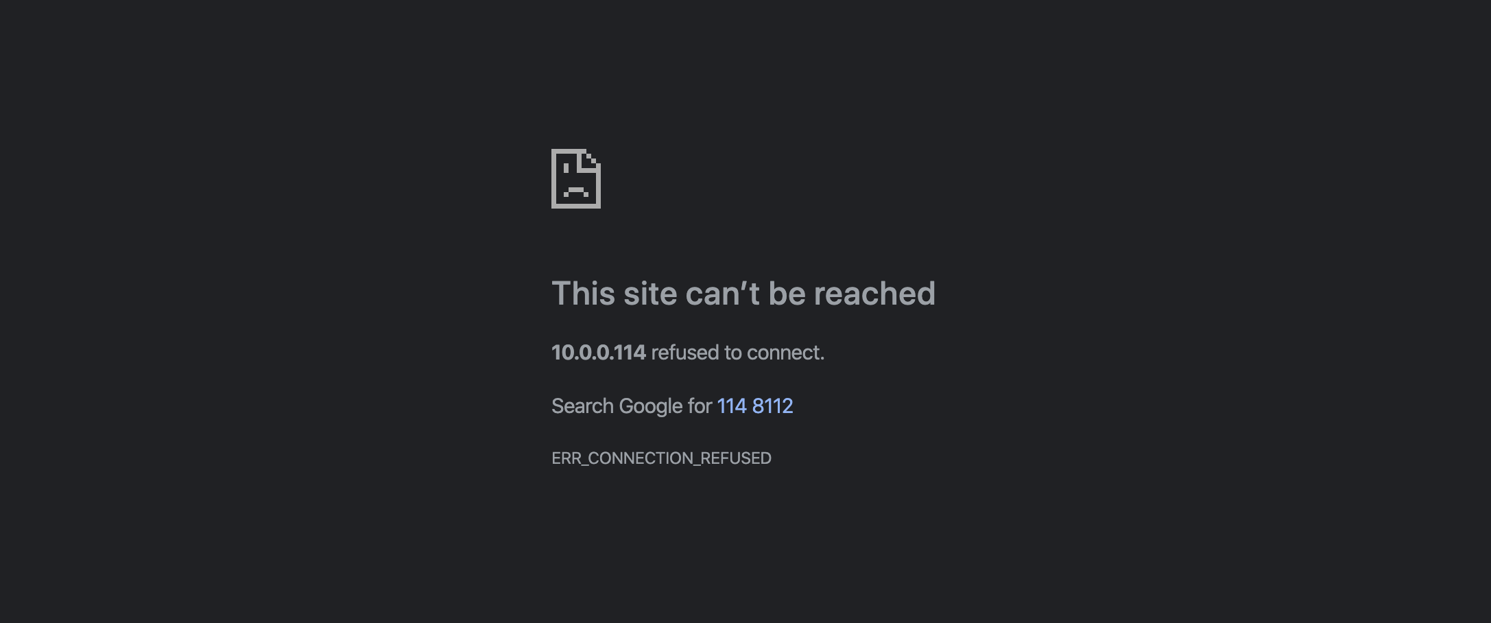

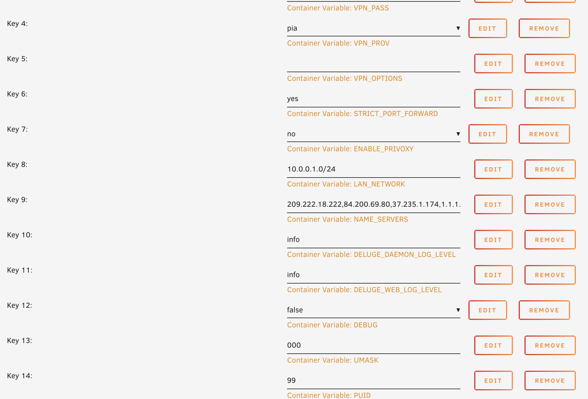

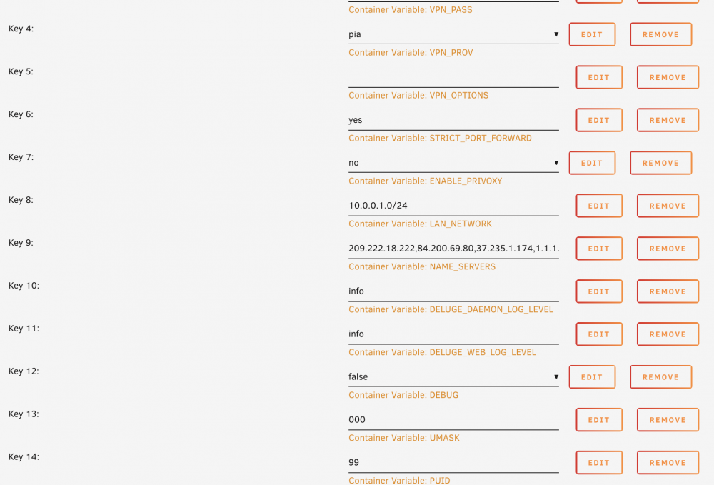

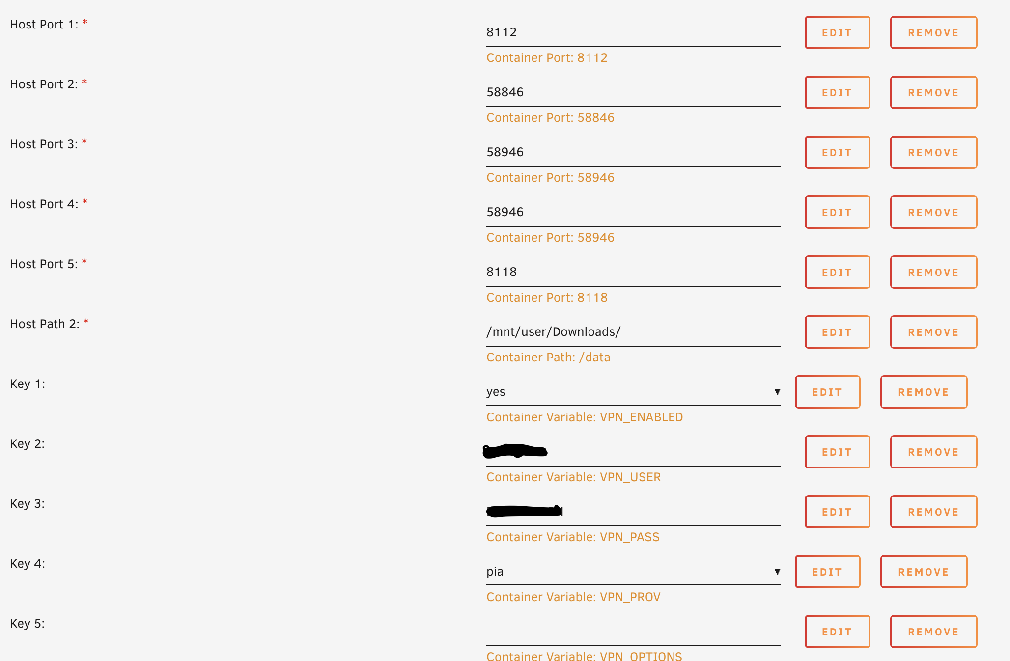

Hello Binhex and Team
I just started using Unraid. I only have 1 docker and it is yours but it just does not want to work. I followed space invaders videos to a T with no luck.  please help!!!
