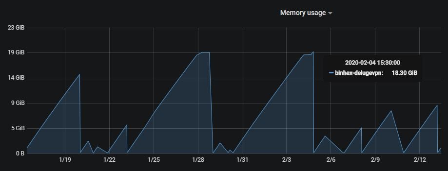

Does anyone else suffer from ballooning memory usage on this container? Eventually it bricks my server.
I'm running: binhex/arch-delugevpn:2.0.3-2-01
