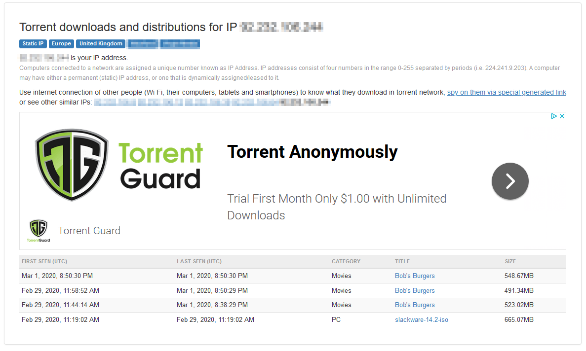

29 minutes ago, binhex said:
so let me confirm firstly, you are running this docker container with vpn_enabled set to yes right?, and its using airvpn config?, and as well as that you also have set deluge to use a socks5 proxy from TorGuard as a belts and braces type approach, have i got this correct?.
Yes sir,
Just trying to add enough to  make sure if something breaks down I'm covered.
I use the Docker with AirVPN enabled and a TorGuard Socks5 Proxy  - you have that correct.
-Usual-Noob

32 minutes ago, Usual-Noob said:
Yes sir,
-Usual-Noob
if you want to check for ip leakage the only way is to packet capture using something like tcpdump on the host and then load the capture file in a packet capture analyser, link wireshark and check for any leakage. i have done this myself a few times to ensure zero leakage and can confirm no leakage reported, but feel free to check yourself (sorry no guidance on how to do this you will have to google).
for a quick test, docker exec into the running container and kill the openvpn process, this will force the tunnel down, then check speeds drop to 0.

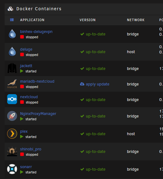

On 2/17/2020 at 10:40 AM, vvolfpack said:
Edit 1: After a reboot, the command passes successfully, but I'm unable to start the docker. After clicking "Start". It spins for a second and returns to "Stopped" state. Any help would be much appreciated!
EDIT 2:
Getting these syslogs from trying to start the application
Feb 18 23:02:14 vvolfbox kernel: docker0: port 5(veth72bc119) entered blocking state
Feb 18 23:02:14 vvolfbox kernel: docker0: port 5(veth72bc119) entered disabled state
Feb 18 23:02:14 vvolfbox kernel: device veth72bc119 entered promiscuous mode
Feb 18 23:02:14 vvolfbox kernel: IPv6: ADDRCONF(NETDEV_UP): veth72bc119: link is not ready
Feb 18 23:02:14 vvolfbox kernel: docker0: port 5(veth72bc119) entered forwarding state
Feb 18 23:02:14 vvolfbox kernel: eth0: renamed from veth7da683a
Feb 18 23:02:14 vvolfbox kernel: IPv6: ADDRCONF(NETDEV_CHANGE): veth72bc119: link becomes ready
Feb 18 23:02:15 vvolfbox kernel: docker0: port 5(veth72bc119) entered disabled state
Feb 18 23:02:15 vvolfbox kernel: veth7da683a: renamed from eth0
Feb 18 23:02:15 vvolfbox kernel: device veth72bc119 left promiscuous mode
Any help would be much appreciated, @binhex!

Hi... I have looked through this support thread, but cant see anything which answers this... but apologies if this has been asked and I have missed it!
I am new to using torrent downloaders and decided to use delugevpn because of the integration with PIA... so, I followed SpaceInvaderOne's tutorial and every time it installed when I go to the WebUI I get a page cannot be found error. But, I found that if I changed the VPN provider option from PIA to custom, it loaded the WebUI and seems to work. Apart from this, there were no problems setting it up (Thanks*).
So, to begin with I wanted to check it was using the VPN before I downloaded anything, so I went into the docker and used the curl https://ipinfo.io/ip command and it shows an IP address which is not mine... so I assumed all was working OK. I set it downloading some cartoons for my kids and left it overnight.
This morning I decided to take a look at https://iknowwhatyoudownload.com and was shocked to see that all my downloads from last night are visible against my IP... so, I have immediately stopped the docker till I can get to the bottom of this...
Can anyone advise what is going on and why it seems to not tunneling through the VPN?
please do the procedure in the link below:-

27 minutes ago, binhex said:
hmm ok that looks fine, are you by any chance using 'CA Appdata Backup / Restore v2' plugin?, if so have you set it to pause this docker container during backup of metadata?
btw the reason you had to use custom and not pia is because you were trying to force port forwarding whilst being connected to a endpoint that doesnt support port forwarding, but this has nothing to do with ip leakage.
No, the only other dockers I am running that are active are jackett, NginxProxyManager, plex and sonarr.
I did originally set-up using nl.privateinternetaccess.com, but quicly realised that it doesn't support port forwarding now so changed to frankfurt-de.privateinternetaccess.com - I must admit that I thought I'd re-created the docker using this one... but maybe I haven't - so what you're saying about the endpoint not supporting port-forwarding may be right.
Here is a screen shot of my dockers... all the stopped ones are actually not used now and are just there in case I decide to re-instate them;
Let me know what else you would like me to check...
ca backup is a plugin not a docker container, check the plugins section of the unraid web ui and verify its not installed, or at least not set to pause and resume.
so i see you have deluge and delugevpn installed, are you 100% sure you were connected to the right deluge instance and didnt send the torrents to the deluge container not delugevpn?.
just to confirm i have zero entries when looking at https://iknowwhatyoudownload.com and i have been downloading linux iso's for a long time (years).
