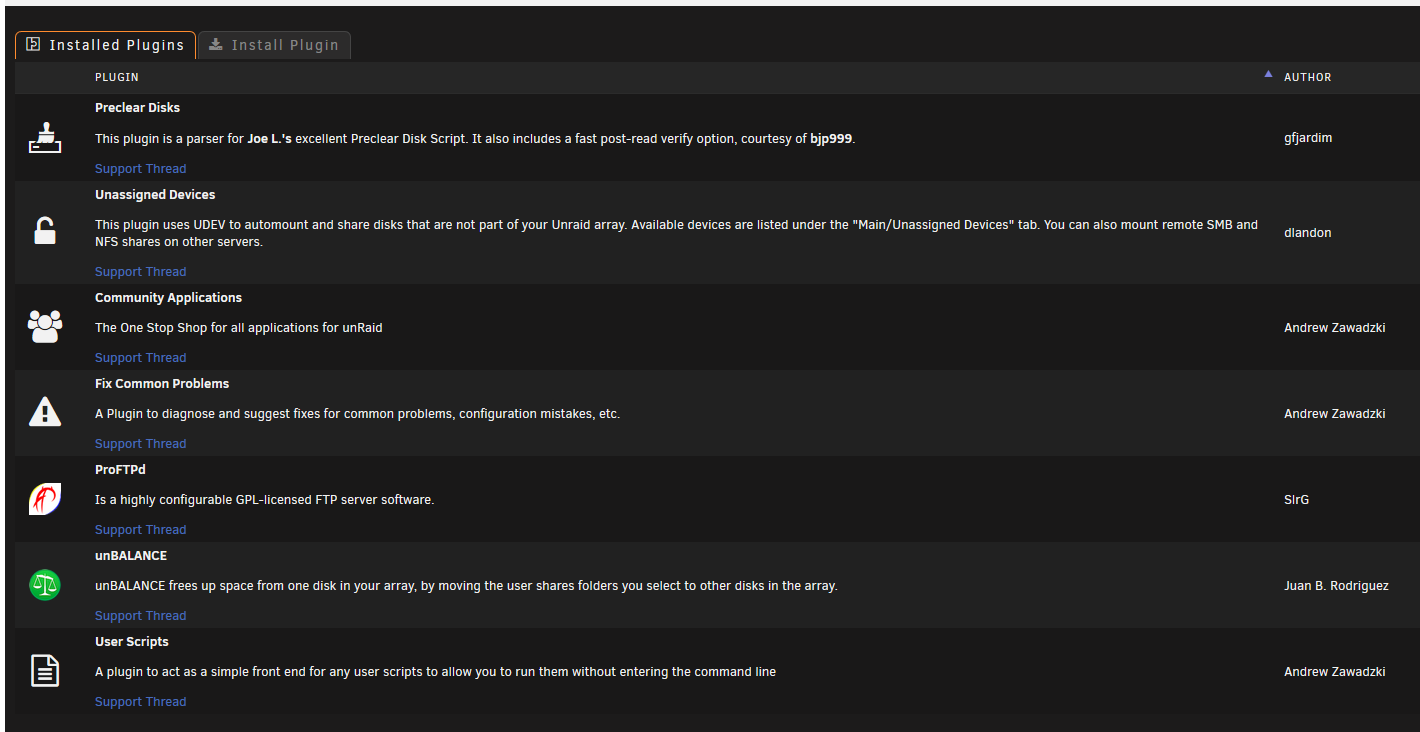

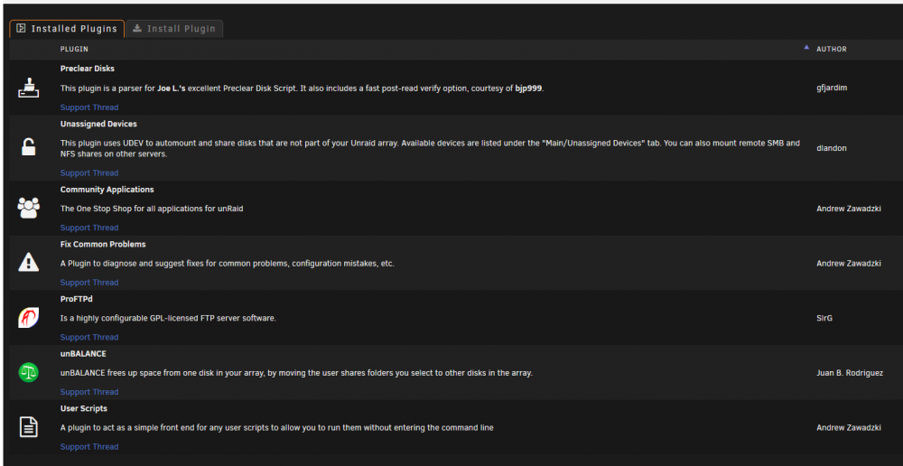

ca backup is a plugin not a docker container, check the plugins section of the unraid web ui and verify its not installed, or at least not set to pause and resume.
so i see you have deluge and delugevpn installed, are you 100% sure you were connected to the right deluge instance and didnt send the torrents to the deluge container not delugevpn?.
just to confirm i have zero entries when looking at https://iknowwhatyoudownload.com and i have been downloading linux iso's for a long time (years).
Apologies... you did say plugin, but either way its not installed for sure;
I was definitely using delugeVPN as the other docker was the first one I created with the plan of routing it to PIA via my router (Draytek 2860N), but I had problems with port forwarding and had zero traffic doing it this way, then I found yours with the VPN element integrated already.
If you think all looks good I can delete the docker, and the folder from appdata - re-install it from scratch using de.privateinternetaccess.com endpoint from the start so I can use the pia profile... then try downloading some legal Linux ISOs to see if they appear at  https://iknowwhatyoudownload.com
