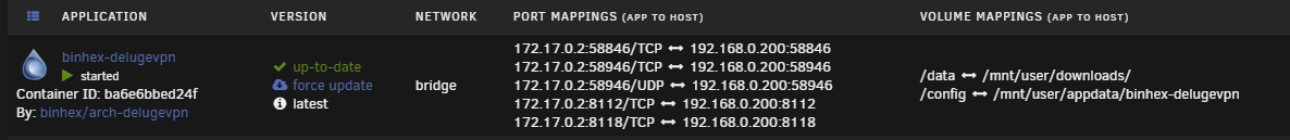

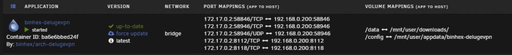

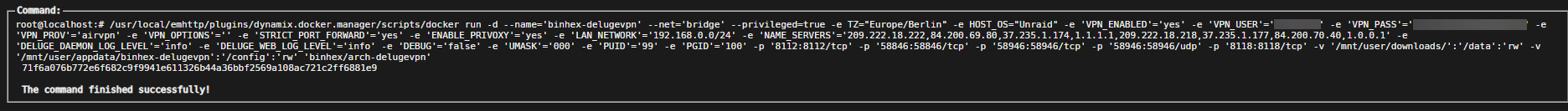

Hi.
I seem to have the exact same issues as SiRMarlon, running AirVPN though. I seem to have to restart the delugeVPN docker more frequently every two days or so.
Have you been able to find a solution yet?
Thank you.
*Edit: attached screenshots (sorry for not posting that to begin with)
Edited by FlamingoDaBird
adding screenshots

 Not sure if you have the option to switch your VPN location but I moved to a different server and Deluge seems to be working without me having to restart. Still have the issue where the Torrents won't clear on their own.
